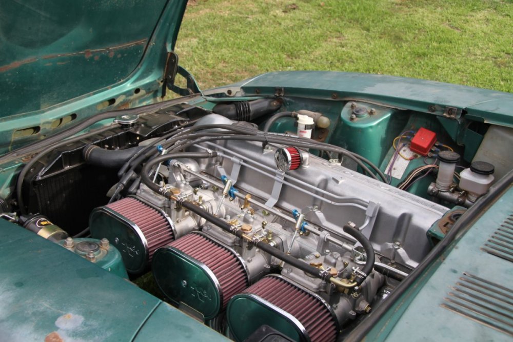

Roady Posted December 15, 2020 Posted December 15, 2020 (edited) There are 3 holes, 1 input, 2 output. I use one output to Weber’s the other attached to a pressure gauge. You could possibly use the second as a return line. Not sure if the smaller diameter of the return line would create enough of a pressure differential to feed the carbies. Alternatively, have the return line from the end of the Weber’s if you so choose?? Edited December 15, 2020 by Roady Quote
RLY240 Posted December 15, 2020 Posted December 15, 2020 51 minutes ago, Therambleman said: Thanks for the reply - yeah I’m wondering if there’s a regulator like that - but operates at that low psi AND also has a return. Perhaps it’s not a thing?? I used to run this reg with the factory fuel rail, reg in line before the carbs, one feed into carb one and the other feed into carb three with all three carbs linked together and the factory Return line back to the tank. seemed to work fine but you might be able to fine a proper bypass reg at that low a pressure but I haven’t seen one. Quote

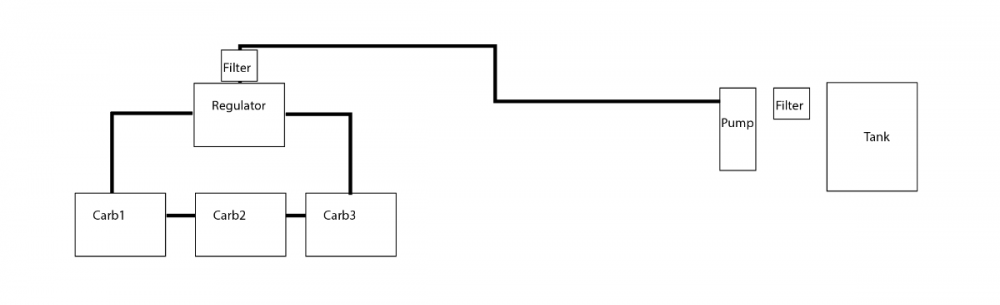

RLY240 Posted December 16, 2020 Posted December 16, 2020 (edited) Quote: The factory fuel rail has the return built into it. yes this. The factory hard line has a restrictor in the return line. If you don’t use a bypass reg you need to put it before the carbs in the circuit as you have in your diagram Roger Edited December 16, 2020 by RLY240 Quote
