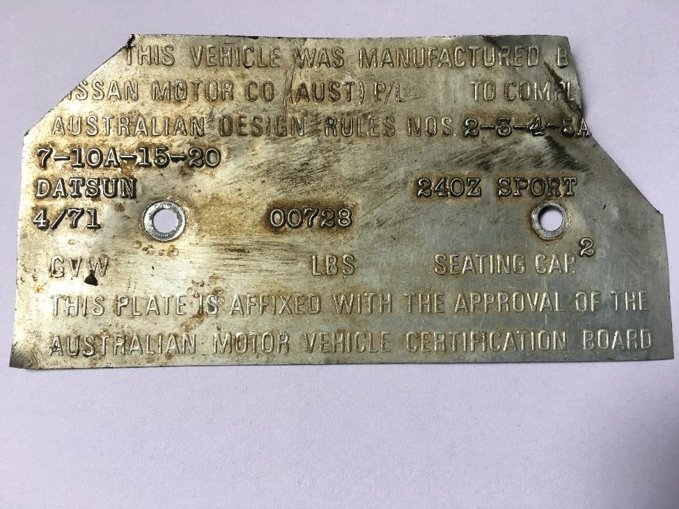

KatoKid Posted September 11, 2017 Posted September 11, 2017 Digging this up again as I realized that I would need to attach my compliance plate for VASS and registration so I dug my plates out and when I looked closer realized that the plate actually lists the ADR's the car was to built to comply with......and it does not list ADR 14 which is specific to the second edition ADR's for mirrors! Very pleased to find this, as in my book it clearly means that my car does not need to have mirrors as defined by the ADR. Quote

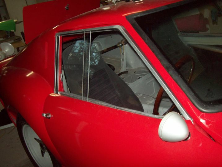

PeterAllen Posted September 11, 2017 Posted September 11, 2017 I fitted a couple of Raydyot bullet mirrors to the GTO to give it the period look. I found I could see bugger-all via the passenger door mirror so I fitted one of these and hey presto, I can now change lanes like a 'P' plater. http://www.ebay.com.au/itm/Convex-Mirror-95mm-3-/261818493373?hash=item3cf59929bd:g:EOEAAOSwoBtW2RSx Quote
KatoKid Posted September 11, 2017 Posted September 11, 2017 Thanks Peter. A few others have commented that convex is the way to go. Quote
