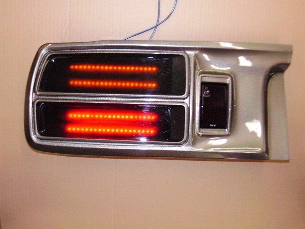

well since one of the reasons for wanting (not minding) a 260z over a 240z was so i could play with the tail lights (as 240z ones are that sexy they dont need any improvement...but 260z ones leave something to be desired) i've been looking for a set of skyline rear lights to fabricate in, i was going to get a set of r33 ones and then put the indicator and reverse light up around the edge of the panel, mazerati style, but then i came across some 4 door series 2 ones, which i had never really seen before and decided to give them a shot, i was thinking of doing r32 lights as its already been done but these have the indicator and reverse light in the bit between the lights and that bits a nicer shape, plus they stick out ferrari style :twisted: so i thought it'd b more interesting...and many thanks to sulio as i have his old lights in my car while i play around with my panel.
i now pretty much have it all ready to be glued all together properally and make it look pretty...which hopefully isn't the longest part, but either way it wont happen for awhile due to work around christmas. i'm just going to use balsa wood so i dont have to spend ages making fibreglass flat and i think it should do the job alright, but if you think this is a bad idea please let me know!
i'm going to have to cut the panel behind the rear lights in order to fit the lights in as i can't cut them any smaller (they are way smaller than they used to be), how should i do this? just a hack saw? and also are the holes on 240z's and some 260z's larger? as sulio i can't see from images how 240z lights would fit through the holes in my 260z, is this one of the things thats different from the early 260's to the later ones? or are my eyes playing tricks on me? if it is larger can someone tell me the width of the hole? i dont really want to cut into my car if i'm going to sell it soon, but if i do cut into it then i'll cut the fenders and get the flares, i'll wait to see how these panels turn out, please excuse the dodgy photoshop but i couldnt be bothered doing it better!

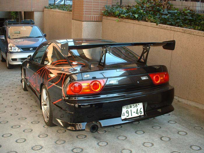

yeah, is that a bad thing? hehe a few of my mates have said that too, that the lights look a bit like those 180sx ones, i've seen one 180sx in boxhill (naturally) with r32 lights, on a side topic 180's sure look like newer 240's...i like the angle around the numberplate, otherwise i woudln't have bothered doing it though hehe, would look nice with an exhuast setup similar to the sr240z car below it too
You sure that 180sx with 'R32' lights wasn't just a type x? Late model 180sx's (about '95-'96?) have round tail lights, and are badged type x..... And yes, 180sx's defintely have throwback lines to a zed.

yeah i'm sure the 180 i saw that one time had r32 lights in it, but yeah it seems kinda pointless when there's those type x ones (i never knew the name but knew they were on the newer 180's)

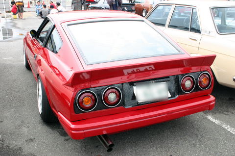

is this the car you were talking about sulio? in some pics its carbon fibre, but if i had one bit carbon fibre i'd want the flares bonnet and spoilers to be too hehe

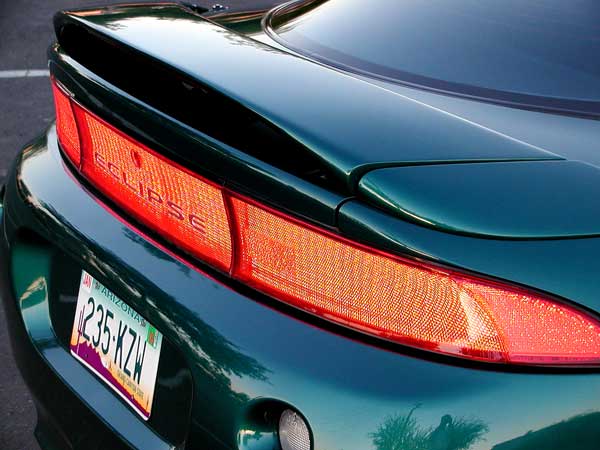

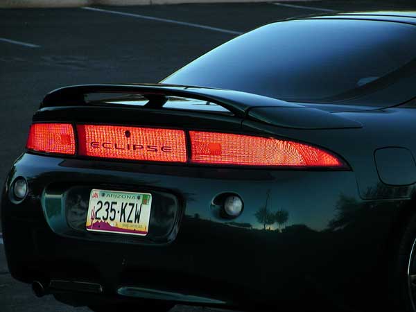

regarding the led tail lights for it to look nice you have to set up the array and fill the whole lense imho, there's a guy in america who's got an eclipse and his rear lights are nuts, i'll try to find a pic later on
i just found some pics of the guys eclipse. there's some videos of it too, he has little segments strobe in the order of the direction he's turning and stuff like that, not sure if its legal...lol, but i dont get americas indicators, but i havn't ever really tried
