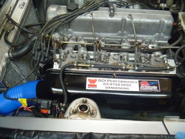

AndBir Posted August 6, 2019 Posted August 6, 2019 3 hours ago, gav240z said: Shame nobody makes a really suitable product that bolts on nicely Thought this may work but maybe only for Webers/Dellorto? : http://www.bitsofitaly.com/cold-air-box-intake peter t 1 Quote
peter t Posted August 9, 2019 Author Posted August 9, 2019 On 8/6/2019 at 7:23 PM, AndBir said: Thought this may work but maybe only for Webers/Dellorto? : http://www.bitsofitaly.com/cold-air-box-intake Yep going to place an order for one of these. Quote

peter t Posted August 14, 2019 Author Posted August 14, 2019 On 8/9/2019 at 6:24 PM, peter t said: Yep going to place an order for one of these. Advertised for $630 BUT add on all the extras and it becomes $1043. Buggar. Quote
Administrators gav240z Posted August 14, 2019 Administrators Posted August 14, 2019 10 minutes ago, peter t said: Advertised for $630 BUT add on all the extras and it becomes $1043. Buggar. Did you call them? Might be worth a shot, sometimes the websites for these small businesses are not exactly set up right. I'd call them and check what they can do for you? Quote
Administrators gav240z Posted August 14, 2019 Administrators Posted August 14, 2019 Maybe also have a read of this thread. Quote
peter t Posted August 14, 2019 Author Posted August 14, 2019 3 hours ago, gav240z said: Did you call them? Might be worth a shot, sometimes the websites for these small businesses are not exactly set up right. I'd call them and check what they can do for you? Email Gav, the reply to my asking. $630 is for the outer piece then you have to buy the adapoter plate then all the other bits. Quote
