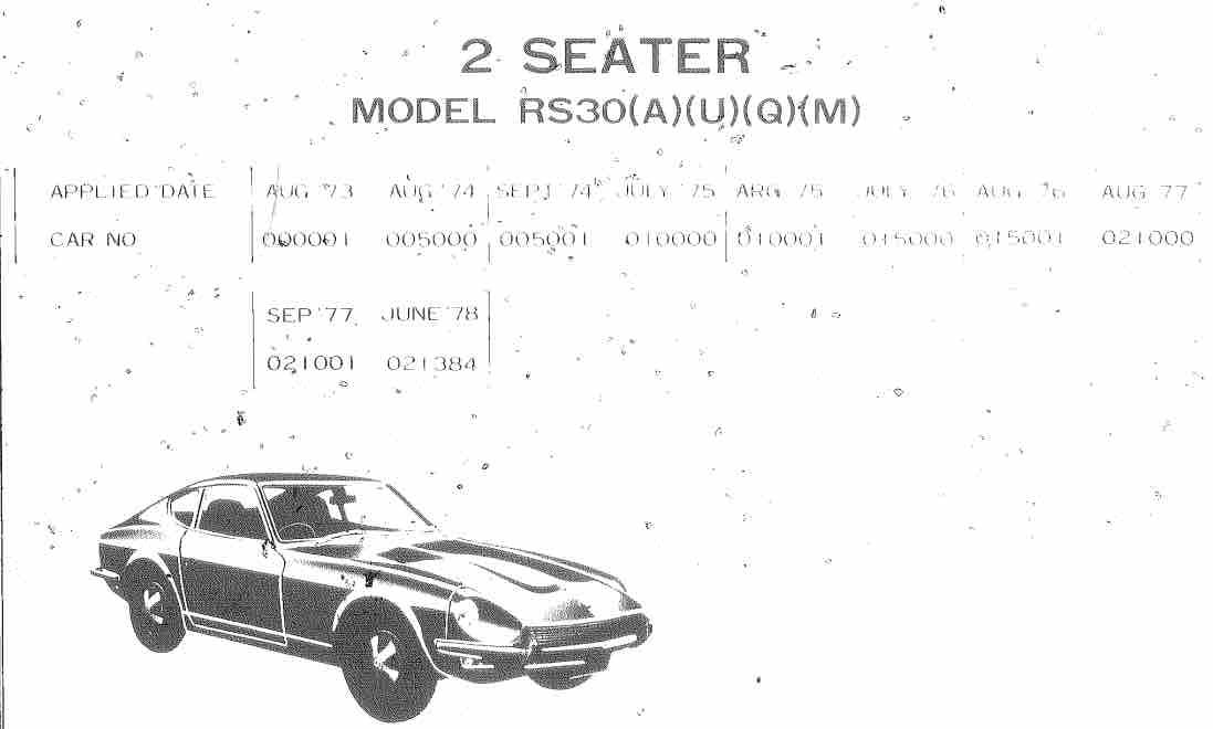

 I'm attaching a page from the Australian market parts manual.  The manual is available to donating members (nudge nudge *wink* *wink*) here.
From the chart it shows
RS30-015008 would fall in the July/August 76 build date range.
July 76 = 15000
Aug 76 = 15001
Aug 77 = 021000
Sep 77 = 021001
It seems weird to me that the range only indicates 1 car built in the months of July/August 76 and Aug / Sep 77... but maybe there was a tooling change over and focus on other markets during those periods of time? I know RS30 production was low compared with HS30s, since 2+2s were out selling the 2 seaters at the time.
@HS30-H do you have any idea why they would bother to list a range for 1 car in the manual like this?
Actually perhaps I'm over thinking it or looking at it wrong.
 Aug 75 010001 - Jul 76 15000 so anything between those ranges was built between August 75 and July 76 and specification wise should be the same.
In August 76 there was a set of changes beginning with 0150001.
So that would make your car part of those August 76+ changes and built probably in August 76 - given it's the 8th car after those changes. Those changes are the things noted like the door latch being different, the fresh air ducts being moved in the front radiator support area and other subtle differences like the typeface on the gauges (was slightly thicker) etc..

July 76 = 15000
Aug 76 = 15001
Aug 77 = 021000
Sep 77 = 021001
Don't overthink this kind of thing. They don't mention days of the month, so it could easily mean 31st July 1976, and 31st August 1977 respectively. It's not a whole month's worth of production in either case, and production wasn't necessarily linear or 'On/Off' switch with either maximum capacity or nothing.
