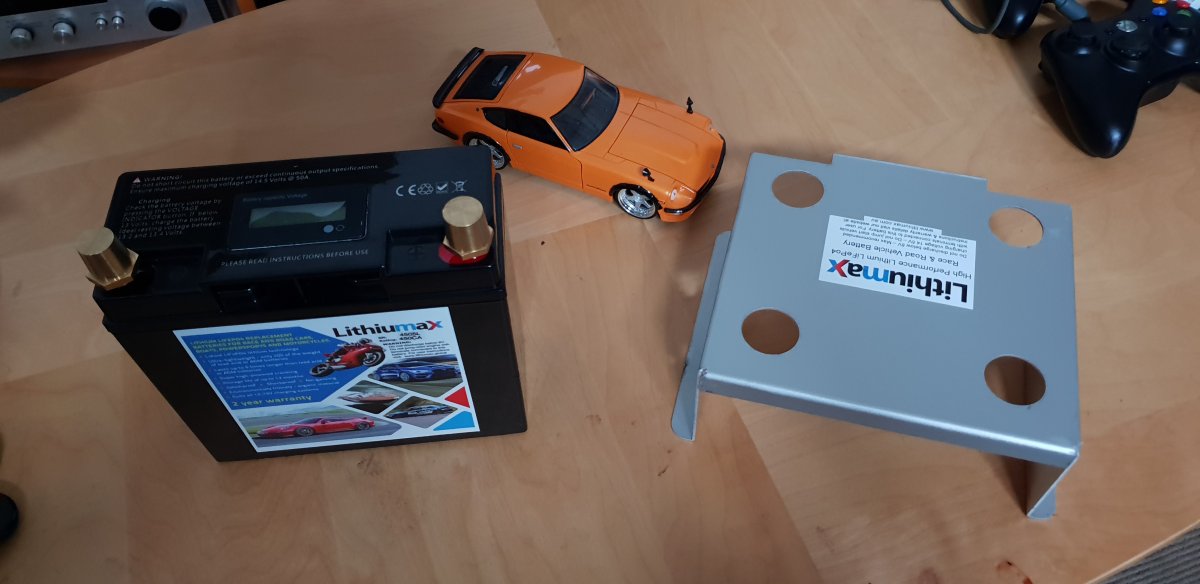

DreamZproject Posted November 14, 2018 Posted November 14, 2018 Wasn't sure to put this in body work or electrical, so I put it here. I just picked up a lovely new LiFePO4 starter battery that comes with a battery mount. I want to possibly riv nut the thing on to the firewall within the space of the existing battery tray, but was just wondering if there were any issues or methods for rivnutting into the firewall... (Do I need to put any paint to protect the exposed newly drilled metal, use the alloy or steel rivnut etc.) Quote

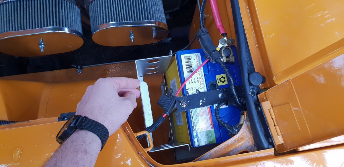

aircobra Posted November 15, 2018 Posted November 15, 2018 i have a thick piece of rubber jammed in there. original photos are not clear on the polarity for the RHD cars yeah, its pretty crap like that Quote

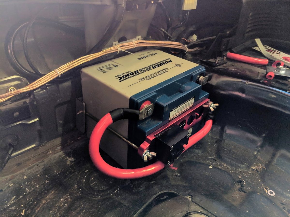

d3c0y Posted November 20, 2018 Posted November 20, 2018 If it gives you any encouragement I just did a similar thing to my relocated battery in my Rx7. I just used an eBay clamp, rods and some aluminium brackets I made up, secured by 4 rivnuts. Quote
