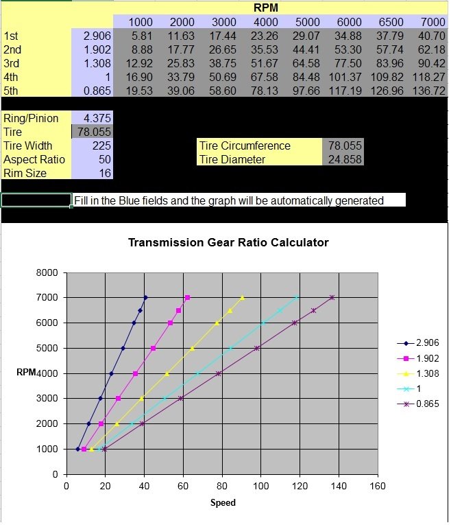

What is your tie size Justin?
I'll input it all into the gear ratio program & see what it spits out.
Posted (edited)
Speed is in MPH.
3.9 (Rev limit set too high - should be 7000rpm)
4.11
4.375 (4.4)

Thanks Lachlan that’s a very cool calculation program I think I’ll stick with my original plan and use one of the 4.11’s I have it’s just that I know where there is a 4.375 diff but probably not worth worrying about as the 4.11 will certainly be an improvement over the standard 260Z ratio.
