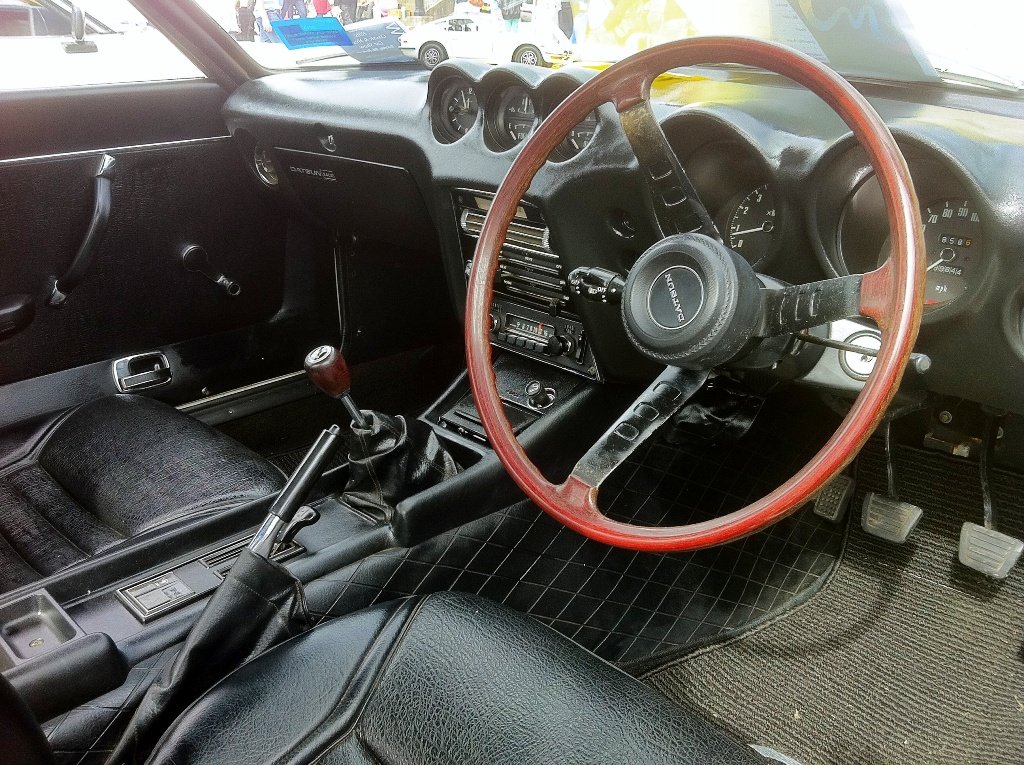

Administrators gav240z Posted August 5, 2018 Administrators Posted August 5, 2018 This thread could get long...there is a lot of differences. Door trims on early girls have 2 additional screws at the bottom (you can just see it here near the pull handle - to the right), photo is from HS30 00084. When I saw these in HS30 00150 I thought someone had installed them - because the trims sag a bit at the bottom. However I've seen it in a few early cars now. So they must be OEM. cracker 1 Quote

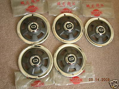

Administrators gav240z Posted August 7, 2018 Administrators Posted August 7, 2018 9 minutes ago, rajon1972 said: " D " hubcaps, 4.5" Topies.. Yep and there is 2 versions of "D" caps. The early and late. Early has less fingers on the rear and the valve hole is aligned with the spokes. Early style Later style. Quote
