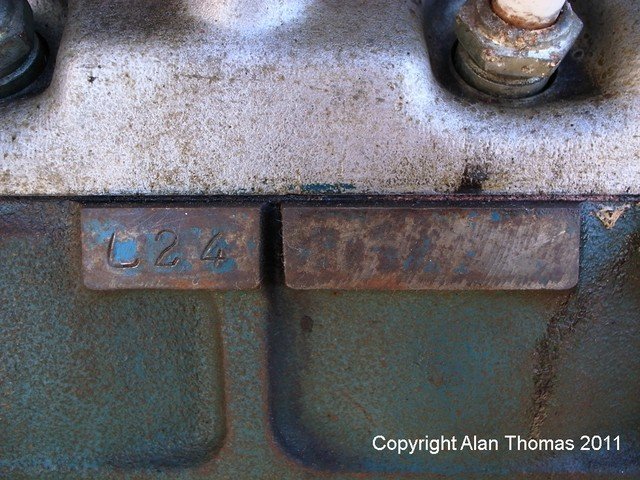

seller claims it is a new crate engine so it has no engine number. P30/E88 combo.
could you buy a new engine from nissan and stamp a engine number on it?
if it is real how much would it be worth?
Is it just me or is the metal lower on the part where the number would be....... aka new engine my bum

I thought the same thing re the metal height.
The L28 I have has the metal for both  the "L28" and the "######" being the same height.
Maybe the L24 was different?
Alan Thomas clarified that spare blocks from Nissan came without a stamp for engine number. So it's definitely NOS.
For reference, a 1971 P30 L24 block supplied as a factory replacement part:
One way to put all this in perspective: Factory replacement engine blocks were components. Engine numbers were only stamped on complete engines that were going into a car.
The guy on Facebook is speculating that he has a "crate motor". It may well have been a complete - or semi-complete 'long block' - replacement supplied by Nissan, but I don't think Nissan supplied complete L24 engines in the American "crate motor" sense. In fact, it may simply have been 're-manufactured' in the USA using an outright factory replacement block and Nissan refurbished head etc.
