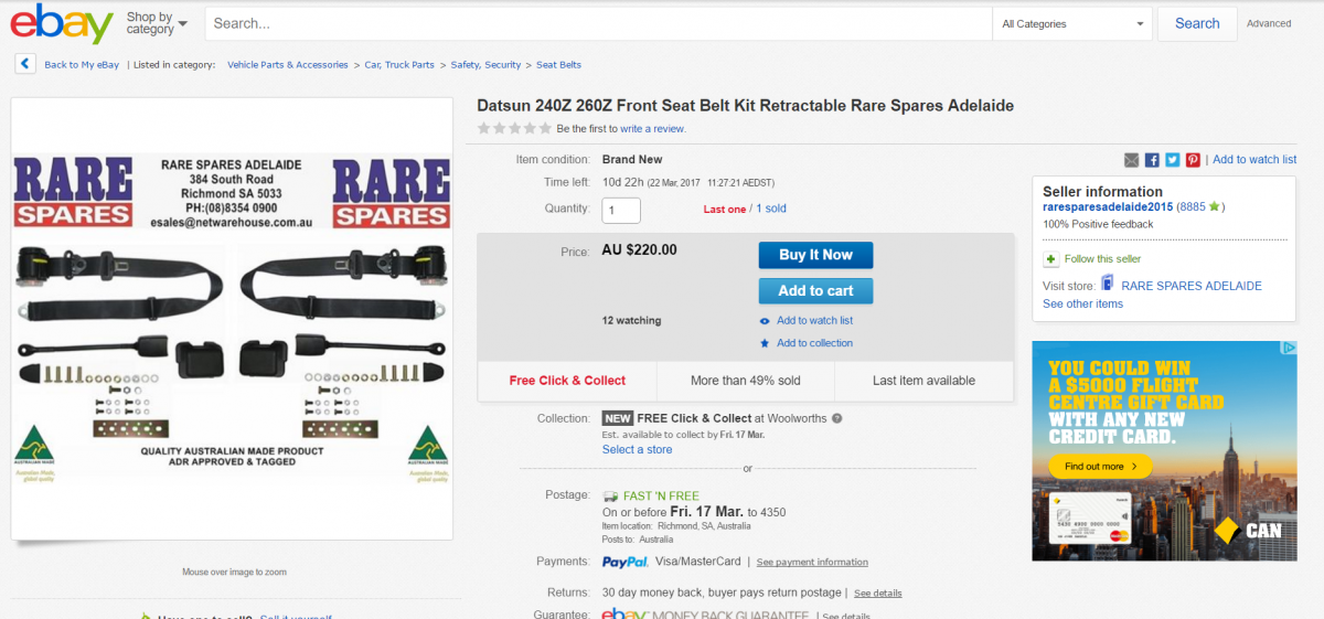

Aaron Neubauer Posted March 11, 2017 Posted March 11, 2017 Hi guys, The seatbelts in my 240Z are a bit tired and I am considering replacing them. I have seen people have used Hemco. I haven't contacted them as yet. I have found a rare spares kit on ebay, has anyone got any feedback on rare spares or have used this kit? http://www.ebay.com.au/itm/232246201378?_trksid=p2055119.m1438.l2649&ssPageName=STRK%3AMEBIDX%3AIT Quote
gilltech Posted March 11, 2017 Posted March 11, 2017 (edited) Ditto same with my '74 260 2-seat. Saw the eBay ones, but I'm going to talk to Seatsafe - their website says they will have a stand at the Cleveland show tomorrow which I'm going to. I want to check my options - like yours mine being built pre-1 Jan 1974 according to ADR 4A I only need fixed belts. However, as fixed belts can be a PITA I want to check how Seatsafe do their retractables option for a 260Z, hoping maybe they have a system without having to install the 4th mounting points within the sills to address ADR 5A requirements for retractors. Worth asking anyway. Edited March 11, 2017 by gilltech Quote
GongZ Posted March 11, 2017 Posted March 11, 2017 ... I have found a rare spares kit on ebay, has anyone got any feedback on rare spares or have used this kit? http://www.ebay.com.au/itm/232246201378?_trksid=p2055119.m1438.l2649&ssPageName=STRK%3AMEBIDX%3AIT I think that the Rare Spares belts are made by APV Safety Products (Campbellfield Victoria - Toll Free: 1800 804 588) Aveska Restoration Parts (in Beverley SA) also sell the APV belts; http://www.ebay.com.au/itm/262832474979?_trksid=p2055119.m1438.l2649&ssPageName=STRK%3AMEBIDX%3AIT I spoke to Aveska about a month ago and asked for details about how they fit in a 240Z - I have not had a reply as yet. Quote
