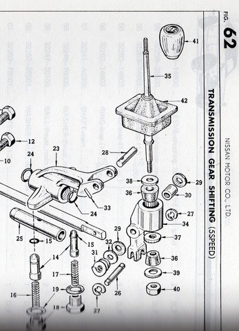

dom Posted March 9, 2017 Author Posted March 9, 2017 Alan, thank you again! I will definitely be taking you up on that offer. Great info on the lever, I did not know that. Just to confirm, the lever on the early 5 speed Japanese market cars is supposed to be straight? I came across one available in Japan but it was in pretty rough shape. It had a very subtle bend to it, wasn't sure if that was original or not? Quote

HS30-H Posted March 10, 2017 Posted March 10, 2017 Just to confirm, the lever on the early 5 speed Japanese market cars is supposed to be straight? I came across one available in Japan but it was in pretty rough shape. It had a very subtle bend to it, wasn't sure if that was original or not? Original FS5C71-A lever for S30-series Z is dead straight. From the 1970 factory parts list: Part number is 32841-25500, which is exactly the same as that on FS4W71-A transmissions used on early north American market HLS30U 'Datsun 240Z'. Quote
dat2kman Posted March 10, 2017 Posted March 10, 2017 The sticks are straight for all of them! Dom, yes, have casings, levers, and complete unbroken reverse gear main, counter and idler gearsets, along with other items, including a main output shaft for a 240Z. Postage ex Aus isnt a problem, I have just freighted four Atara Racing 15x9" "watanabe" rims to Washington, took 5 days! Quote
