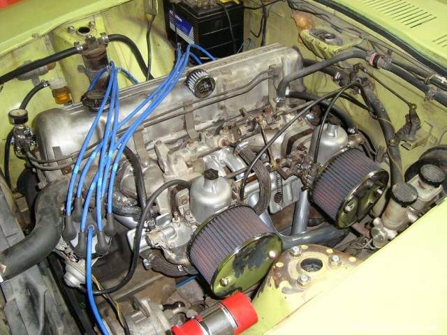

Mickl Posted February 25, 2017 Posted February 25, 2017 I am not so mechanical so have to get the car looked at down at the garage, and I live in a small town so access to dynos and specialist mechanics is difficult. The auto 260 has been rough to keep going under idle when cold and occasionally backfiring when put under load. Mechanic had a quick look recently and thought the vac advance was shot and that the vacuum from the twin carbs was not working that well either. He suggested I investigate a fully mechanical dizzy from a speed shop to overcome any vac issues. The initial setting is 15 degrees of advance, don't know what the total is. Looking for advice on: 1. Will it be possible to replace the vac unit to overcome the issue and where do you find the right one to buy 2. Would it be best to spend some $ to get a new dizzy and if so what is recommended? 3. Could the water temp switch or relay be the issue? 4. Something else??? Cheers, Mickl Quote

Mickl Posted March 25, 2017 Author Posted March 25, 2017 I have discovered today that SU carbies do not have any vacuum pipe on them. Not sure where the tube onto the vac unit on the dizzy comes from as the car is at the repair shop atm. A friend has advised me that the manifold can be removed and drilled for a pipe barb then connect it to the dizzy vac unit. Also, there is a thick spacer(?) almost one cm thick between the carbie and the manifold and alternatively it can be drilled for the barb instead of the manifold. The vac unit itself has been found to be split so I will also have to get a new one or get it repaired. So......can anyone confirm the above and which path would you take? Thanks, Mick Quote
Riceburner Posted March 25, 2017 Posted March 25, 2017 (edited) The factory SU carbs will have a vacuum pipe off the rear of the front carb, google is your friend. The one cm spacers are factory phenolic spacers Edited March 25, 2017 by Gareth. J. Quote
zeds4ever Posted March 26, 2017 Posted March 26, 2017 (edited) Hi Mick , glad you recvd the info on Vacm unit . Mate is it a 280 ZX ? or do you still have the 260Z points system in use. Check with the mechanic if he removed the vacuum unit from the dissy to see that it leaked , it's best to remove it & place a tube on the tube into the unit & suck on the end of said tube , if the diaphragm is stuffed you will be able to draw air thru it but if no air is forthcoming the unit should be OK from my experience with them . It would also be advisable to remove the top internals of the dissy & check the oscillating plate that is immediately under the fixed mounting plate , as NismoZ states this part is usually a problem being that it is only made of a type of plastic material & over a period of years of heat & cold becomes very brittle & eventually breaks apart so a new vacuum is of no use then !! .For the amount of money you will spend on getting your old dissy fixed I would highly recommend that you invest in a reconditioned 280ZX dissy you will get far better all round performance with less problems . Your water temp switch & relay? have no connection to your dissy so they have no bearing with your issue . Send a PM to Gavin as he may be able to direct you to someone in The states to get a recndnt 280ZX unit for you . Regards : Alan . Edited March 26, 2017 by zeds4ever Quote
Groundhog Posted March 26, 2017 Posted March 26, 2017 Alan helped me with parts for my 280 dizzy rebuild. It is worth checking as I found my rotational plate stuffed. The ball bearings fall out of the little plastic spider. There should be three ball bearings in this keeper. This is what I did to repair it. Made a spider out of sheet aluminium and placed three new ball bearings in. And lastly, I got a new vacuum advance from this guy.He remanufactures the diapraghms and has most on the shelf.http://www.dualfuel.net.au/ Quote

Mickl Posted March 26, 2017 Author Posted March 26, 2017 Thanks everyone for the detailed input on my problem. I just contacted the mechanic and he confirmed that the vac unit diaphragm was split so it needed refurbishment to get it going and the place in Caboolture sounded very suitable. The rest of the distributor seemed OK. However, there was no "ported" vacuum on the Su carbs, only the manifold vac. and the manifold vac does not perform properly between isle and revving. I got the Su carbs long ago from a guy in Wollongong before I swapped the old mechanical points distributor over for the electronic 280zx distributor so maybe they don't complement each other? Do the original hitachi carbs have this "ported" vac off take which my su's don't have? The mechanic says I either need to find a way to get the SU carb "ported" and then the vac unit repaired, or Get a mechanical distributor and forget the vacuum, which could be expensive, or Get different carbs, which sounds expensive too. As I mentioned earlier, I am no mechanic and I am having some difficulty with the concepts and communicating exactly what the mechanic is explaining. Getting the car to start easily, smooth warm up and running properly under load is what I am hoping for. Next move?? Quote
Groundhog Posted March 26, 2017 Posted March 26, 2017 You can get your vacuum port takeoff from the cross manifold tube that takes the throttle linkage shaft.PM me your email and I'll send you a photo of a spare one I have. I'll see if I have an old vac advance diagpragm also.GH GongZ 1 Quote
