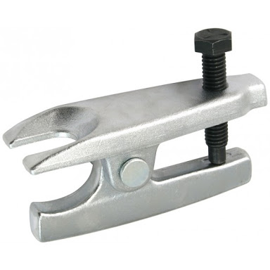

Moderators PB260Z Posted November 10, 2016 Moderators Posted November 10, 2016 (edited) Hi I have always used a ball joint seperator and have yet to find one it can't seperate. On the odd occassion have had to crank up the pressure then leave it for a while, then add a little more. If you haven't tried one I have recently purchased a new as the old one went walkabout - Happy to lend it to you, but I won't be in the shire until friday 18/11 at the earliest. Edited November 10, 2016 by PB260Z George 1 Quote

dat2kman Posted November 10, 2016 Posted November 10, 2016 Sounds like a bit of moisture has gotten into the taper. If the screw seperator is not able to do it, Then a pickle fork is the answer, but, put some steering lock on, get the steering arm and rear tension rod in as straight a line as possible, and hold pickle fork in same straight line. Hard sharp decent whack. Quote
KatoKid Posted November 10, 2016 Posted November 10, 2016 Put a lever of some kind between the tie rod and the steering arm, hold some downward pressure on it and smack the steering arm end with a decent hammer and it will come off......in all my years this never fails and Ive never had to use a tool. Quote
Retro Z Posted November 11, 2016 Posted November 11, 2016 Ball joint removal tool would work and abit of cold spray Quote
Moderators PB260Z Posted November 11, 2016 Moderators Posted November 11, 2016 Peter, thanks, I'll take you up on that offer. Have you used that device on a Zed? No worries, and yes I have used this new one a Z, worked a treat. I will be in the Shire next Friday so will be in touch then. Cheers PB Quote
