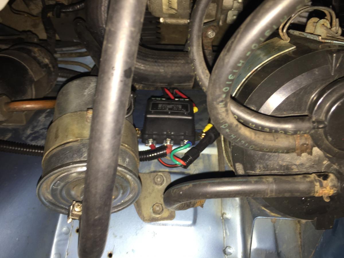

ScottyB Posted July 16, 2016 Author Posted July 16, 2016 Where do people mount their headlight relay when upgrading? I think I'll track the wiring right back into the bay like where it's just sitting in this photo. Quote
Moderators PB260Z Posted July 16, 2016 Moderators Posted July 16, 2016 Hi On the drivers side skirt, out of the way but not too hard to get to. Cheers PB Quote

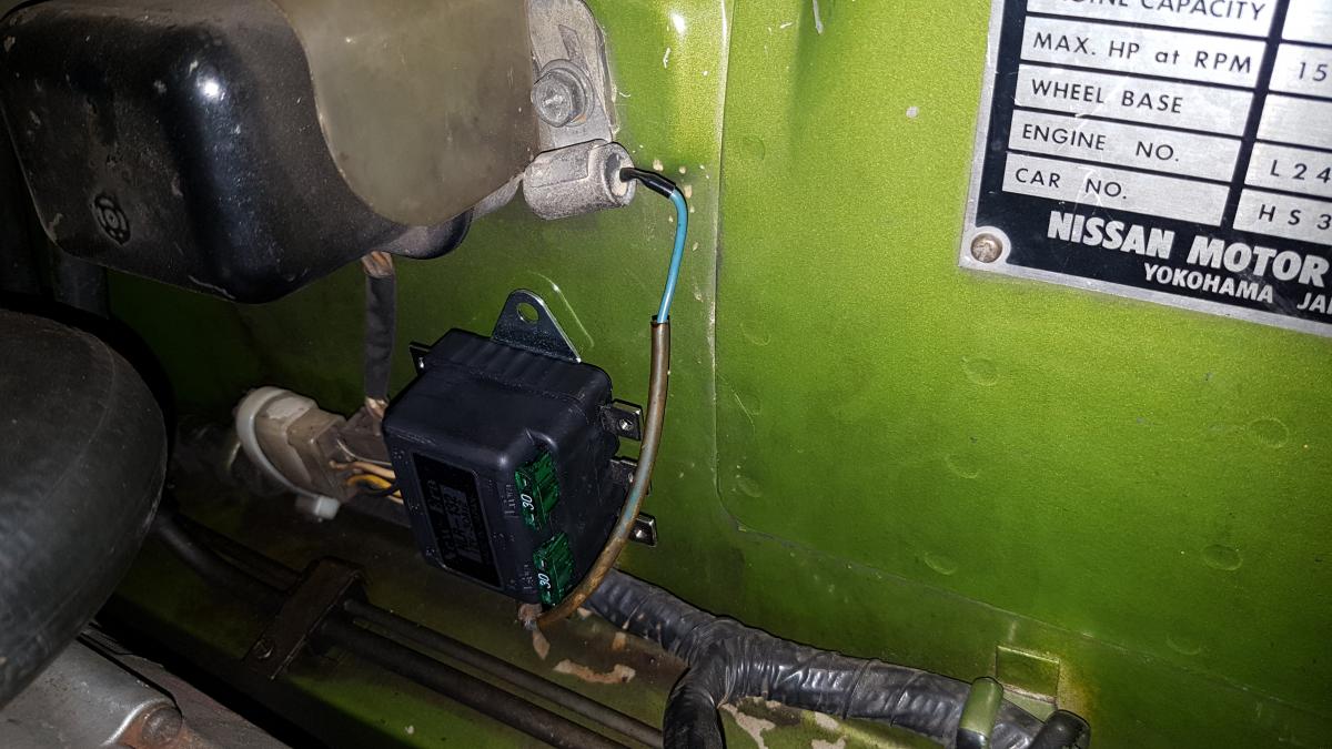

ScottyB Posted July 23, 2016 Author Posted July 23, 2016 We'll, I was confident going in and went to install my headlight relay. Took a positive from the alternator, earthed on the body and grabbed both low beam power when switched wires to now pass through the relay. Ultimately, left the rest of the wiring as it was. Passenger side still dim... I earthed the relay alone, not splicing into the earth wire going to the headlights. Would that be the difference or do I have it wrong elsewhere? Quote
CBR Jeff Posted July 23, 2016 Posted July 23, 2016 (edited) Scott Use a multi meter to check to voltage across each light on each side. If they are the same it might be the bulb. If the passengers side is a lower voltage ( probably the problem) then you have a voltage drop ( extra resistance ) in the wiring. My guess is in the earth (-) side of the circuit based on what you have said. Jeff Edited July 23, 2016 by CBR Jeff Quote
ScottyB Posted July 23, 2016 Author Posted July 23, 2016 Definitely wiring. 4v drop from one side to other. No high beam lights (didn't have them when I bought it either). Quote
CBR Jeff Posted July 23, 2016 Posted July 23, 2016 You should be able to use the multimeter to determine the location of the problem. You need to find the location of the volt drop. This will be made simpler by being able to compare one side to the other. Good luck. Tomorrows job? Jeff Quote
ScottyB Posted July 30, 2016 Author Posted July 30, 2016 I put the new transmission in today and got to take the car for a nice drive. It's great having a box that stays in 5th and not having to hold it in reverse r eally helps. Best part was doing it all myself - first time pulling/installing a box before. Headlights are still a fail Jeff. I rewired to earth both sides off the relays earth - no dice. I only get around half the voltage on the passenger side light into the relay, so it's getting kinda frustrating now. Need to get in and fix it though, need to re-register it in Tasmania. Ponyo240z and gav240z 2 Quote

CBR Jeff Posted July 30, 2016 Posted July 30, 2016 I put the new transmission in today and got to take the car for a nice drive. It's great having a box that stays in 5th and not having to hold it in reverse r eally helps. Best part was doing it all myself - first time pulling/installing a box before. Headlights are still a fail Jeff. I rewired to earth both sides off the relays earth - no dice. I only get around half the voltage on the passenger side light into the relay, so it's getting kinda frustrating now. Need to get in and fix it though, need to re-register it in Tasmania. Great work Scott. It is a great feeling to fix, repair or make things yourself. Stick with the lights. I'm sure it won't be anything to dificult to fix once you have worked it out. From your discription it sounds like the voltage drop is on the + side. Jeff Quote
ScottyB Posted August 8, 2016 Author Posted August 8, 2016 Cheers Jeff - 99% fixed the headlights, which now feature both headlights and one high beam. I am quietly confident that the globe I didn't replace is the issue. Took the old girl for a spirited fun drive through the mountains on Sunday. She was perfect, but I noticed an unburnt fuel smell. Got home and it wasnt obvious straight away, but found that fuel had come out of the filler and run down the rear quarter panel. My guess is there's no baffles in tank? Quote
