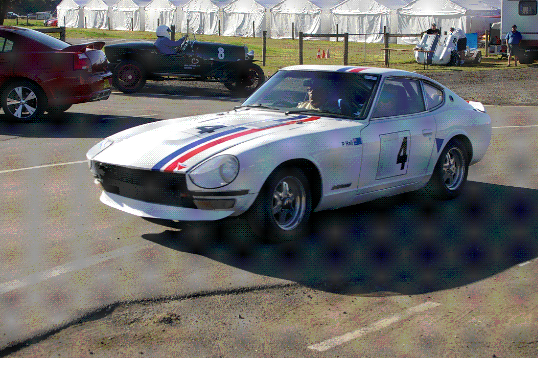

zr240 Posted March 9, 2008 Posted March 9, 2008 I saw an awsome drive from a white 240z at phillip island historic by Peter Hall Came 3rd in the historic sportscar race doing high 1:54!!!!! Lurch I guess I was wrong when I said there is no way you could go quicker than a 1:55 in an historic zed!!! Does anyone know what he is running in it. ie engine spec as it must be a real good engine and handleing setup!!! Ash Quote
Moderators Zedman240® Posted March 9, 2008 Moderators Posted March 9, 2008 Apparently its just a healthy L26 making 230 rwHp. Another club member asked how he achieved it but he was very tight lipped! Its a 260Z 2 seater running with 6" rims on 185 semi slicks...how the hell does he do it? I guess its all in the handling.. Quote

zr240 Posted March 9, 2008 Author Posted March 9, 2008 Yer he must have the package (inc driver) right on the money! If its a 260z does that meen it has those flat top carbies??? Ash Quote
Zeddophile Posted March 10, 2008 Posted March 10, 2008 If its a 260z does that meen it has those flat top carbies??? Unless he has been given concessions to run SUs, yes. The section of Sc regs on induction states that bore size is free, but make, type and number must remain as standard (but any period style manifold can be used). Which in theory means on SUs you could run some with much bigger throats. Engine wise, the block, head and stroke must remain original (or a CAMS approved alternative), but internals are free, and a 1.5mm overbore is allowed. Heads can also be modified by removal of metal only (guessing that means no larger valves!). So if you were smart, you would bore out the allowed 1.5mm, giving you about an extra 80cc of capacity. Then you'd use flattop pistons to bring up the compression (which incidentally would probably lose most of the displacement increase), and port the crap out of the head, to match the big and scary cam you just put in. Set of extractors to complete the picture, and you've got a pretty angry motor starting to form up. Quote
nat0_240_chevZ Posted March 11, 2008 Posted March 11, 2008 If its a 260z does that meen it has those flat top carbies??? (guessing that means no larger valves!). So if you were smart, you would bore out the allowed 1.5mm, giving you about an extra 80cc of capacity. Then you'd use flattop pistons to bring up the compression (which incidentally would probably lose most of the displacement increase), and port the crap out of the head, to match the big and scary cam you just put in. Set of extractors to complete the picture, and you've got a pretty angry motor starting to form up. flat top or dished has no effect on displacement. just compression volume. stroke & bore is the only thing that governs this. Peters cars are all about less is more, less porting to keep intake velocities high. combustion chamber shape and cam is moreso what hes keeping tight lipped. the 2.8 + litres is a bit of a blur of the rules!!, as is the intake and head choice. nothing is ever what it seems on petes cars. i also am aware his son bens car is pumping out 260hp+ from the L, with throt bods and motec!, these motors love to spin and the bigger stroke is not always the way to go. I know a couple of people that know more about what he does run, but thats why he is so succesful as he doesnt tell all to anyone, one thing i do know is that the piece of crap that a members here ,ate sold over here was a bucket no matter what, pete waived his wand and got it running like silk, YES silk. even i was astonished with the response and tune fre the early hitachi/su type carbs. Peter really knows his Z cars and L series motors, and could teach alot of the eastern state z specialst a few hundred things or 2. not bad from some guy out in the hills who reapairs lawnmower motors!!!! nato Quote
zr240 Posted March 11, 2008 Author Posted March 11, 2008 Hi nato Well it still suprizes me that a zed with std brakes (drums on the rear!) and too the sc rules can do it! Also it has to run the head that came with the car (E88 i think?) and as zedophile said its on 1.5mm overbore on his 2.6 block which would make it just under 2.8L??? (not sure if I calculated right) I agree on the bigger storke being not always the way to go as my old L race motor was not stroked and put out over 260hp aswell. I personally dont know of any z specialists in the eastern states or non i would take my car to Anyway Its one hell of a good setup zed in my book just would love to have a closer look one day Ash Quote
nat0_240_chevZ Posted March 11, 2008 Posted March 11, 2008 ill see what i can come up with. trust me when i say nothing is as it seems on his cars. its just really funny how people are flawed when thay have a quick look over his car. rear brakes, well how much do they really do when you are 11/10ths on the picks, good quality shoe and pad compouds do more than anything else in a braking system besides area!!!! adequete cooling & pad compound is the key on the fronts (as it is in any brake and clutch system). rules are made to be bent and maybe snapped into 20 pieces LOL. Pete is an old fart that knows almost every engine components combo there is within and outta the "rules" its like trying teach the creator hoe to make something he already created from scratch. old dog and old tricks. reminds me of the old "mothballs in your fuel to up the octane" trick, something you grandpa used to do when he was a kid!!! nato Quote

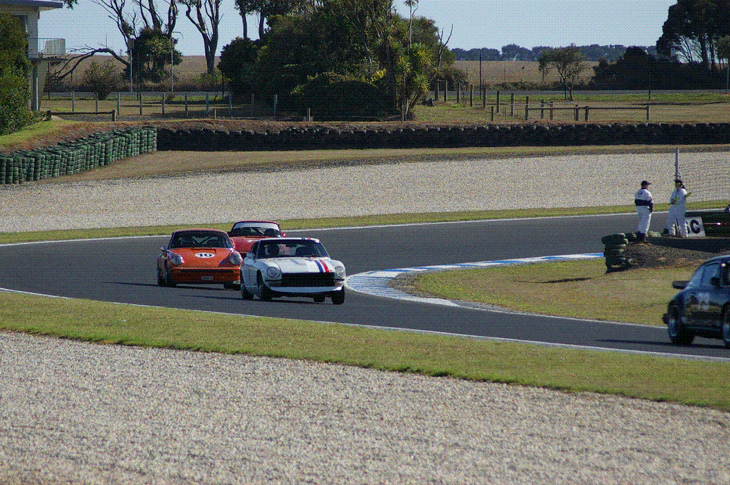

zr240 Posted March 12, 2008 Author Posted March 12, 2008 Well he only had 195 semi slicks! And there wasnt alot of four wheel drifting (not visable anyway). Was just very clean lines and nice driving. The Panteras and other v8s will still blow the zed away as the are still a few seconds quicker. Ash Quote
620Z Posted March 12, 2008 Posted March 12, 2008 My mistake on the 195's. He must have been 4 wheel drifting everywhere. Pretty impresive on those tyres. I can tell you he won't be getting those times doing clean lines on 195 tyres alone. Quote
C.A.R. Posted March 12, 2008 Posted March 12, 2008 My mistake on the 195's. He must have been 4 wheel drifting everywhere. Pretty impresive on those tyres. I can tell you he won't be getting those times doing clean lines on 195 tyres alone. You've gotta be joking Craig!? The ONLY driving style he'd be doing those times is, is with clean, fast lines while keeping up Maximum corner speed. Pushing hard yes. But 'Power Sliding'? Thats a sure fire way to loose time on the track. Come Go-Karting with me & I'll prove you my point /me opens up a can of worm's' Quote

zr240 Posted March 12, 2008 Author Posted March 12, 2008 Come on nato play nice Craig I saw the lines and they were very clean. he was hardly even drifting at all coming onto the main straight and most cars drift a little coming out of that corner! The thing with Phillip Island is carrying speed through the corners and even though I had more grip and power in my race zed I still needed to keep as smooth as possible if I had any chance of keeping up with the turbo porsches etc. As you guys may know my zed got down to 1:47 at the island and that was on second hand slick tyres and a lot smaller budget than alot of sportscars. I figured out it would cost me just as much to run an historic zed as the rules are so tight you really need to have good tyres/ brakes and fresh motor. Anyways hopfully the new racecar will be faster but we will see Ash Quote
