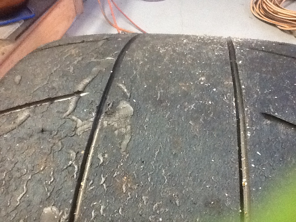

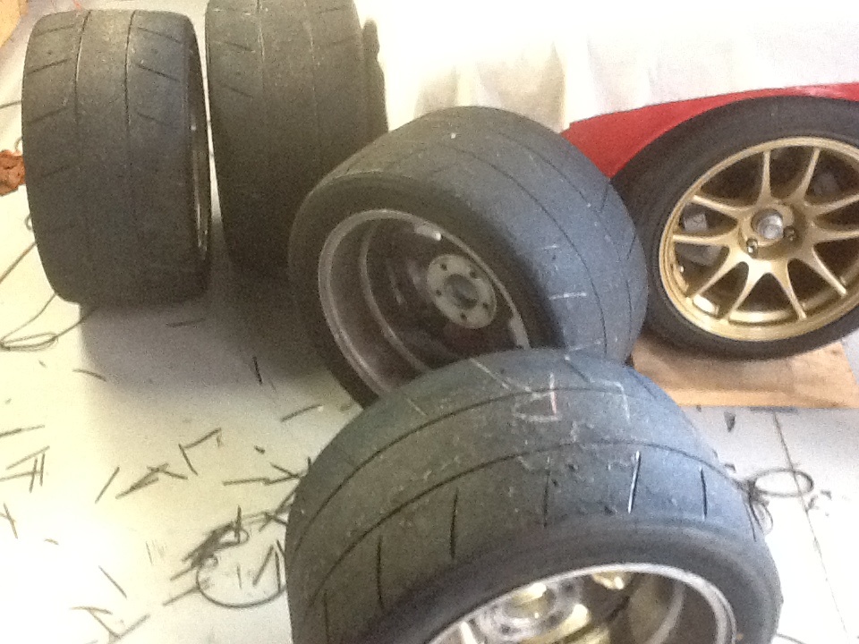

Gordo Posted May 28, 2016 Author Posted May 28, 2016 So today I started to groove the slicks. They are 300mm wide so I don't think I'll lose any contact patch on the road. Just hope cutting blocks into the tires will make the rubber move around a bit to generate some more heat. 260DET 1 Quote
PZG302 Posted May 29, 2016 Posted May 29, 2016 That will work as a budget dodgy solution, but if going slicks and serious get the right compounds to start with and get the car set up right. If doing the second hand get what you can for sprints, they will be pretty much shagged unless you get tyres that ave only been roaded, then the grooves and siping won't hurt and will get some extra heat into them but they still won't be as good as new ones in the right compound. Having said that i still use second handies for track days and shakedowns, suspension set up days will be on new slicks after learning the hard way..... Quote
Gordon Dobie Posted October 28, 2017 Posted October 28, 2017 I had Russell Stuckey groove the tyres on my hillclimb cars and it worked quite well but if the tyres have been cycled to often ( got hot then cooled down) you will be chasing your tail. Each time the tyre is cycled it cures the rubber and if this is the cause of your problem grooving the tyres can cause the tread to chunk ie tear chunks of rubber off the tread. The ultimate solution is to buy the correct tyre to suit the car. Quote
