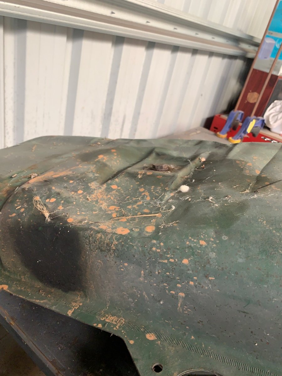

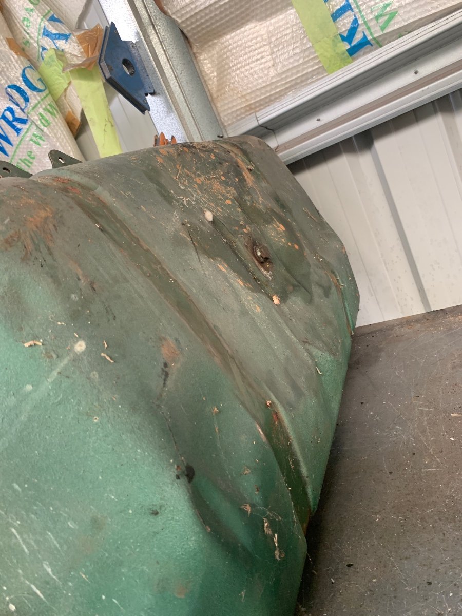

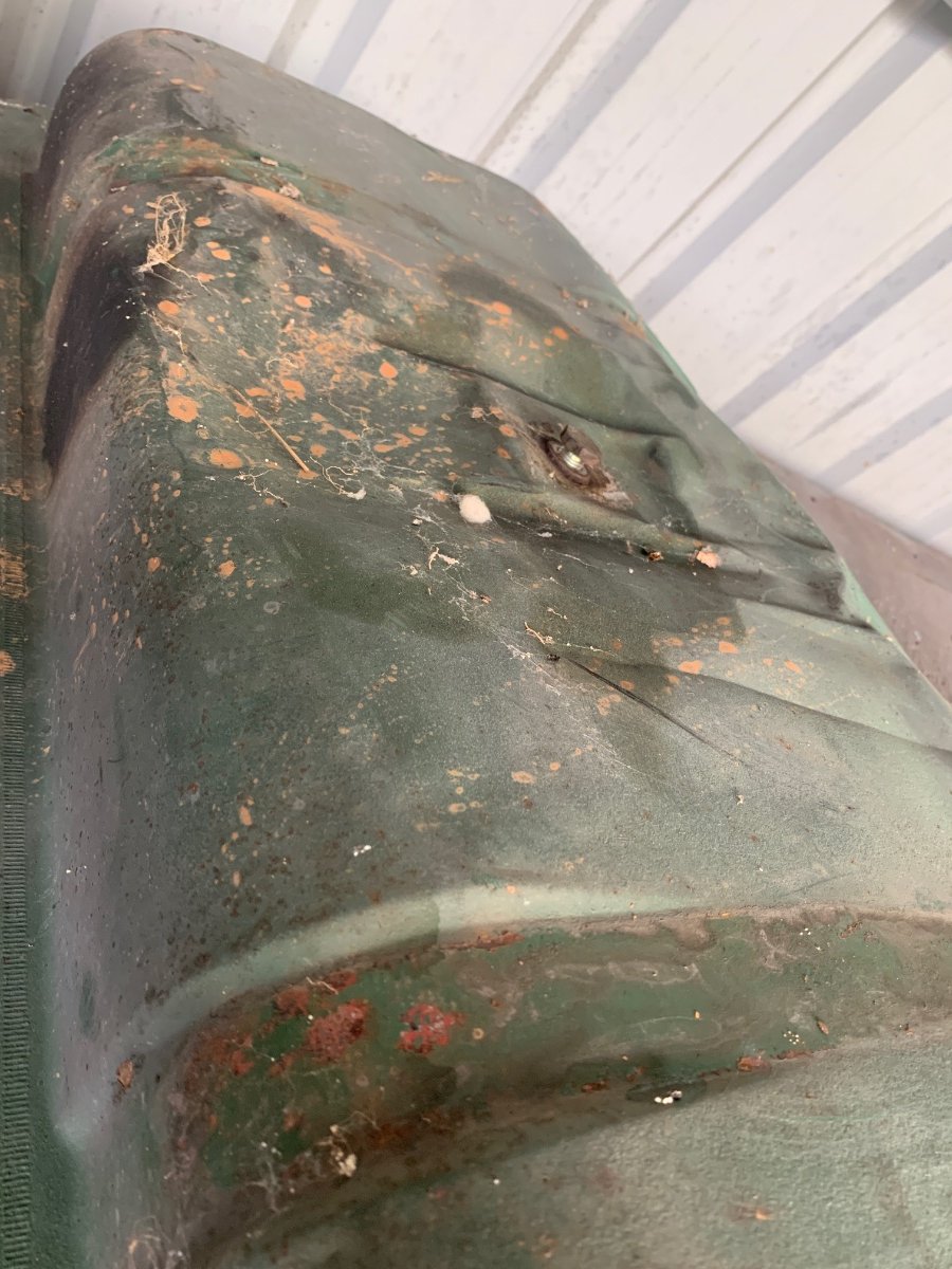

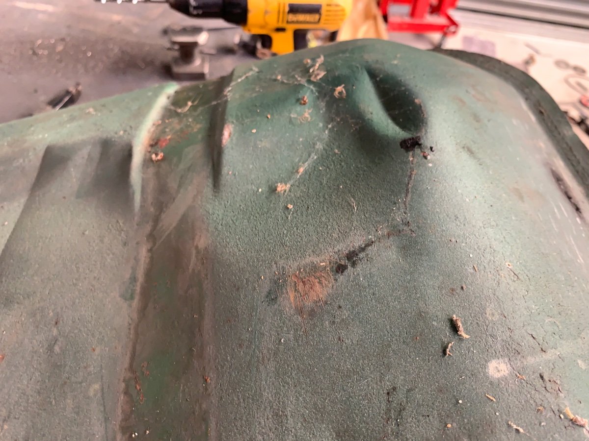

240ZBUILTBYME Posted January 26, 2022 Posted January 26, 2022 @gav240zdid you ever end up fixing those dents? I have the same problem with mine, huge dents but perfect internals I have a stud welder and slide hammer kit and was thinking of giving that a go but as you were I am worried about welding activities on a fuel tank… also does anyone know what metal the tanks are actually made of? I can’t find anything on it Mines been empty and dry for 3 years so I’m not overly worried about explosion. I was also thinking of trying to make up a bracket I can bolt on with the drain plug and using the slide hammer to try and pull the majority of the dent out. or trying those suction dent pullers New fuel tanks are around 1000 AUD shipped from s30 world so there’s always that option Quote
C.A.R. Posted January 26, 2022 Posted January 26, 2022 They are made of a very stiff zinc coated steel, but they can be welded without any problems. The suction puller wont work - the dents are to big. The slide hammer in the drain hole will work, and you might have to drill a hole in the top and use a length of rod to tap the dents out. I'd personally focus on the bodywork first - the tank can be done anytime. 240ZBUILTBYME 1 Quote
Administrators gav240z Posted January 26, 2022 Author Administrators Posted January 26, 2022 You can buy reproduction tanks now too, so I'd look at doing that and may end up doing that at some stage. We improved the tank a lot but it isn't perfectly dent free. 240ZBUILTBYME 1 Quote
240ZBUILTBYME Posted January 26, 2022 Posted January 26, 2022 1 hour ago, C.A.R. said: They are made of a very stiff zinc coated steel, but they can be welded without any problems. The suction puller wont work - the dents are to big. The slide hammer in the drain hole will work, and you might have to drill a hole in the top and use a length of rod to tap the dents out. I'd personally focus on the bodywork first - the tank can be done anytime. Thanks Lachy, lol yep bodywork is priority, hoping to pull my finger out of my arse and get it blasted this year… Quote
Administrators gav240z Posted January 26, 2022 Author Administrators Posted January 26, 2022 S30 World supplies fuel tanks. https://s30.world/fuel-tanks 240ZBUILTBYME 1 Quote
