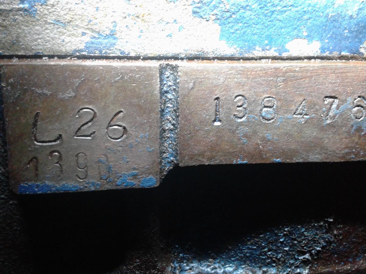

Simestime Posted December 14, 2015 Posted December 14, 2015 Hi i asked this question in another thread but no one has answered the question yet so i thought id ask again. The current block in my zed has 1390 stamped below the L26. Could this be when it was rebuilt(1-3-90) or is it implying something else?Like 90mm bore? Im guessing rebuild but has anyone seen this before? As far as i know the engine was an exchange reco from the adelaide area. Quote

Administrators gav240z Posted December 14, 2015 Administrators Posted December 14, 2015 It doesn't sound factory, post a pic and we will be able to confirm. The 2 numbers I'm aware of are the block type eg: P30, N42, F54 and the engine number L2X-XXXXXX. Anything else is probably not standard... Quote
Simestime Posted December 15, 2015 Author Posted December 15, 2015 Heres a pic of the numbers below the l26.ill let you guys be the judge Quote
Administrators gav240z Posted December 15, 2015 Administrators Posted December 15, 2015 Never seen that before myself. Odd. Quote

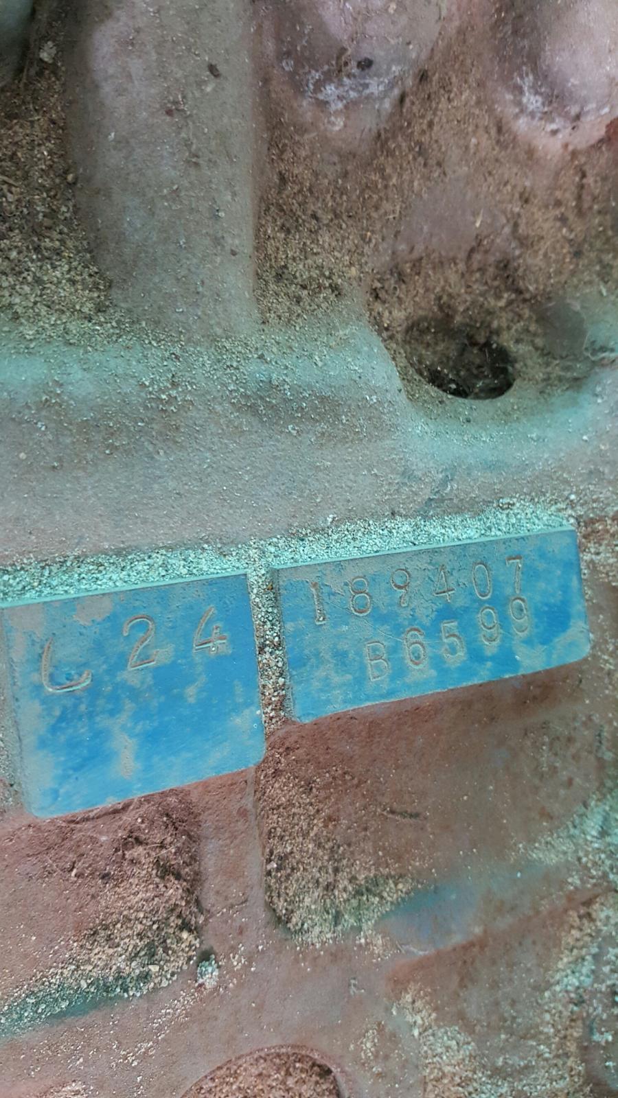

RB26DETT Posted December 15, 2015 Posted December 15, 2015 I've got a L24 block with two rows of numbers Quote
Riceburner Posted December 15, 2015 Posted December 15, 2015 There just numbers from a standard punch set, definately not factory. I'd say it was from when the engine was rebuilt. Quote
C.A.R. Posted December 15, 2015 Posted December 15, 2015 (edited) The OP's engine has been rebuilt previously - looks like something HM Engines did back in the day...Choung - you's has been milled & re-stamped! Edited December 15, 2015 by Lurch ™ Quote
Simestime Posted December 16, 2015 Author Posted December 16, 2015 Thanks for the responses guys,i presumed the numbers were probably rebuild date but thought id ask.I'll be stripping the engine over the next few months and hopefully its still standard bore.I picked up some AE flat tops in standard size pretty cheap so hopefully i can use them.Otherwise ill be on the hunt for a virgin block to use. Thanks again. Quote
