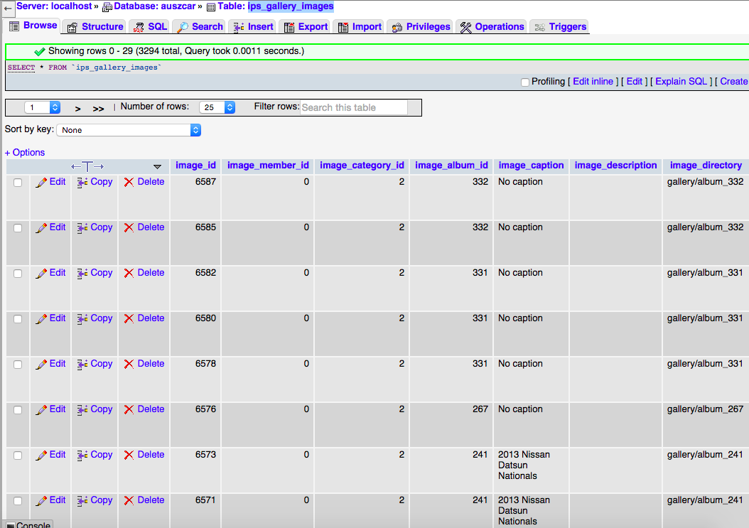

Administrators gav240z Posted July 14, 2015 Administrators Posted July 14, 2015 Need a little SQL help here... It should be simple but I keep getting errors...Rather than post the SQL statements I've tried and adding confusion I'll include a couple of photos of the database tables... ips_gallery_images - This table is for all the images in the photo gallery. The problem is the column image_member_id is 0 for all images. (Dangling reference?). But it does contain an image_album_id which determines the album they belong to. (foreign key). See attachment ips_gallery_images.png. Now if we look at the ips_gallery_albums table, we can see columns album_owner_id and album_id. See attachment ips_gallery_albums.png So what I need to do is: Set all the images within an album to have the same owner id as the parent album. How would you structure this SQL statement? (Provided a few may already be correct having manually set them, so a where image_member_id=0 might be a good idea here). Quote
andyk_79 Posted July 14, 2015 Posted July 14, 2015 UPDATE ips_gallery_images SET image_member_id = (SELECT album_owner_id FROM ips_gallery_albums WHERE ips_gallery_albums.album_id = ips_gallery_images.image_album_id) WHERE image_member_id = 0 Quote
Administrators gav240z Posted July 14, 2015 Administrators Posted July 14, 2015 Brilliant that appears to have worked. I had originally tried something like this. update ips_gallery_images set ips_gallery_images.image_member_id = ips_gallery_albums.album_owner_id where ips_gallery_image.image_album_id = ips_gallery_albums.album_id; My problem is I'm not always sure how to structure a statement and when I need to use a select statement or not? Quote

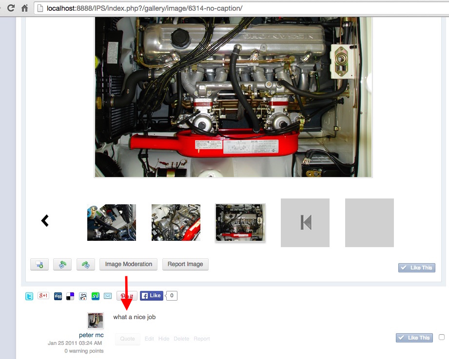

Administrators gav240z Posted July 18, 2015 Administrators Posted July 18, 2015 So I figured out why comments are not showing... Turns out that during the migration process the comment, it's date stamp, it's author and author id were all correct, but the image id referenced somehow got modified and the image id is out of whack. I've tried to see if there was any pattern to this modification but so far the numbers are all over the place. I can't work out why. I was hoping a pattern would allow me to apply 1 single statement to update them all to the correct image_id but at the moment I'm doing it manually (all 500 of them). Which is a pain in the arse no doubt but it works. Here is an attached example showing the comment appearing under the image correctly. An arduous task but I'll just do it in batches of 50 over the next few days (to save my sanity). Quote
