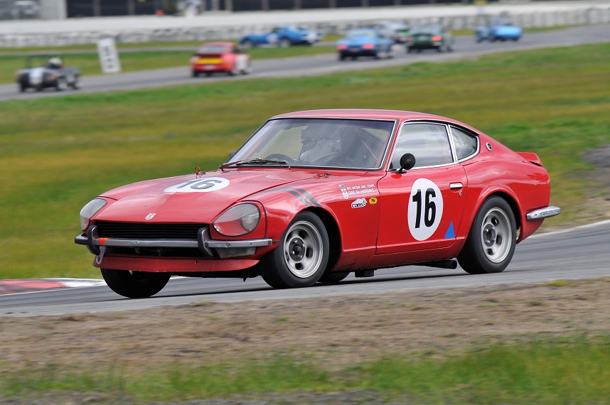

hmd Posted April 13, 2015 Posted April 13, 2015 Hi All, I joined the forum way back in June 08 with a crazy thought that I should get a Z to race in historic group S. A few years down the track and a couple of race cars in between I finally decided to get a group S Z car. So for that last 18 months I’ve been looking out for an already well set up car, something like Jason’s 280Z. I would have bought Jason’s car for the asking price if it was a 260Z, as I prefer a carburetted car over the EFI and also the 280 bump you up in the sub-class of Sc (2001-2600 Scb, 2601-3500 Scc). Recently a NSW group S 240Z came up and after talking to James Flett, Brian Potts and a couple of other NSW Z racers, I pulled the trigger and bought the car unseen with 2 extra engines, one running and one not. Got the car today, the paint work is a bit rough but other than that it has many good points. In time it will need a hot race engine and gearbox to match. Quote

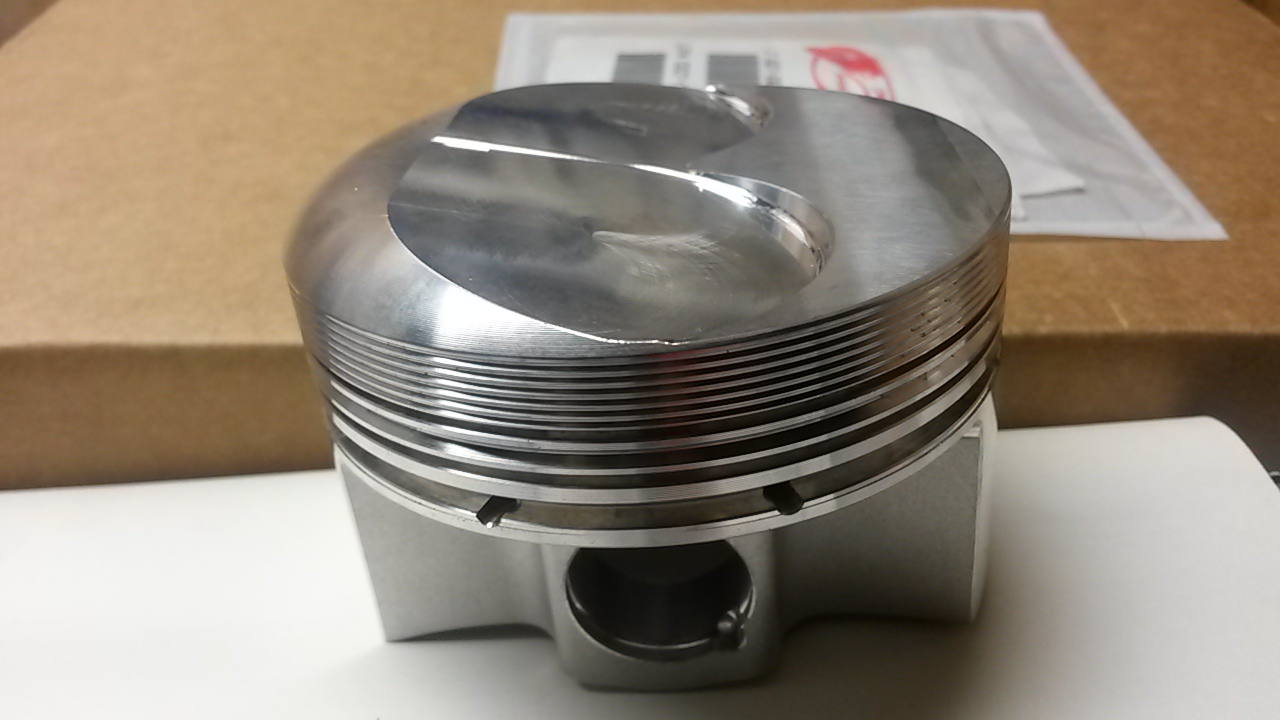

hmd Posted July 8, 2015 Author Posted July 8, 2015 and a Group S spec engine being brewed slowly by the guru. Quote
Administrators gav240z Posted July 8, 2015 Administrators Posted July 8, 2015 Not sure how I missed this thread, but great to see a S30z getting some lap time. I wonder what pistons those are? Also what cylinder head is "the guru" developing for you? Quote
hmd Posted July 8, 2015 Author Posted July 8, 2015 Gav, Custom JE Pistons. Head discussed here http://www.viczcar.com/forum/index.php/topic,15435.msg171577.html#new Quote

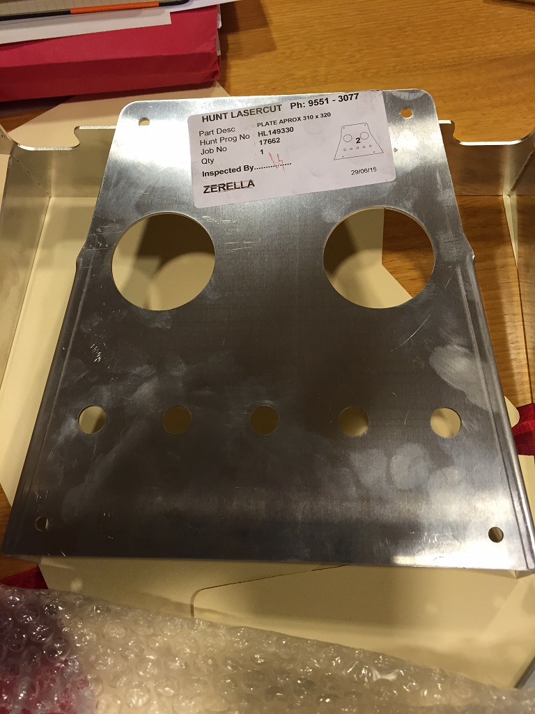

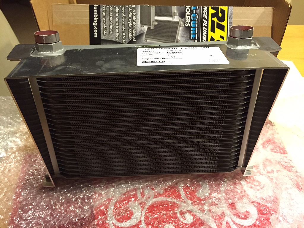

hmd Posted July 15, 2015 Author Posted July 15, 2015 Goodies from http://www.swmotorsport.com.au/ Quote

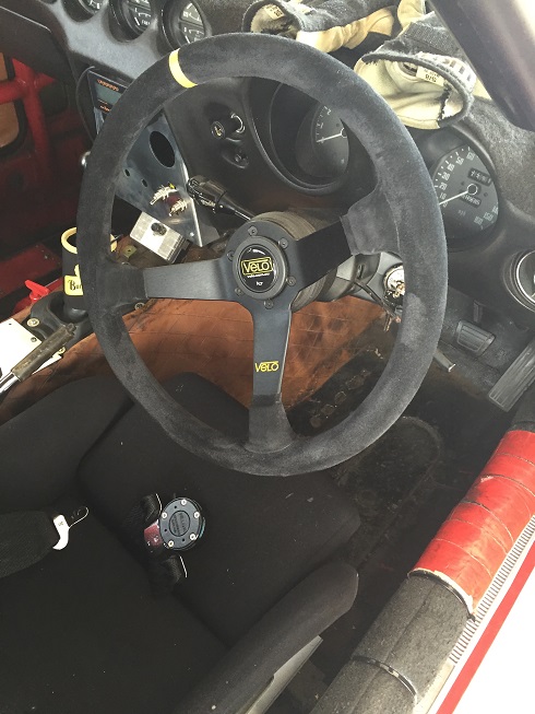

hmd Posted August 12, 2015 Author Posted August 12, 2015 I had also added power steering to the car before the race weekend. A massive 380mm steering wheel. I couldn't hack 15 laps at twisty Winton with a smaller steering wheel, the car is super heavy to steer even though it only have 4 deg caster and 2 deg camber. Quote
260DET Posted August 12, 2015 Posted August 12, 2015 Power steering is a must I reckon, lost a bit of feel with mine but the improvement in steering reaction speed made up for that, lots. Quote
hmd Posted August 12, 2015 Author Posted August 12, 2015 Richard, I don't think power steering is allowed. I was being sarcastic saying that my big steering wheel is my power steering. Quote
d3c0y Posted August 12, 2015 Posted August 12, 2015 Time to get in the gym and pump some iron!!! gav240z 1 Quote
hmd Posted August 12, 2015 Author Posted August 12, 2015 lol that's the general non-mechanical response I get. Quote
PZG302 Posted August 12, 2015 Posted August 12, 2015 I found my old Zed wasn't too bad for steering once going on 8" wide rims with slicks with about 5 deg of castor, front guards trimmed and as much neg as we could get with a 350mm diameter wheel. Around the pits or moving in and out of the garage was a bit of a pain, but no worse than my old valiants or falcons I ran around in. Quote
