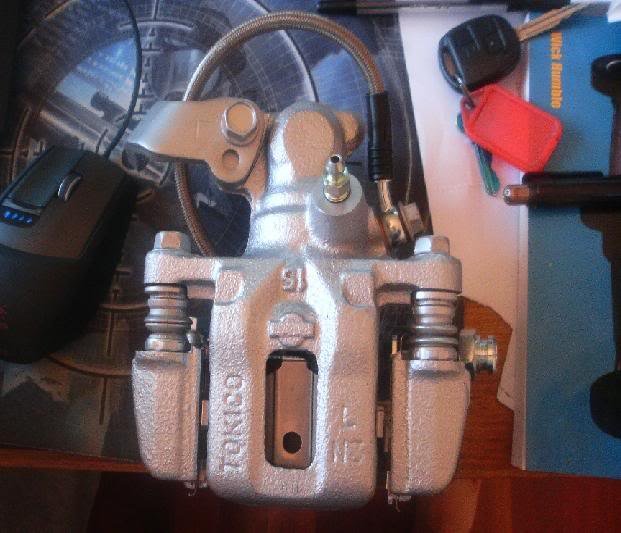

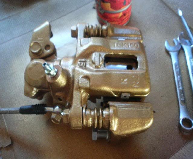

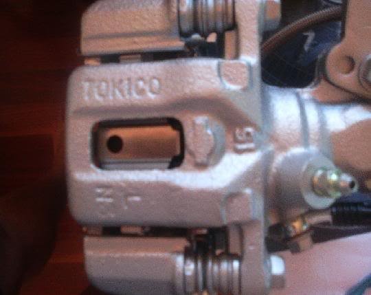

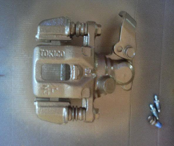

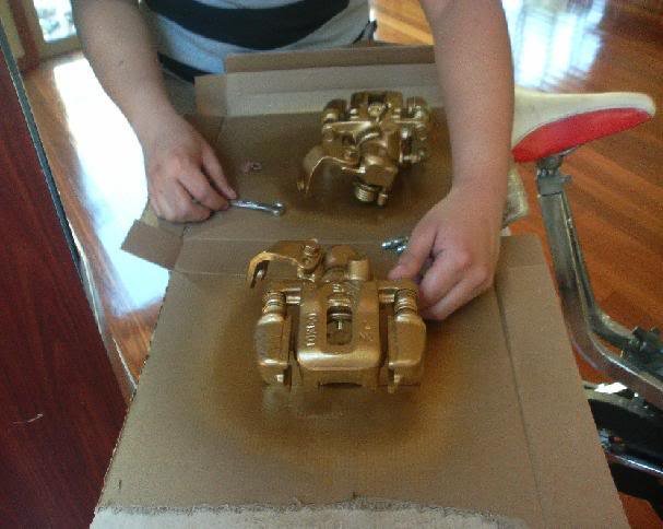

fufu Posted December 13, 2007 Author Posted December 13, 2007 OK back to the project. Getting things spray painted currently. First up the rear brake calipers. - Stripped them apart - Painted them in Gold, as my car will be midnight blue wanted a color to highlight certain aspects so i chose gold. - re-assembled These have to be the easiest brakes to undo and paint. Pics of the calipers when i first got them. Just painted. End Result. Lovely golden rear brakes. Will be doing the Fronts soon when i get the new rotors. I also did the rear license plate section including the rear tail light housings. But not in gold but in Metallic Charcoal. Quote

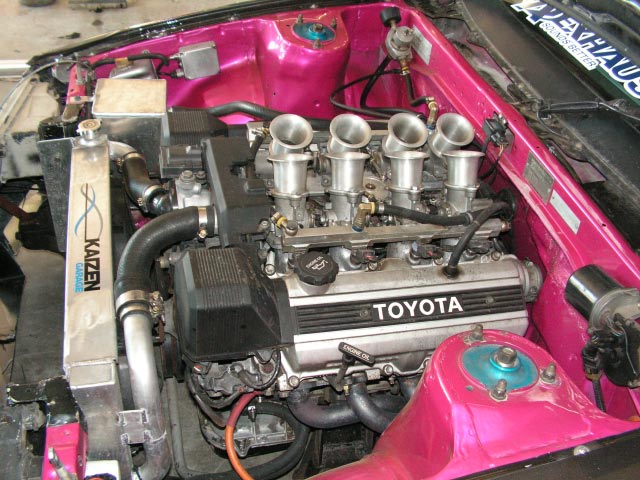

Pigpen Posted December 13, 2007 Posted December 13, 2007 Just thought I would share this happy snap of the 1UZFE in a Hatchi. Taken at the 2007 drift championship - Oran Park Food for thought ... Quote
