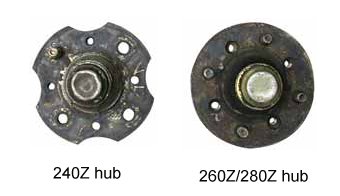

PeterAllen Posted May 16, 2014 Posted May 16, 2014 How did you go with this? I recall that when fitting the Wilwoods I had to install a 260Z hub as it pushed the rotor out further, to clear the caliper and control arm. You don't have 240Z hubs on by any chance, and the rotor is rubbing on the caliper or control arm? Quote

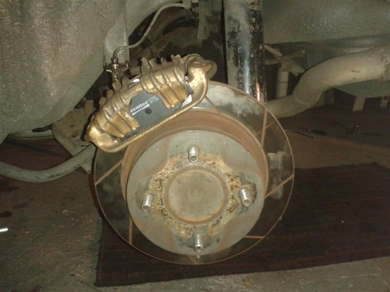

Scoota G Posted May 17, 2014 Posted May 17, 2014 Sam made it here fine, the fault turned out to be the organic component. We fixed that and i showed Sam how to pack the bearings. We Then changed the rear caliper position which now has the bleeder nipples at the very top and the handbrake cables are now well clear of the halfshafts. The handbrake now also functions. Quote
