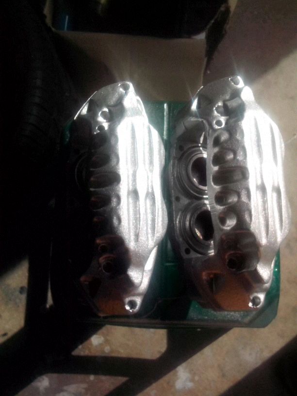

Retro Z Posted April 1, 2014 Posted April 1, 2014 In my opinion the added weight is negligible. Go coilover sleeves with the smaller springs and you would negative out the added weight. To me the benefits outweighs the negatives. Wilwoods or 300zx calipers may be lighter but then the adapter would make up the weight difference as Hilux calipers bolt right on to stock struts with no adaptors. The vented calipers are stamped S12W and has a bigger gap in the middle, and has a stripy patterned face ,while non vented is stamp s12+8 with a smooth face. Attached is a pic of what my vented calipers look like. Quote
d3c0y Posted April 1, 2014 Posted April 1, 2014 The vented calipers are stamped S12W and has a bigger gap in the middle, and has a stripy patterned face ,while non vented is stamp s12+8 with a smooth face. This is not entirely correct, S12+8 come in vented and solid rotor models. You can get away with using the vented S12+8 on a solid rotor too, but all this is discussed in the hilux caliper sticky... Quote
Agno Posted April 1, 2014 Posted April 1, 2014 Yep it is. I have solid rotors under S12+8 vented calipers and some TP Magna discs in the toolbox for when I wear out the current discs! Quote

Retro Z Posted April 2, 2014 Posted April 2, 2014 This is not entirely correct, S12+8 come in vented and solid rotor models. You can get away with using the vented S12+8 on a solid rotor too, but all this is discussed in the hilux caliper sticky... My mistake. It seems the s12w is an upgraded version of the s12+8 with 4 large pistons rather than 2 big 2 small of the s12+8 but is also slightly heavier with loss of wheel clearance according to this link. http://www.viczcar.com/forum/index.php?topic=7600.0 Silvermine motorsports also use the s12+8 as their stage 3 kit while s12w is a stage 4. Quote
d3c0y Posted April 2, 2014 Posted April 2, 2014 S12W calipers are very similar looking to a 4 piston MK IV supra caliper too. Quote
