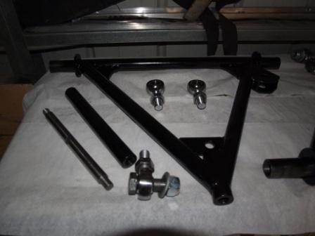

zcar63 Posted February 16, 2014 Author Posted February 16, 2014 Hi Guys i have a set of lower arms ready,here is some more info on the construction.All tube is 4130 chromoly,WELD IN INSERTS ARE 4130 chromoly, gussets are 4130 chromoly, the flange that the bushes thrust against are mild steel(5mm) the bracket for the adjustment arm is mild steel , the 16mm bolt is high tensile steel which i have drilled a through hole 9mm and cut to length and threaded m16 x 1.5 with a nyloc nut , or you can use your bolt of choice .The spindle pin is 4140 chromoly and approx 40mm shorter than standard,i will purchase bolts for this purpose in the future. The control arm has two (RH) rod ends and one (LH) rod end.The adjusting arms has one (RH) and one (LH) rod end,the left hand weld- in insert has two small notches cut in the edge to identify it,the (LH) nut has a notch around the edge as well .I have chased rod end suppliers all around the world a couple referred me to the local distributors who's quotes sometimes were interesting IE:26 x rod ends from local $98.23= $2554.24 plus freight and another was $55.00 each x 26= $1430 plus freight .The ones i am using came direct from overseas, they are dearer than one other supplier i was hoping to use, but he doesn't make 16mm fine thread at the moment. I will take them to work next week and get an accurate weight . Any questions ,don't hesitate to ask.Just a note,i am using chromoly weld in inserts as i don't see much point welding in mild steel inserts into the tube for them to become a possible weak point. Cheers David Quote

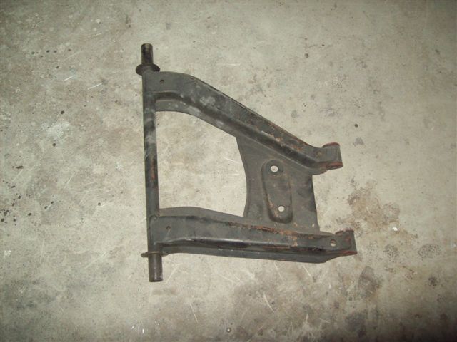

PeterAllen Posted February 18, 2014 Posted February 18, 2014 David Here are a couple of snaps of the arm I weighed. One of the arm itself, just to ensure we are weighing the same item/components, and one of it sitting on the scales at 3.7kg. I calibrated (for want of a better word) the scales with some groceries and they seemed close enough. The arms appear to be pressed from 2mm sheet and the large support brace and roll bar location point appears to be pressed from 1.5mm sheet. I can't say for sure it is off my 3/72, 240Z as I've mixed and matched them over a period of time. Quote

zcar63 Posted February 19, 2014 Author Posted February 19, 2014 Hi Peter/scoota My z is a 71 model the arms on mine might be off a later model then.The NEW ones i have are as light as yours Peter,but i now have adjustment and saved 2.2kg in weight over my old arms.That means 2.2kg less dieting i have to do,pass me another beer will you!!! Quote

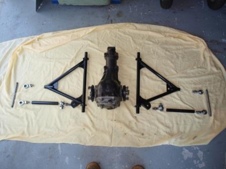

zcar63 Posted February 25, 2014 Author Posted February 25, 2014 Hi Gareth Great photo of the arms on your build thread.I need a better camera Cheers David Quote

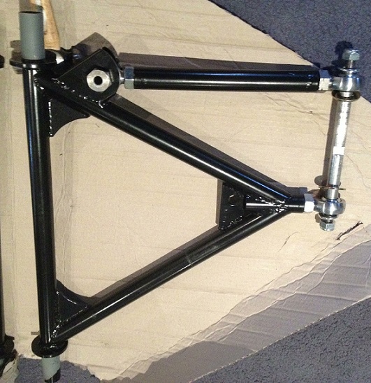

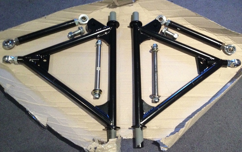

Riceburner Posted February 25, 2014 Posted February 25, 2014 I'll put some pics up here too David Very happy! Thanks again Quote
Riceburner Posted February 26, 2014 Posted February 26, 2014 Hi David, Here they are in all their glory It's only the 'camera+' app on an iphone 4s, seems to do ok for all I need. Quote
