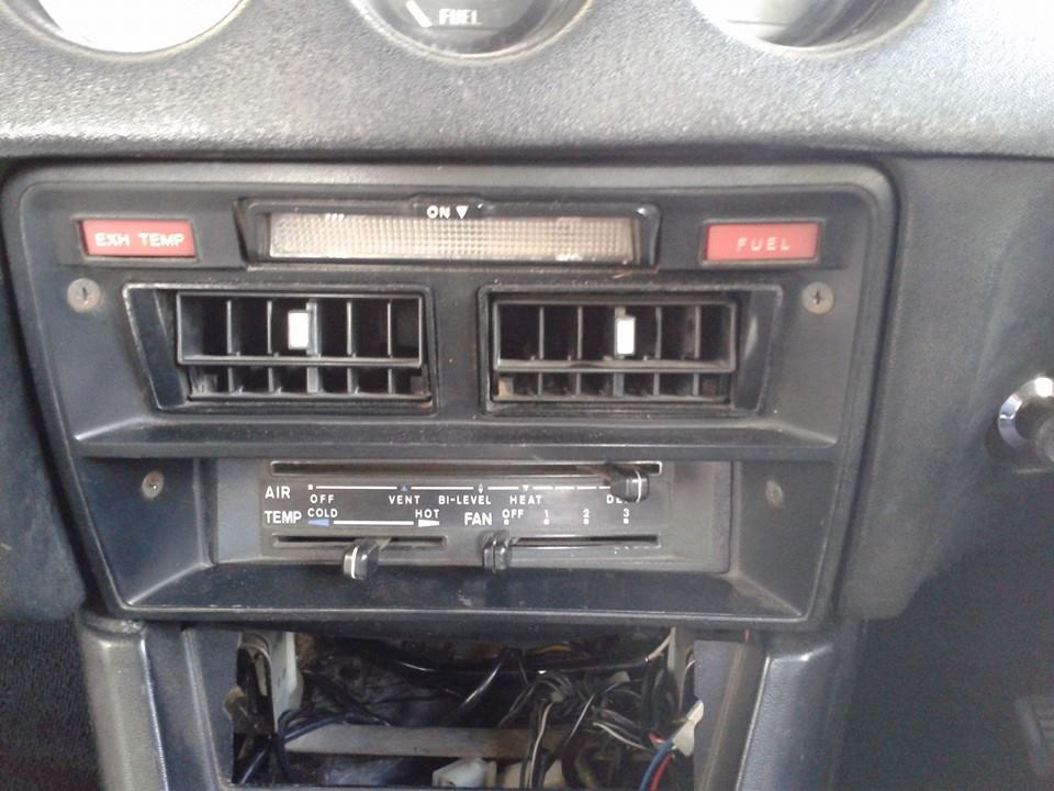

Scoota G Posted December 19, 2013 Posted December 19, 2013 hahahahahahhahahahahaha good 1. in 1971 no and I don't believe any of the S30 series even the late ones. 280zx maybe... But then again ........ Quote
Administrators gav240z Posted December 19, 2013 Administrators Posted December 19, 2013 I don't think my 260z ever had those . Quote
Scoota G Posted December 19, 2013 Posted December 19, 2013 That's a jap spec one i obtained from Dimitri. He had a few of them, they must be in Ash's collection now. Quote
Johnboy Posted December 19, 2013 Posted December 19, 2013 Looks like the US 280z, here is a pic of a 77 model. Quote
Scoota G Posted December 19, 2013 Posted December 19, 2013 Looks like the US 280z, here is a pic of a 77 model. Love the fasten seatbelts light. I need one of those hooked up to the nitrous switch. Quote
gilltech Posted December 19, 2013 Posted December 19, 2013 From the cars I've seen, the home market Japanese S30s, & North American 260/280s, had low fuel warning lights & seatbelt warning lights. Eg. I have the centre panel from a 1975 or 76 home market Japanese S30 in my parts stash, which has them both. But my early '74 260 (sold new-NZ) doesn't have anything in the dash wiring loom to plug same into. AFAIK they didn't feature on any of the cars sold new in Australasia. Quote
