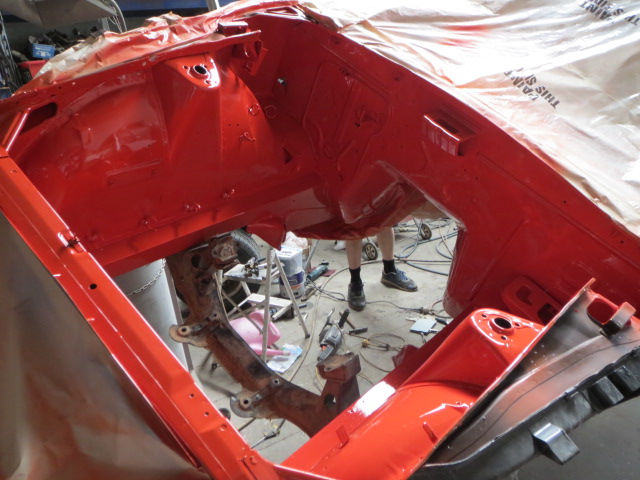

HKSZ Posted November 24, 2013 Author Posted November 24, 2013 Well I've got the oppertunity to paint the engine bay in a booth this week. If I 2k this much what precautions do I need to take, I've have a Sunstrom mask uvex goggles. I know it's not just avoid inhalation but contact too. Quote
neRok Posted November 25, 2013 Posted November 25, 2013 You need a special mask/cartridge to filter the problem iso' chemicals in the 2pack. Ultimately, a mask fed fresh air is the go. I would presume a proper booth would have this setup and let you use their equipment. A normal sundstrom mask does not filter these ISO's. Ive heard ISO-free arent as good as regular 2pack. Ive heard 2pack primer is the way to go, even ISO-free is better than acrylic. You can get a product from AutoOne, its the Hi-Chem 2pack ISO-Free Primer Isolator, which can also be high built. So, it pretty much does everything, you can spray acrylic colour over it, and is safe for doing at home with a regular filtered mask. If you decide to paint 2pack at home, I also hear that 2pack takes a long time to dry, so overspray will land on your surroundings - dry - and stick. Whereas acrylic dries quickly and often whilst it is airborn, so you just get coloured dust everywhere. The first car I painted was a Hilux with acrylic, and got 1 run on the corner of the door where the window frame joins. If you spray lots of thin coats, you wont get runs. So in the OP when you said 'Ive been told to do 2 colour coats', I wouldnt think about that way. I would get the right amount of colour to cover the surface area you need, and spray it thin and gradual until it is all gone. It might take 3 coats, it might take 6, just go with it. I told the paint shop it was a single cab hilux, they gave me so many litres, and it took 4 coats. Quote
HKSZ Posted November 28, 2013 Author Posted November 28, 2013 Thanks for the tips I reached a happy medium, I painted the colour base which has no hardener, got the painter to spray the 2k clear. Those fresh air mask/hoods are over $1500, which is a big outlay for one car Quote
