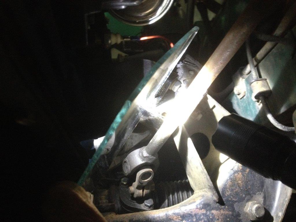

oldmates260z Posted October 9, 2013 Author Posted October 9, 2013 A bit of quick help guys.....the Engineer has picked up that the steering drive shaft is only a few mm away from the engine mount, the photo below is poor but shows it. It looks to me that the style of mount used has a steel U shaped section around it that I think the original 260Z mount does not have and this is causing the problem. Has anyone a photo of an original mount to see if it is different than what I have fitted? The geometry cannot be wrong, all it can be is the mount. Quote
jamo240 Posted October 9, 2013 Posted October 9, 2013 The photo is a bit hard to interpret, but, the standard Z mount does not have the steel U section from memory. If it's too close, either cut it off, or go with a replacement isolator that does not have it. With the right isolator, there is stacks of clearance to the steering shaft. Jamo Quote

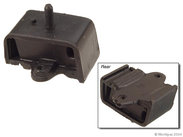

oldmates260z Posted October 9, 2013 Author Posted October 9, 2013 Thanks. I did a Google search for 260Z mounts and the below type keeps coming up. I am guessing they have standardised on this mount for all Zeds while the original one did not have it. Have to see if I can buy an old set from Nissan Quote
jamo240 Posted October 9, 2013 Posted October 9, 2013 It may be possible to re-orient them for more clearance too. The metal wings are essentially there to limit the travel of mount under extreme loads and to control movement in the event the rubber fails altogether. If the clearance can't be remedied by re-orienting, then you can trim the steel wing back to provide the required clearance and not compromise the performance or safety of the mount. Cheers Jamo Quote
Riceburner Posted October 9, 2013 Posted October 9, 2013 They are the same as oem mounts, they also have a dowel on the backing plate to ensure they locate the correct way. The angle on the steering uni looks a little sharp, has the rack rotated fowards a little? This would make the steering shaft higher, making it closer to the engine mount. Quote
oldmates260z Posted October 9, 2013 Author Posted October 9, 2013 That makes a lot of sense if the rack can be incorrectly orientated. The guy has replaced all the bushes and rubbers, may have just incorrectly fitted the rack. Quote
jamo240 Posted October 9, 2013 Posted October 9, 2013 The rack has a bracket that looks like an exhaust u-bolt clamp, but with a bump stop added to it that dictates the radial orientation of the rack...if you want to lay it back a bit, this is the part you adjust to get the angle where you want it. Jamo Quote
