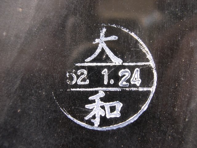

V8Datto Posted August 5, 2009 Share Posted August 5, 2009 Ok I've got one for you, This is the only stamp I could find after removing everything from my Z Any idears? Quote Link to comment Share on other sites More sharing options...
HS30-H Posted August 5, 2009 Share Posted August 5, 2009 Ok I've got one for you, This is the only stamp I could find after removing everything from my Z Any idears? Quality control date for that component is 24th January 1977 ( Showa 52 ), and manufacturer's name is 'Daiwa'. What component did you find it on, and are you sure that it is original to your car? Quote Link to comment Share on other sites More sharing options...
V8Datto Posted August 5, 2009 Share Posted August 5, 2009 ahhh... definitely not original. It's an early 240z, and the stamp was on top of the fuel tank. Thanks for the info Quote Link to comment Share on other sites More sharing options...
