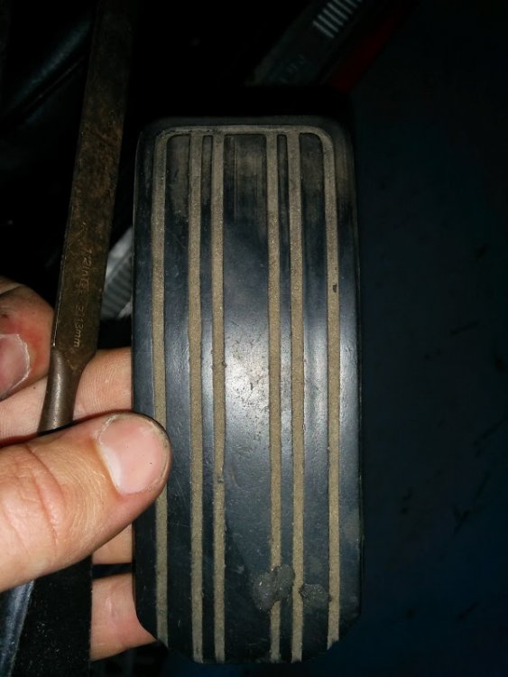

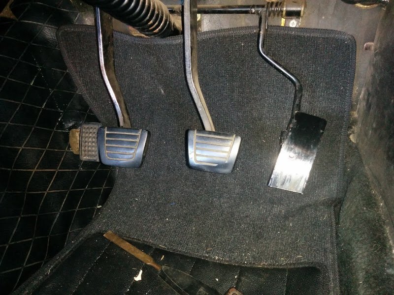

Administrators gav240z Posted January 7, 2016 Administrators Posted January 7, 2016 Hi Guys, At some point in the cars life the floors got a little beat up, and the pedal wouldn't get full range. So someone decided to lob the bottom half of the pedal off.. Photos do the explaining . A few years back I had some rust repair work done on the floors, so now the pedal gets full range but I'm still stuck with a butchered looking pedal. I just put another rubber on it, but the bottom half of the pedal is still missing behind it. It looks like you can remove the accelerator pedal relatively easily without having to remove the entire pedal box under the dash. I'm not sure if 240z/260z is the same, but if anyone has a spare let me know? Quote
Retro Z Posted January 7, 2016 Posted January 7, 2016 I used a 260z 2+2 one on my 73 240z and it fit perfect. I think I may have a spare one, will check on the weekend. Quote
Enzo Posted January 7, 2016 Posted January 7, 2016 Why not just tidy it up with a grinder after removal and trim the rubber to match. I cut the bottom off mine because it was catching on the carpet where it bunched up and I occasionally got caught with a wide open throttle at the wrong time. Now with more clearance it's much safer. David Quote

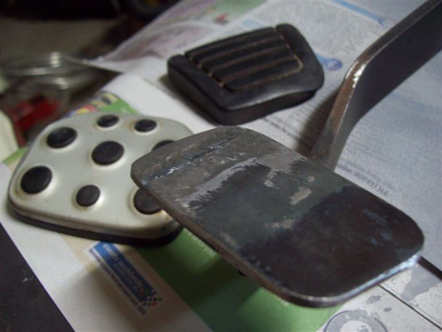

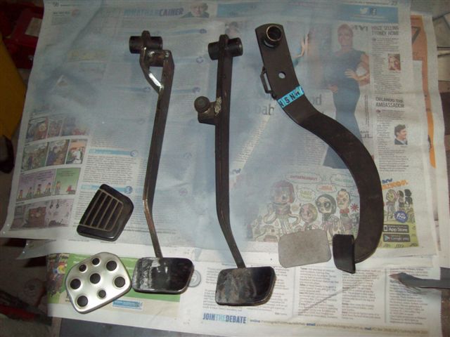

PeterAllen Posted January 17, 2016 Posted January 17, 2016 (edited) Gavin. I widened the pad area on the brake and clutch pedals to accept the Holden rubber pads. You could probably do something similar. Edited January 17, 2016 by PeterAllen Quote

Administrators gav240z Posted January 17, 2016 Author Administrators Posted January 17, 2016 Gavin. I widened the pad area on the brake and clutch pedals to accept the Holden rubber pads. You could probably do something similar. As a last resort I'll do that. It would be far easier to find an uncut 1 however. No but will take a snap in daylight tomorrow. I have held it up to my 240z (manual) pedal and they appear identical (though the comparison was flawed as my pedal is still in the car). Thanks, no rush. I have been told however they are different between 240z/260z. So interested to see your feedback. Quote

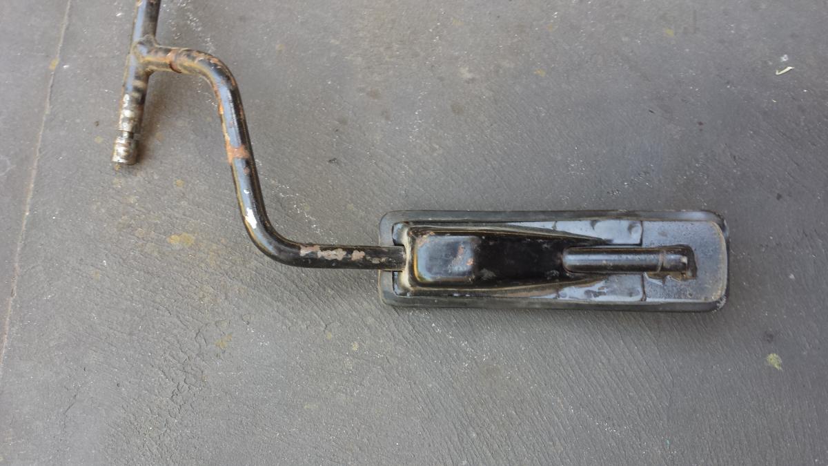

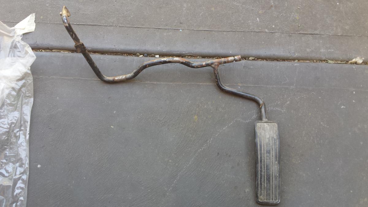

Administrators gav240z Posted January 18, 2016 Author Administrators Posted January 18, 2016 Looks very similar to my 240z 1. I'll grab it if you want to PM me details for payment and post? Thanks. Quote

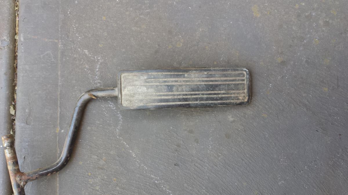

Administrators gav240z Posted January 30, 2016 Author Administrators Posted January 30, 2016 Just a follow up, but that pedal might be an auto pedal, not sure why auto / manual pedal's are different, but here is a picture. Quote

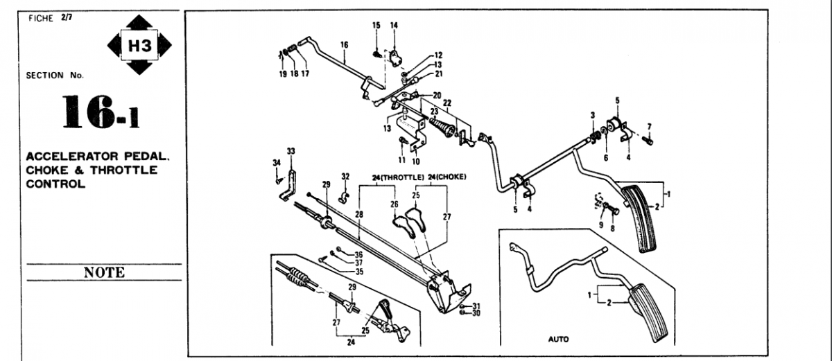

Moderators PB260Z Posted January 30, 2016 Moderators Posted January 30, 2016 The pedal for the auto has a little tab on the rod on the hamd end to activate the kickdown switch. It can be seen in the diagram. Quote
240z71 Posted January 31, 2016 Posted January 31, 2016 Ive got a spare one off a 260z i dont need. It was off a manual car but looks like an auto one from your diamgram. Couldnt you just use an auto one as you wouldnt have the auto kick down thing in a manual car? Quote
Administrators gav240z Posted January 31, 2016 Author Administrators Posted January 31, 2016 Cracker sent me 1, I'll check it out when I'm next in Melbourne to see if it's suitable. I just wanted to follow up on this thread to show the only difference I've found. Nothing worse than threads that have half resolved questions . Quote
Moderators PB260Z Posted January 31, 2016 Moderators Posted January 31, 2016 Ive got a spare one off a 260z i dont need. It was off a manual car but looks like an auto one from your diamgram. Couldnt you just use an auto one as you wouldnt have the auto kick down thing in a manual car? Gidday I would say that you can, I have converted from Auto to Manual (as have countless others) and it would appear that the cars are same, don't really understand why they just didn't fit every car with the auto accelerator pedal ? Quote
