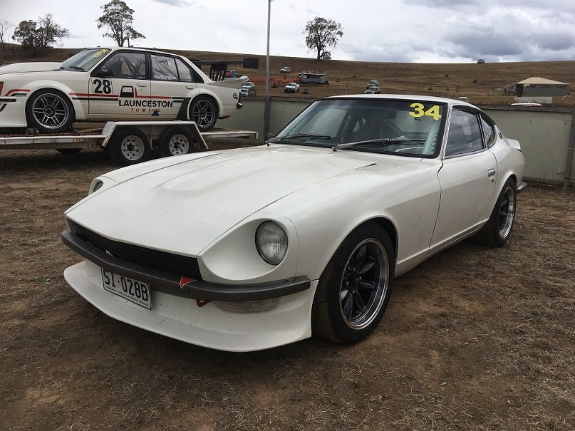

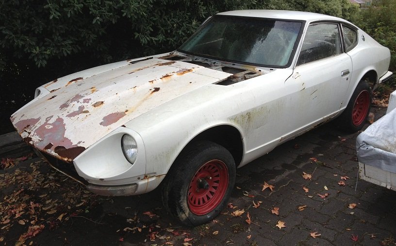

So finished fixing up my car and had a few runs at the track in it over last year. Got it from this: To track ready. It was a bit of work over about 18 months This was earlier in the year. I'm running in regularity and starting out in front so not other cars for a few laps until I catch the back markers. Still some improvement required, both with the car and driving it. The tyres are a limiting factor as I can only fit 225 tyres on it.. I think my quickest time for the day was 60.4 seconds.
