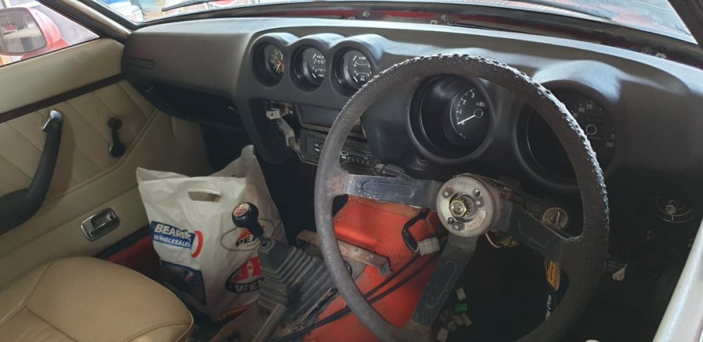

Last couple of things I needed to do before it went for it's road worthy check was install the centre console & change out my shitty 260z steering wheel and replace it with my 240z wheel and also install the borrow air box from a mate as his had already been modified to sit on round top carbs

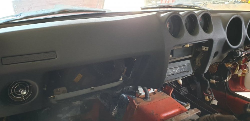

Well this is long overdue, but after 12 months of sitting in my garage, and the car not moving (at all!), and the only progress was getting the dash re-skinned by the Dashboard Doctor, and getting my heater core re-cored, and poorly rebuilding the vacuum heater core, it was time to employ the help of a gentle giant just after Christmas last year........well that turned out to be a small waste of time due to the heater core not sitting in the box correctly with the "end tanks" sitting slightly higher. And as I did not have the tools or space for us to modify the metal holder bracket, this project was shelved again for a couple of months due. So we decided that my small single garage was not the place to get this project re-started! Finally, one Saturday morning in March, with a lot of struggle we loaded the car up on the trailer and got it down to my mates place to get the dash and everything back in, with a view to start getting the car ready for the road. After a long day, we managed to get the dash, with most things working.... So after getting the dash in, we thought we should try and start car (after 16 months without being started, and the old fuel still in the tank)....a little spray of start ya bastard and.....
