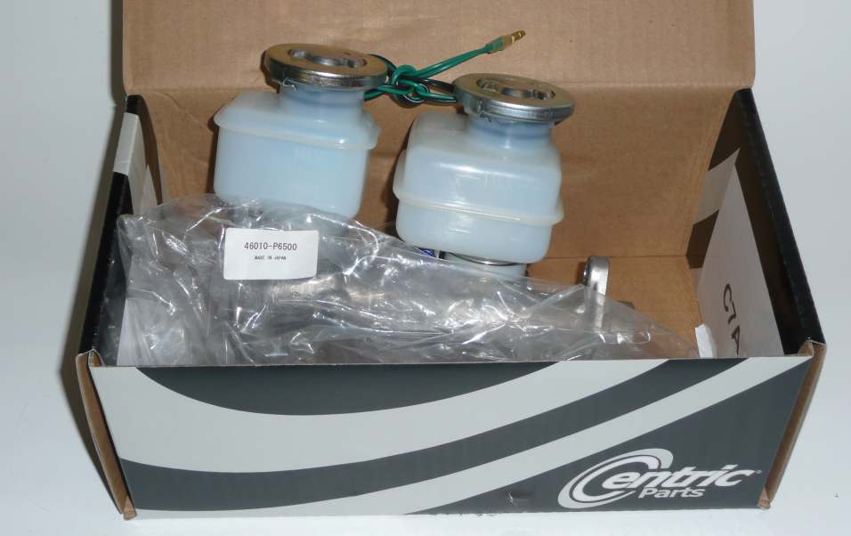

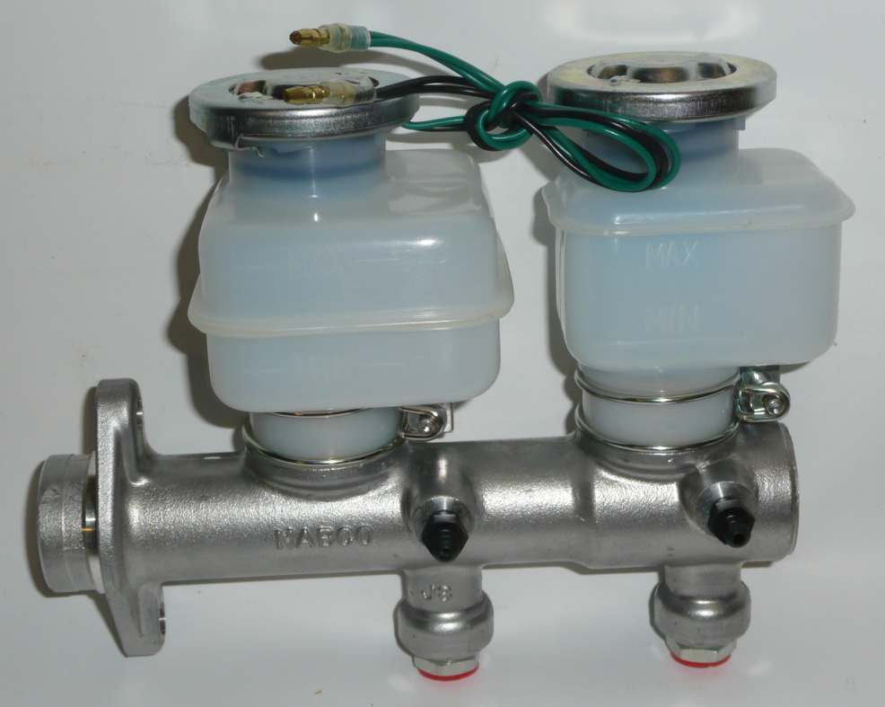

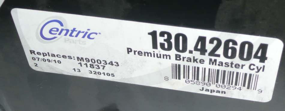

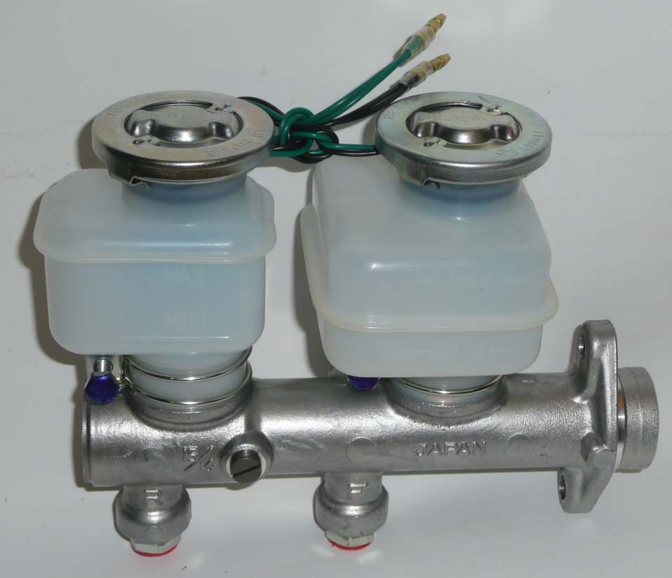

I have received my Brake Master Cylinder from Rock Auto (A$221.64 delivered - as stated previously). It turns out to be made by Nabco and has 'square' reservoirs rather than cylindrical versions as shown in the photo on their website, and included in my earlier post. Ironically, it looks identical to the Dorman brand shown in my original post! Attached are some photos of what I received, including one of the label on the box - showing the part number details. The plastic bag that it was packed in bears a label stating "46010-P6500 Made in Japan".

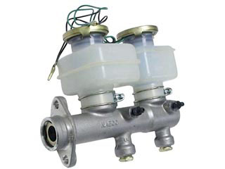

Hi all, I have decided to make this a new topic rather than continuing to tack on to similar ones. Like many others, I want to carry out the infamous Toyota 4 spot front brake upgrade. I have read many, many posts here and on other sites which all recommend using the 15/16" Brake Master Cylinder for a 1979-1981 280ZX. I have also found however that these are not easy to find at what I consider a fair price. In my research I have discovered the (15/16") Dorman 39277 Brake Master Cylinder; http://www.dormanproducts.com/p-4829-m39277.aspx This is a new master cylinder and includes new reservoirs and caps, and is described as being suitable for a 2 seater or 2+2 1977-1978 280Z (Note: Z not ZX!). Rock Auto lists them at Aus$97.69 with postage being A$55.79; http://www.rockauto.com - search for Nissan>1978>280z>Brake/Wheel Hub>Master Cylinder They will actually send 2 for the same postage price of A$55.79 - mini-group buy anyone? Has anyone tried one of these in 240Z or 260Z (or 280ZX!), or know of any reason why this part and this car should not be joined together in... (you get the idea)? - Ian
