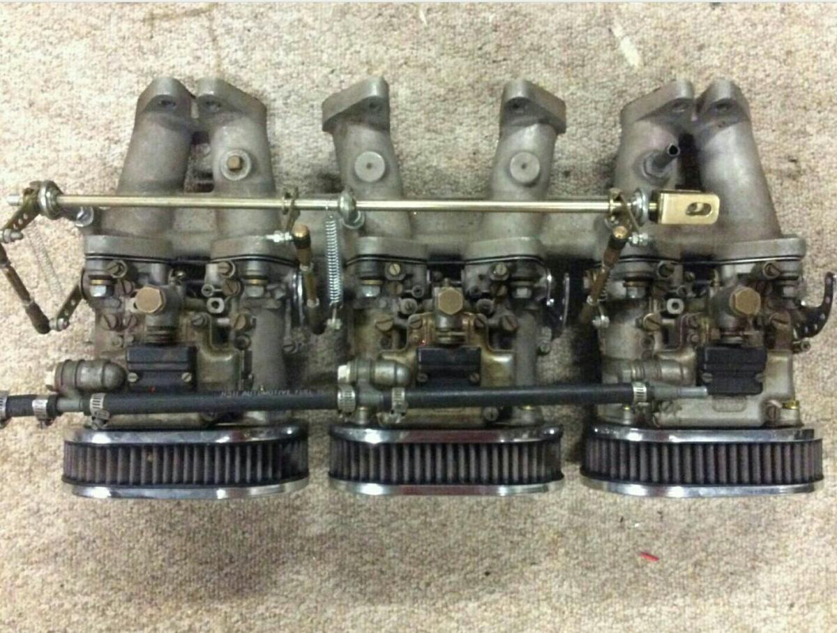

[Sold] Mikuni Solex 50Phh Carburetors & Kameari Manifold
drifta1600 replied to C.A.R.'s topic in Parts and Tools for Sale
Realy?? Wow. Wouldnt you just got with the tripple style efi set? Be way less than that.. and better than a carb. -

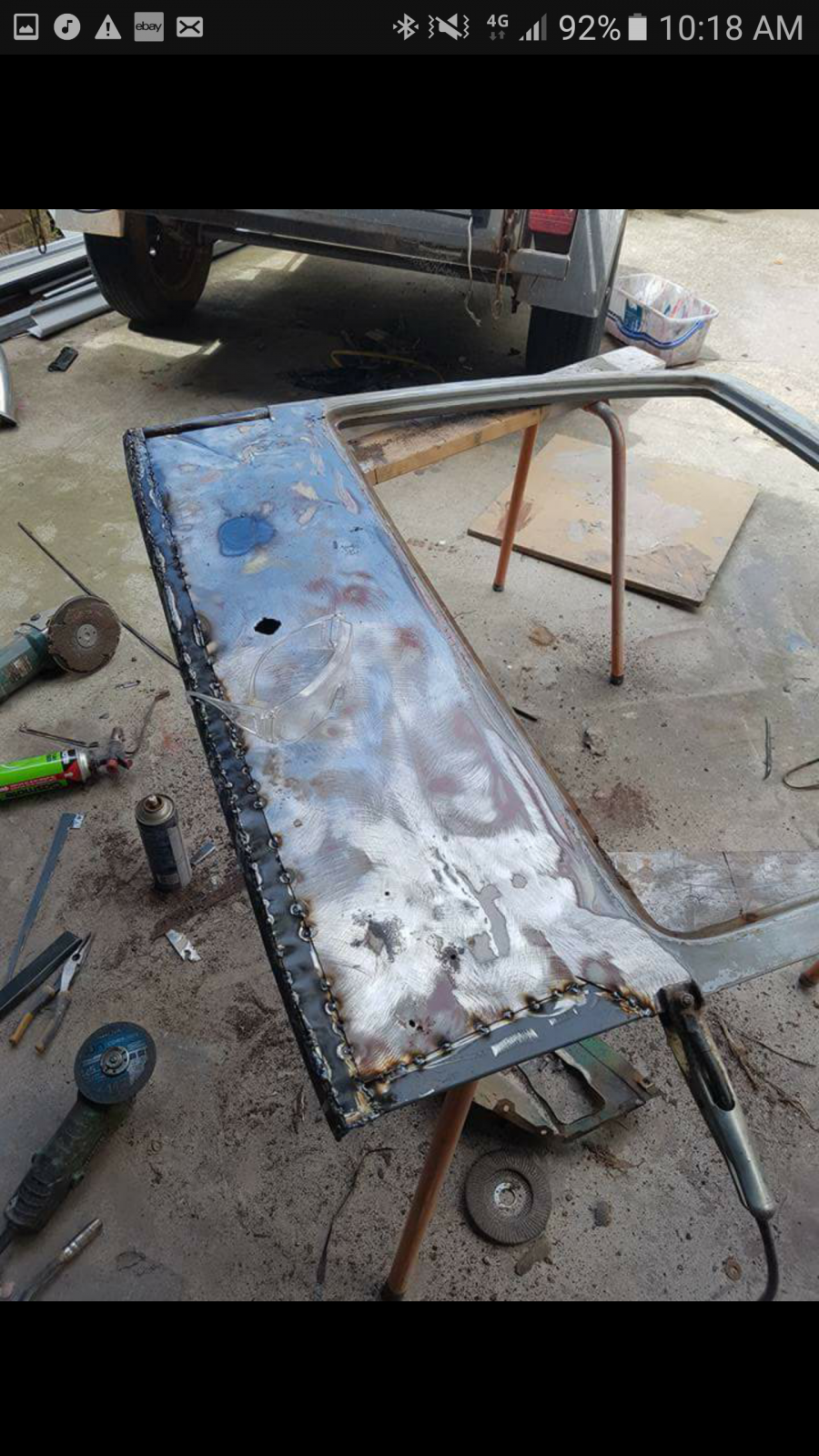

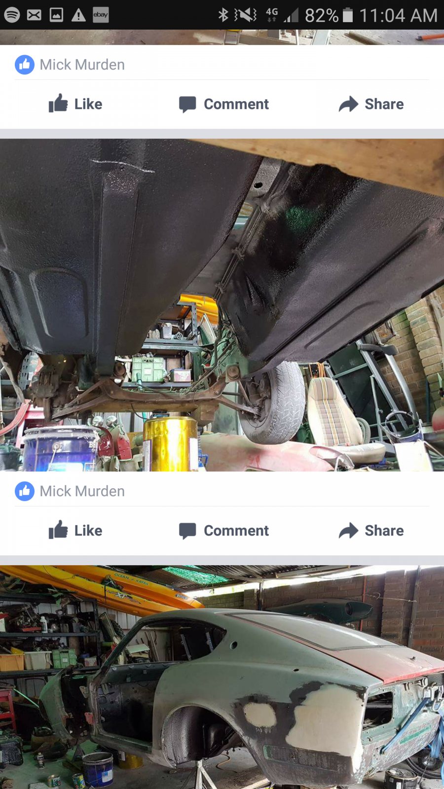

No distortion as the lip was double skinned and tacked on first. Then the top skin was tacked on at random points to minimize the heat. And yes.. and weld/patch work need a layer of filler... ideally id buy a brand new hatch.. but cant find them. Also would buy new doors and new gaurds.. but cant find them/get them in Australia unfortunately. In trying to organised heaps for parts from the usa in container. -

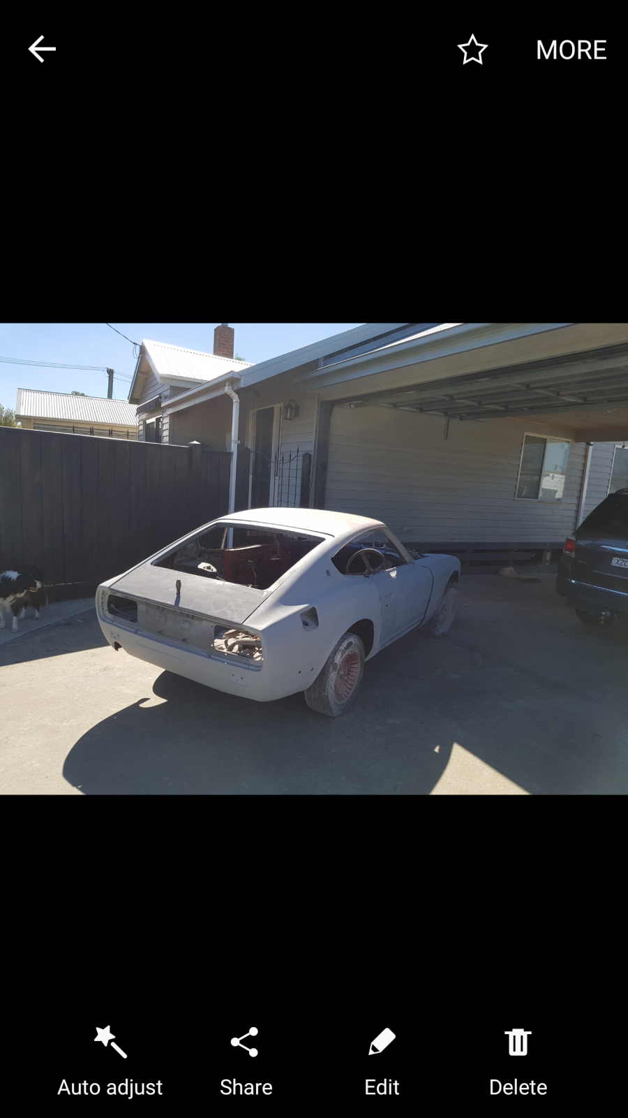

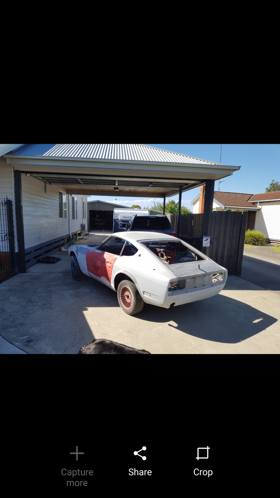

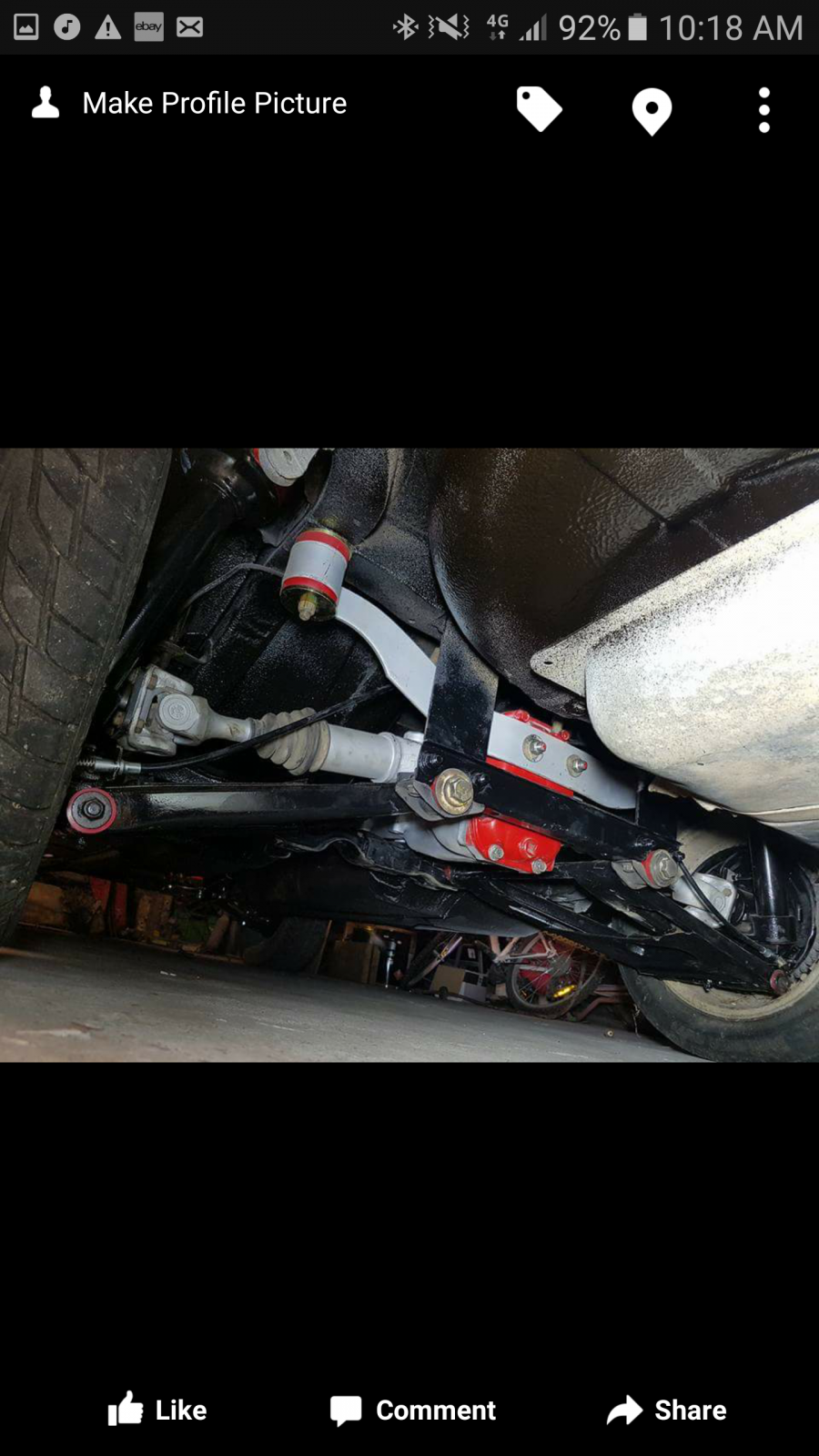

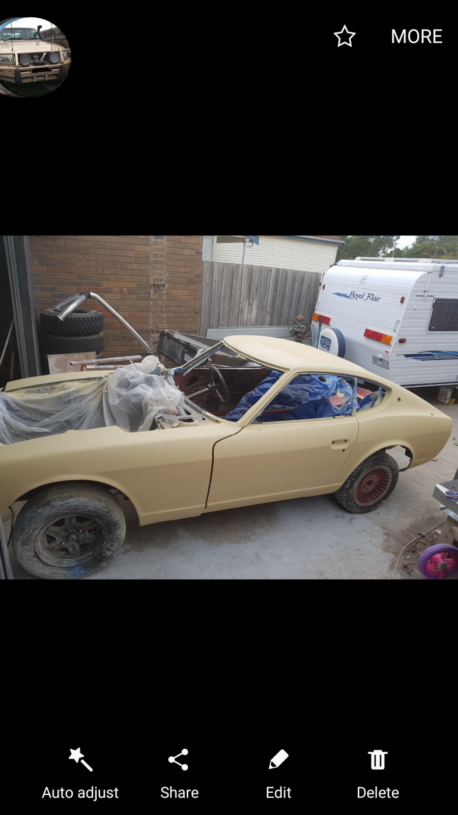

A few update pics. Just over 3 months now.. with a few holidays in between. New shocks Bushes every were New brake pad, seals, shoes, slaves New brake booster New clutch m&s New steering column bearing Not much thats not new now. Hopefully in another couple of months shes registered. :-) -
