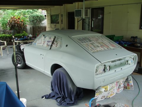

  12. All primed ready for rub down a second time than hope to apply top coat next weekend.

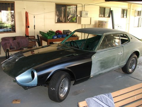

  17. Hi Rev, I am following directions from another site as to painting a car. I will lay a mist coat of flat black on top of primer tomorrow and rub that back then if all goes well I will top coat. An old mate of mine has give me some tips and I know it's a lot of work but he achieved good results with acrylic paint. I don' t want to upset the neighbours as you can see where I am painting from my pics. The guy next door has a Merc and I don't want to have fix that from fallout from 2 pac paint. As it is I stilll have to prime the inside of the guards and probably would be best to paint them on the car. Still have the bonnet to rub back but find it difficult to paint horizontally. Maybe I should use a step ladder. What do you think.

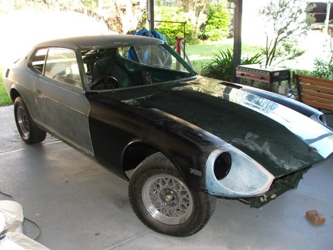

  18. Got the primer on today. Now all the hard works starts.
  19. Starting to look like a car again. Well it's out the back for me and some more rubbing down to do.
  20. Nothing flash here mate. All is standard with new shocks etc.
  21. All 280 Z 's must have gone to FNQ
  22. Thanks Rev. Picked up primer from MPA Refinish Supplies today and these guys are very helpfull in advising me what steps to take. They are only too helpfull in mixing the paint I want and will match it. They mainly do work for trade and are also agent for POR 15. That is how I found them. The rest is up to me as a pro job is just out of reach of my budget. With the help from the guy up above it will tuirn out alright from a distance. Troncy.

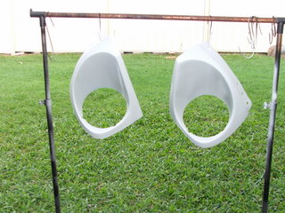

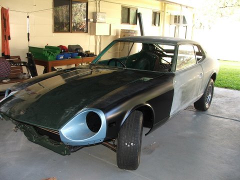

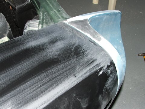

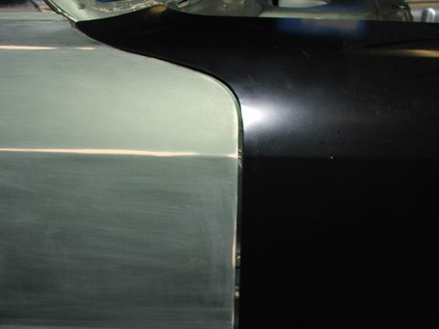

  23. What a job, Have fitted new guards and light pods. Found the right hand side one had been filled with bog as it was very proud to the guard. Was just about to fill the guard with bog then decided to rub the pod and found heeps of bog. Check out the pics and now the gaps are great. All I have to do now is gap the doors and start to paint. This is going to be the most frighting part. Will let you know how it turns out.

  25. Guards were nissan parts. A few ripples on one guard but that is this how any new panels turn up. The usual gap fitting must be done but I am happy with what I got having seen new panels on other cars at the work shop. Shaun and Steve turned up today to pick up my old guards and it was great to have a chat with a couple of nice young fellows. Got rid of old guards and picked up a brand new petrol pump. Thanks Shaun.
