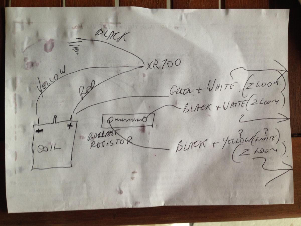

  4. I have the standard 1975 Datsun tach. My mates 76Z is wired the same as Enzo's. As far as I can see my wiring is normal as if you change the wires about they don't reach their terminals. The 5v on the coil- is the worring point as my mate has 9.6 on coil plus and 8.4 on coil - with engine running. Maybe I should not worry as engine goes OK the way it is.
  5. Hi David, If I wire as per your car, my Tacho doesn't work but car still runs. Readings as per my way as follows with motor running. B/W in rest 14v B/W out rest 8v - coil Y 5v +coil R/GW 8v Resistor is very,very hot. is this normal? Peter.

  7. You may have missed the point. I am looking to see if I have the XR700 wired correctly. See mud map below. Is this how your XR700 is wired up if you are running one of them.

  9. I don't have any issues with the XR700 except it died after about 6 years. I have purchased a new XR700 and the car goes again and revs out quite well. As far as I want to take it anyway My car is a 75 2+2 and I have the unit wired up as per the following mud map if you can follow it. The question I have is this the same as other people have their units wired up. It is not as per instructions but is the only way the car will run. Again how does this compare. Cheers Peter.
  10. Hi David, yes mate I use the ballast resistor and a Bosh GT40R coil. Has never given me any trouble but the other week it just died. I have ordered a spare unit to shove in the glove box. The optical pick up in the dissy is still ok so I will have a complete spare unit. Peter T.

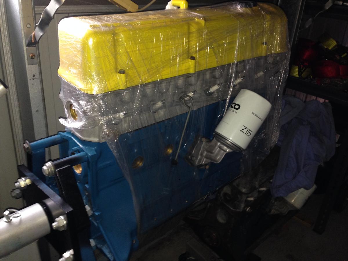

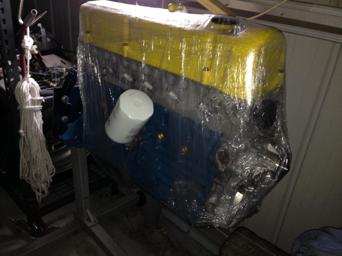

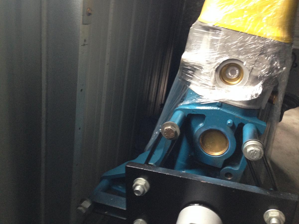

  16. That's fair enough. I thought the word refurbished would explain that this was a standard engine as I listed all the new bits that were used in this endeavour. Go to my build thread for more pics of this engine being built. Page 20. Link is the blue writing down the bottom.
