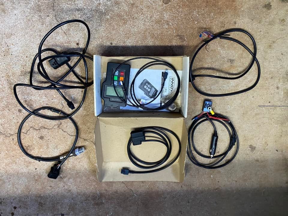

Selling my used LM2 single WBO2 sensor data logger. Comes with OBD2 cable and spare extended weld in bung. I previously used this for data logging and tuning my SU carbs and my Megasuirt MS3X on unleaded pump fuel. The power supply has been modified for a permanent install and the original socket plug is included in sale. $350 ono. Located in SE QLD and can post at buyers expense.

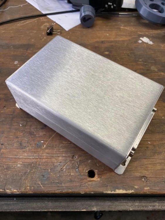

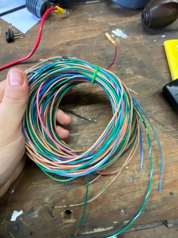

I'm selling my faithful MS3X on V3.0 board with knock module for $500.00 ONO. Located in SE QLD. I can post at buyers expense. The ECU was wired and configured for sequential fuel and direct ignition coil drive for a distributor based ignition with two WBO2 inputs on my L28 stroker. The distributor driver is a BIP373 ignition driver internally triggered by Spark A from the MS3X. It comes with remaining unused wires for harness kit, the two DB connectors and as much of the custom harness wires (no sensor or actuator connectors) that I can salvage. Reason for selling is I was able to obtain an Emtron ECU at a good price.

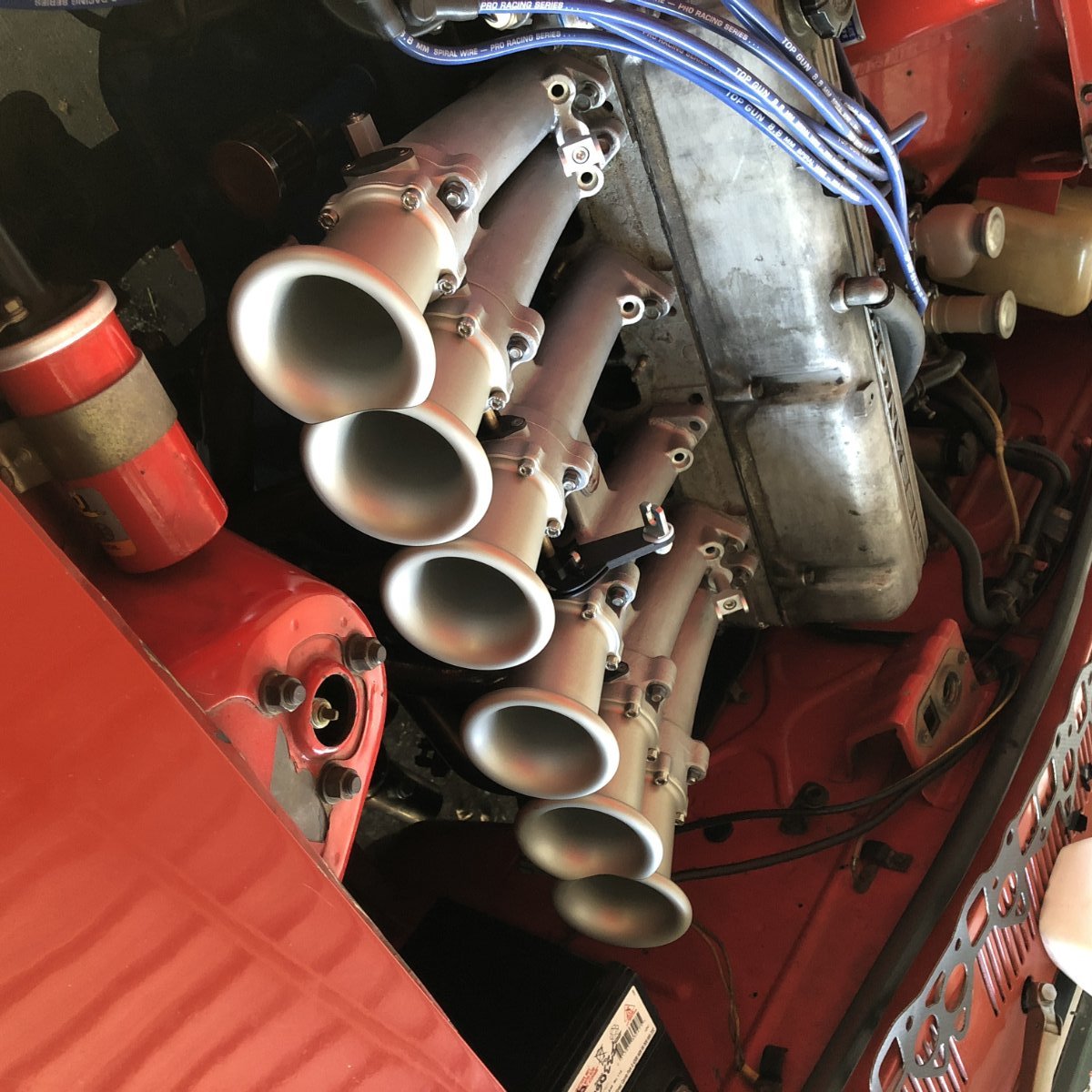

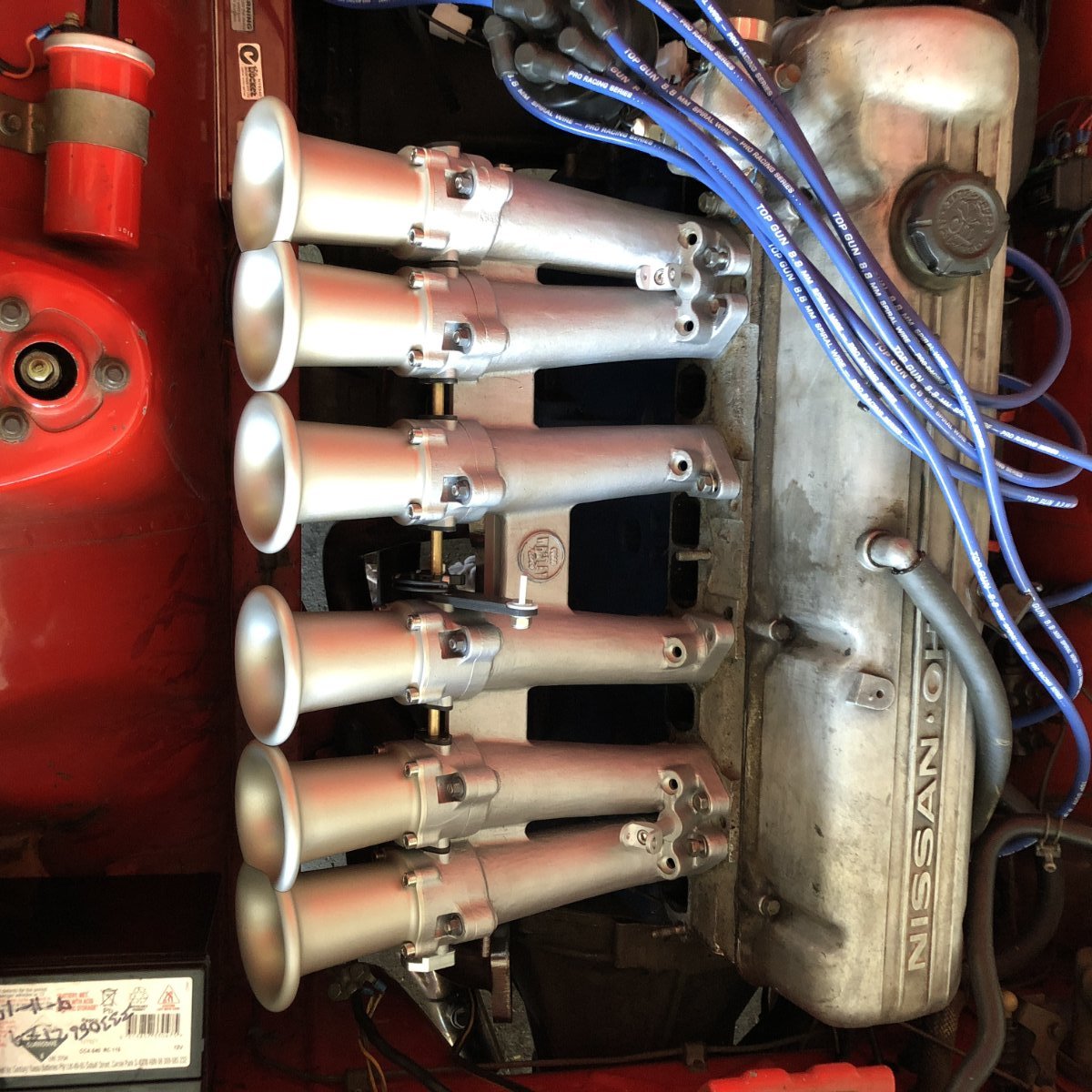

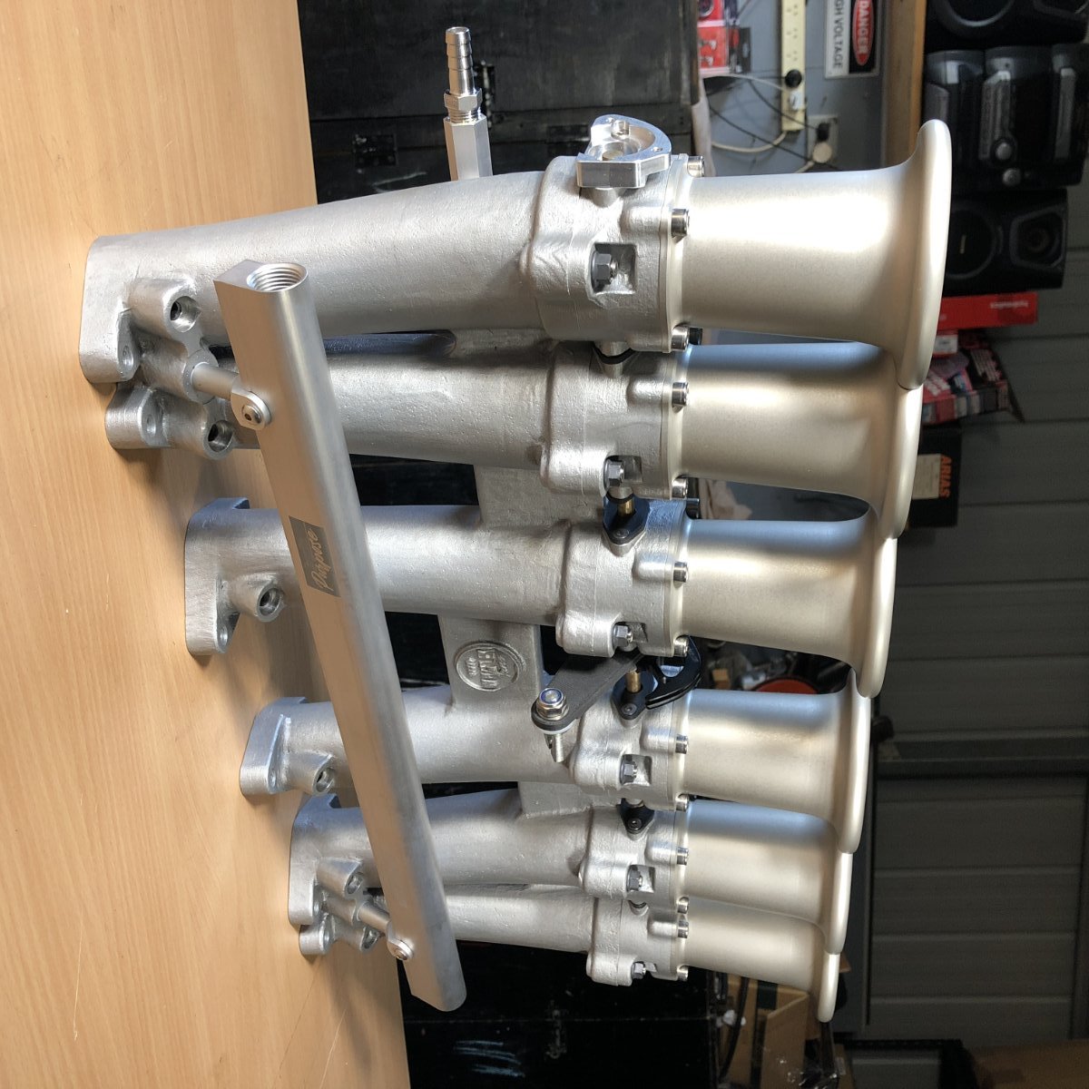

Hey guys. The ITB manifold has arrived from Whitleytune. It's a mad bit of kit. I will just leave not safe for work photos here for now..... If you want to see the youtube update use the link in my the signature- 115 replies

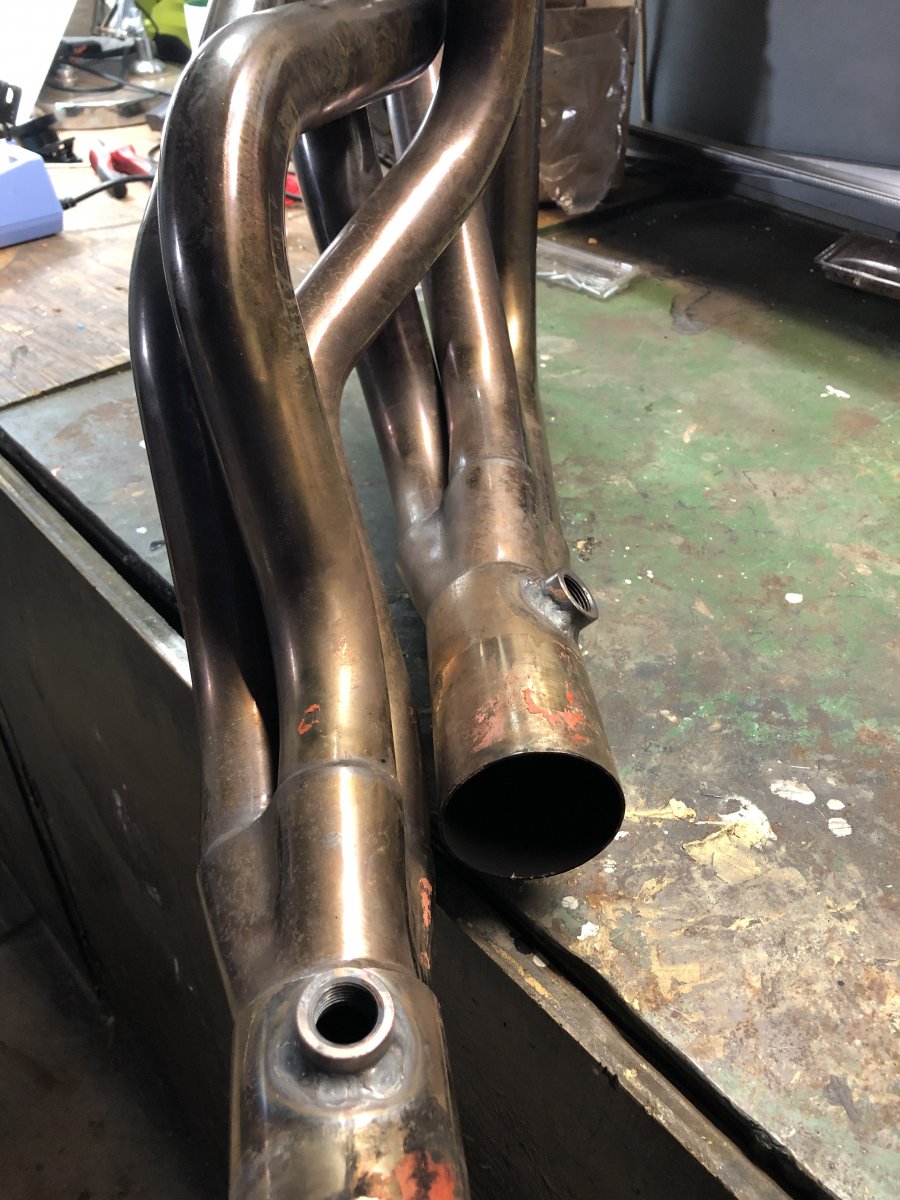

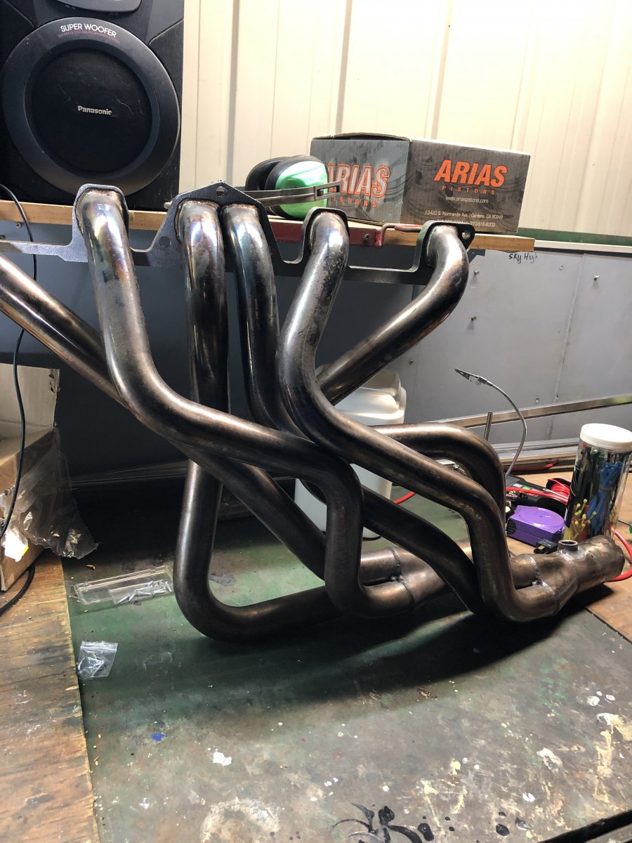

A little more has happened with the EFI build. Dual lambda sensors is what! I had planned to run dual lambda sensors on the Hitachi SU carbs if I had not the opportunity to work with Whitley Tune and the sport injection setup. The goal now is two injector banks with target AFR maps. I run a Zstory 6-2-1 header and I decided to locate the sensors at the collector of the primaries to mitigate the risk of air contamination through a joint. Its probably overkill but it seems sensible to have the most accurate reading possible if I’m trying to have the most accuracy target AFR map for two banks of injectors the MS1 V3 allows me to have. Cylinder 4-6 location was easy! The collector is located in the space between the gearbox and transmission tunnel. This one was near vertical which is the optimum orientation. Cylingders 1-3 collector is tucked in behind anything and I could to find an orientation that I was happen with to manage heat for the sensor and the wiring so I located on the side of the collector. The sensor and wiring is just in front of the gearbox in the space behind the sump. Its not completely horizontal but I’m confident its still in a good location. Innovate Motorsports recommend 24” from exhaust and these are about 35”. I’ve had an LM-2 for more than ten years and I plan to install a DLG-1 if it ever gets here (understandable shipping delay). Matt welded these bad boys in (MYS30 build). I am in his debt . Cheers guys!- 115 replies

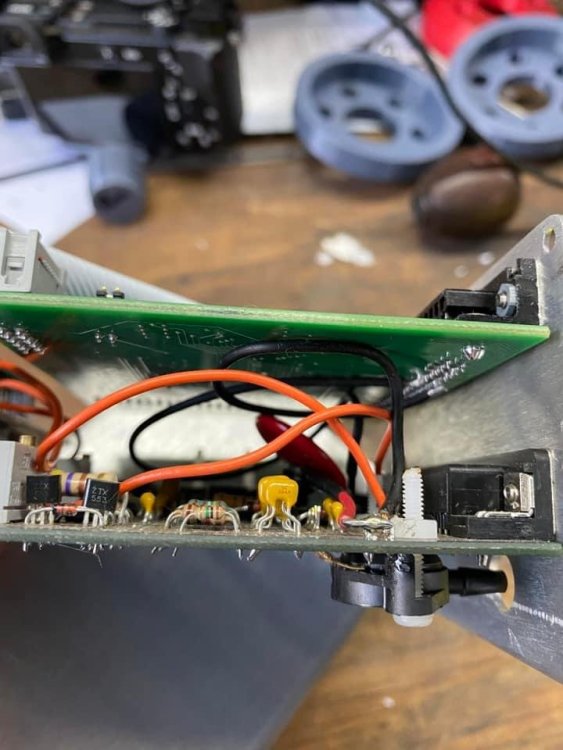

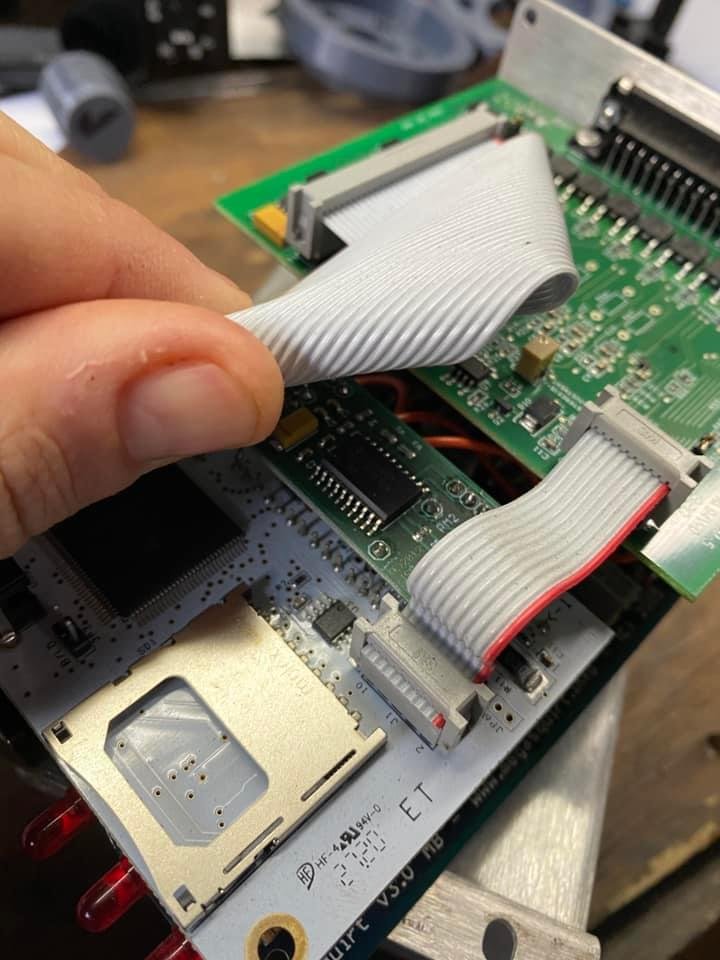

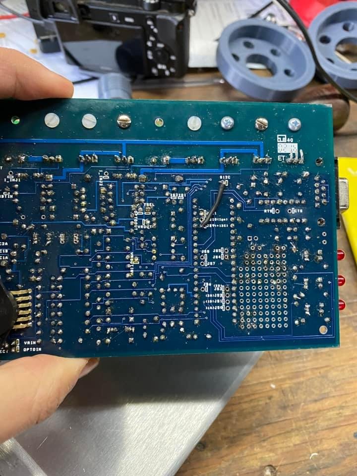

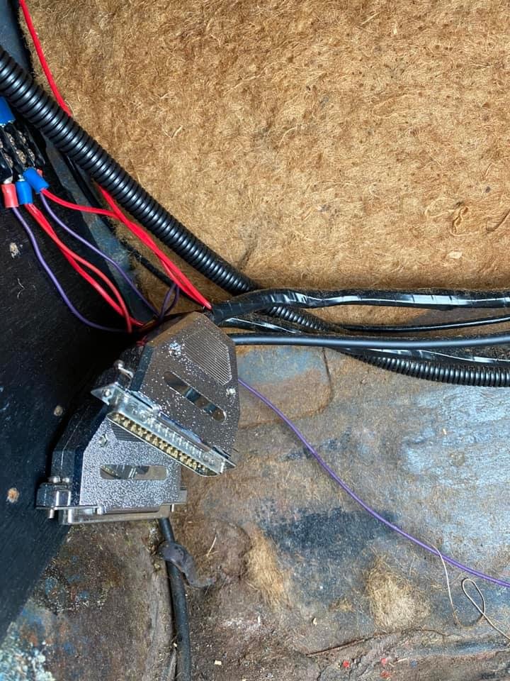

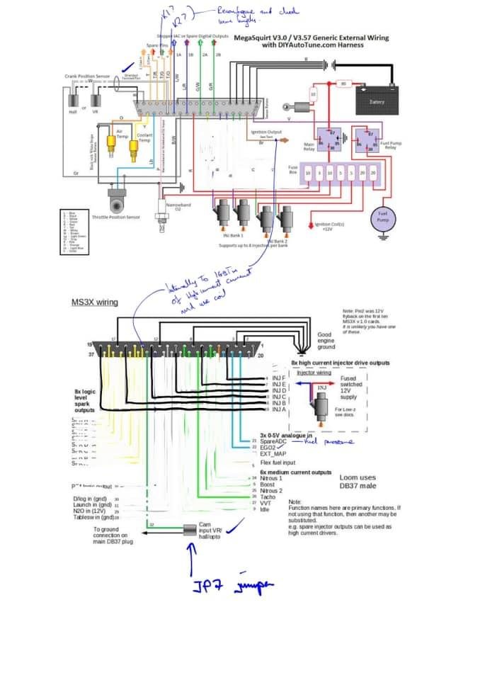

Time for some Megasquirt ECU mods! I had configured the MS1 V3 board for ignition only. Some additional work and mods are needed to make it fully armed and operational for EFI. In the process I broke a leg off one of the current resisting devices for the injector banks I will have to buy new ones from DIYautotune as they are hard to get with the hole to mount on the heatsink. Thats really all that is left to complete on the ECU. In summary I've added: second WBO2 sensor input second Nissan optical trigger input fan relay control 2 wire IAC control shifted the launch control input 5V tach output There isn't many standard configurable pins left in the DB37 harness now.....- 115 replies

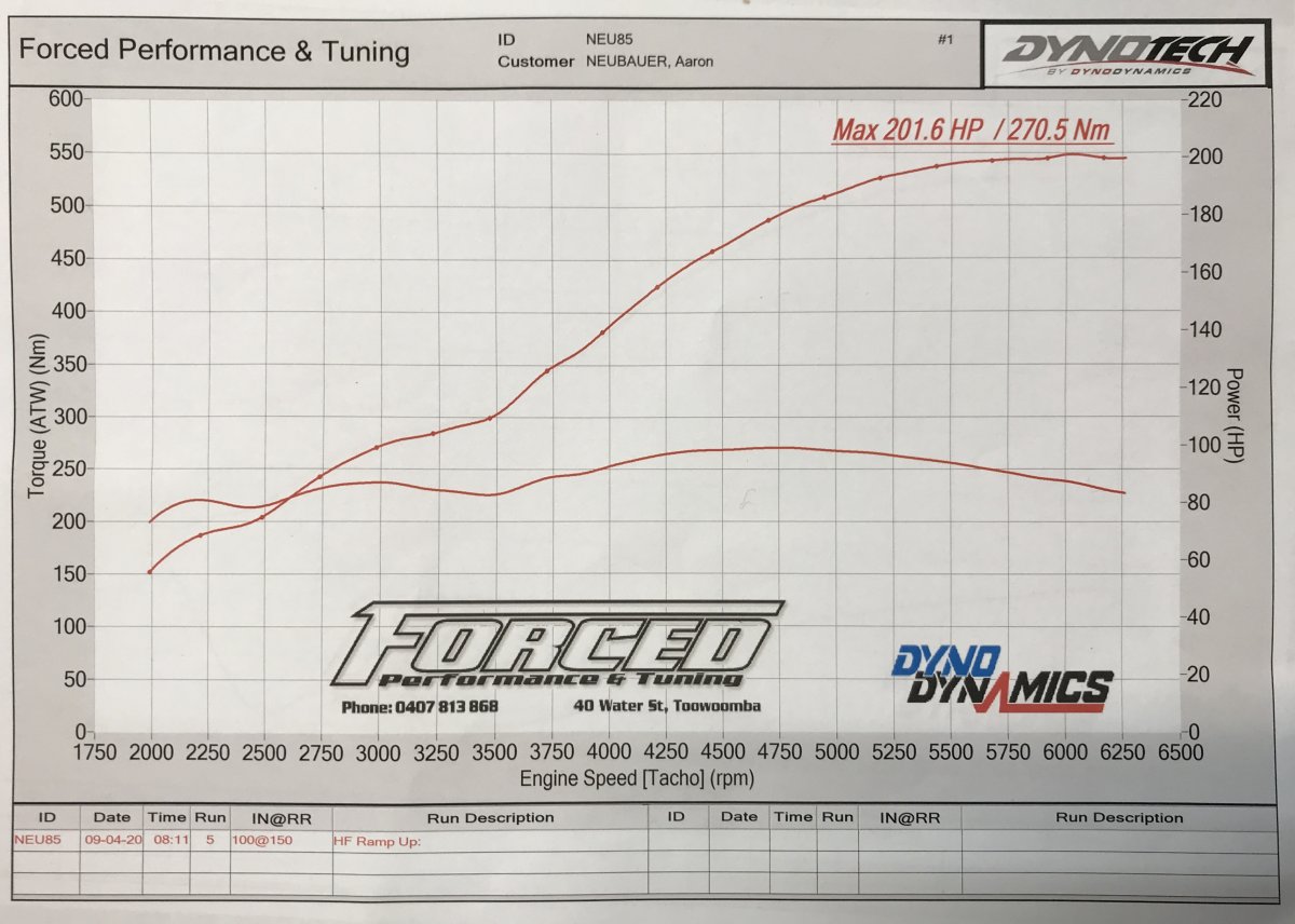

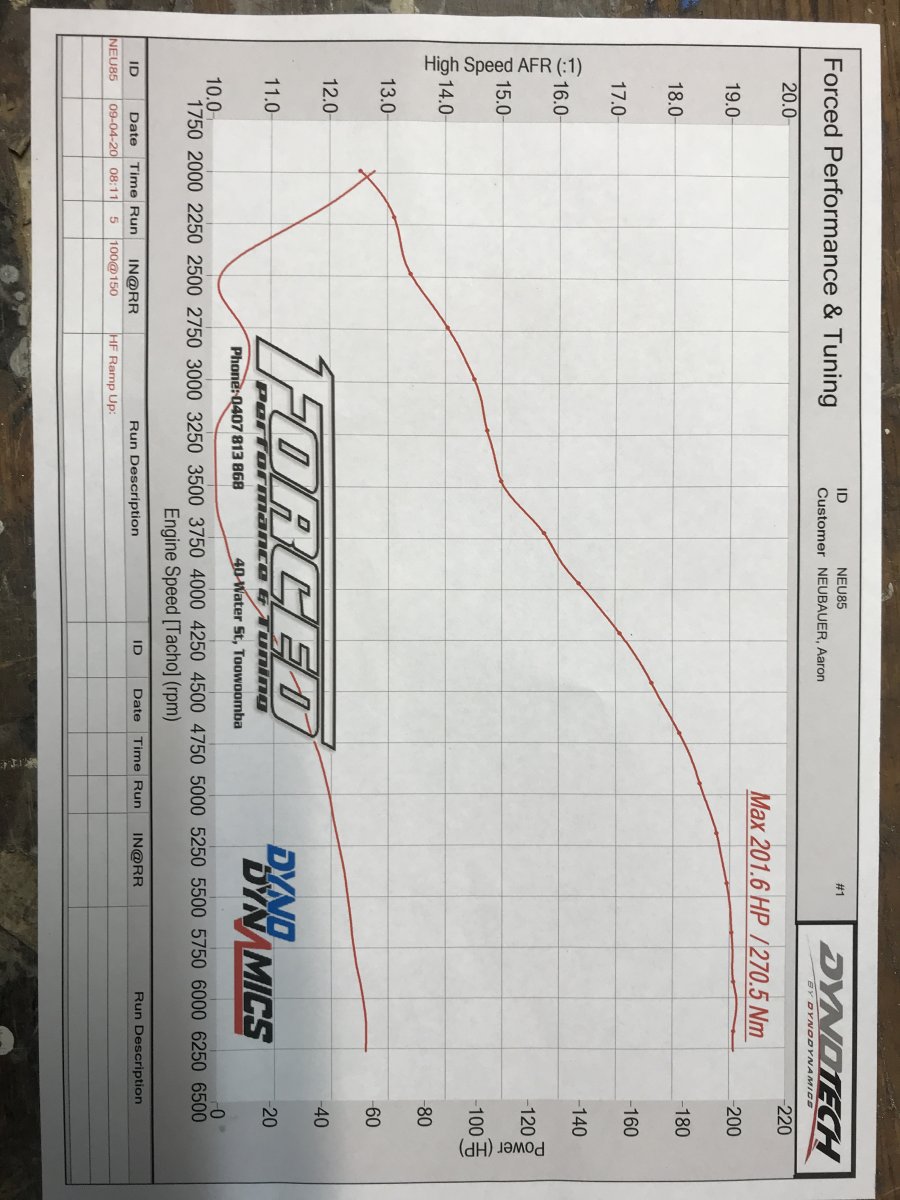

So, stock 4 screw round tops can support at least 201.6rwhp. There may be some debate over how the dyno calculates hp but there is a decent increase from the last dyno in hp and torque from essentially a tune to the fuel and ignition. Tune is super rich which could be fixed with different needles like TF but I wanted to get a run in in case QLD requires a lock down to manage the pandemic. I’m super chuffed. When I set out to home build the L28 stroker motor all I wanted as 200RWHP with triple Webers. I think I said that years ago in this build log in fact! To think I could achieve that with the standard carbs is amazing! I’ve attached the 2017 dyno sheet and the 2020 sheet. I can now get back to the ITB EFI swap knowing that it is likely to only make more power!- 115 replies

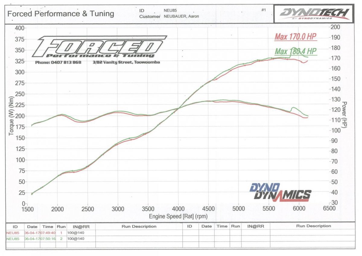

Dyno day! Round tops are back on. Its off to visit the same dynometer I ran back in 2017 for a complete comparison. The car made 170rwhp then. I hope the fixed exhaust, programmable ignition and tuned carbs will make an increase. If I go backwards I will be a sad panda. Results TBA....- 115 replies

I hope you are all well considering the state of things. Time to see if the ITB setup will fit! Whitley Tune has sent me a 3D printed runner, ITB and trumpet of cylinder 6 to test in the engine. Cylinder 6 was identified as the critical runner in a RHD drive car and it turned out to be. I use the stock battery and I’ll either relocate the battery or change to a smaller more efficient battery. There is about 10mm between the bottom lip of the trumpet and the battery. That’ll affect the performance of cylinder 6. I’m not sure that I will be able dyno the twin SU setup without holding up the EFI build with everything going on. We will have to see. Link to Whitley Tune’s information doc: https://uploads-ssl.webflow.com/5bad6feacfdca44aacb6ee99/5e76ba431ede366a96b6d8ae_WT Sports Injection.pdf- 115 replies
