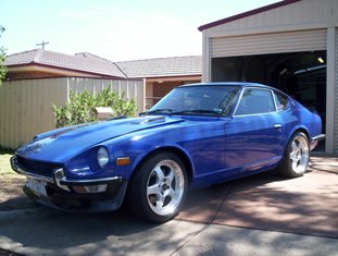

  8. Thinking about selling my pride and joy? Just wondering if there is interest out there? Blue 1977 260z Brand new 390hp hot cam crate motor, twin gas research. Upgraded brakes, adjustable suspension, 5 speed manual. Can send pics if interested. Fully engineered. Have wanted a caterham for years and am finally doing something about it. Cheers Graeme

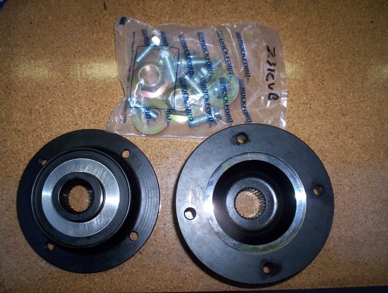

  9. http://www.modern-motorsports.com/catalog/product_info.php?cPath=32&products_id=46 Try this, but before you buy make sure you can get the shafts. I hunted for a while to get mine and not cheap. Ross is short of them in his area too. PS my car is in his rides section also. Cheers Graeme Burke

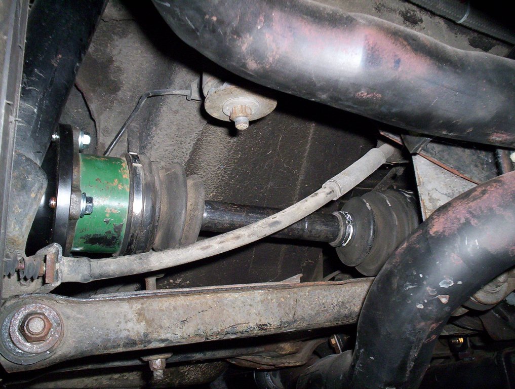

  10. I just flipped the cage, as you say its only 2mm to stop any binding.
  11. By the look of my photos i need to get a hoist and clean up under my poor old Z.
  12. $420 but there was a stuff up with freight at his end and he refunded the $100 postage. Pricey i know but very well made and never had a breakage as far as i know. So $320 landed. Thats just for the flanges, you will need to source the cv shafts which are rare as hens teeth here. Add another $400 for the shafts and more in labour if you cant shorten them yourself. Easy to shorten them saves some cash anyway. Total cv shaft conversion cost me $800

  14. Its a great conversion. Very easy to do too. Much less vibration from the rear end now!
  15. Hi all, finally got my 300zx turbo cv shafts fitted with adapters from Ross at Modern Motorsport. Wow he sells quality products. Very impressed indeed.
  16. I just fried my halfshaft uni's for the third time, so i am converting to CV shafts. Will let you know what i think when i finally get my billet flanges from Modern Motorsports.
