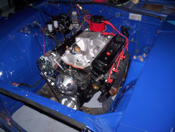

  9. A few more pics, and off to the dyno on monday!!!
  10. Very nice clean install there!!! I am seriously looking at those seats now, they look trick. I see what you mean about the GR single carb, but a 550cfm should be sweet for 300 hp no probs.(Not that im an expert by any means). I will scan some progress pics of when i put the tank in, its pretty tight up the back and the exhaust fits fine, i am running twins to the diff then single 3" out the back but am changing to twin the whole way but major fabrication will be needed to do it right. Ill do a hunt for the pics and get back to you. Graedat

  21. Hi Van, its a 350 chev. brand new crate motor, roller cam and lifters with roller rockers, single plane manifold. I am running twin gas research on it.
