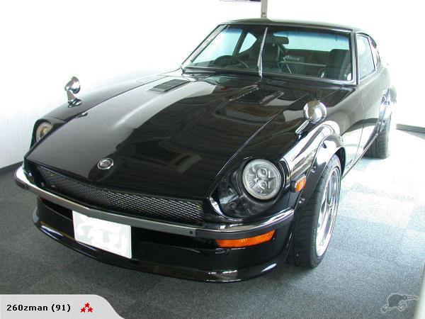

  24. I saw these fender mirrors imported from Japan for sale in NZ what do you think of the look I think they are awsome! Lynton
