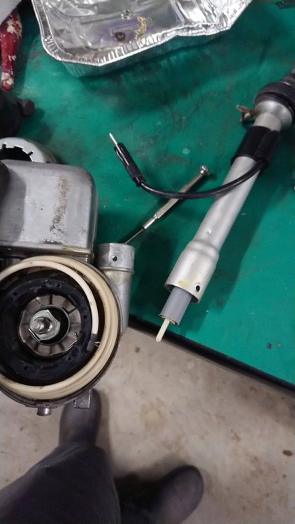

  1. Not sure what year your antenna is - but mine was a 'pointy tip' one. The antenna tip actually screwed off (which saved me from breaking it but meant that I was paranoid about it 'disappearing' in the shed (despite being labelled and in a zip lock!). This then lets you slip the final piece of the mast out. The upper sections of the mast were a pain in the neck as they are fragile but I don't appear to have destroyed it. Would be interested if you know of any source for the 'finger washer' as mine is unwell (useable...barely). Correct me if I am wrong but does it function to improve the ground for the mast? Shortly to do a rubber part order to finish this job and will then turn to the original radio. Although, I am in two minds - if I recall right it still has the original chalk marks - so I don't want to clean them off - but I do want to make sure it works. H

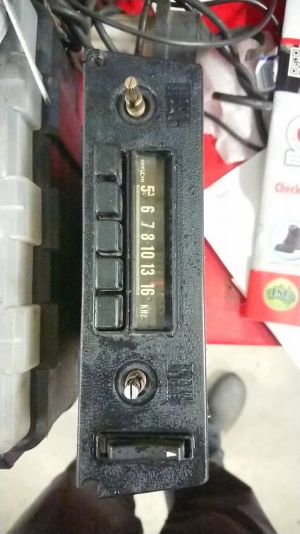

  5. If no one has answered re chalk inscription, it says o-suto no.1, which I assume is shorthand for Australia No.1 (オーストラリア). I have similar chalk marks on the radio from my car.

  11. Revisited this recently with the line trimmer. Will see how it works. still need to service the motor and. Heck gears. antenna mast was a pain. The brass connector that joins the final metal road and the plastic extender coil is a tight fit and wouldn’t go back in. Had to clean and lightly sand to get back in. I will be buying the rubber bits from 240zrubber parts. H

  14. Gav, Going through the same exercise. Have just got antenna all apart all that remains is to: - use the trimmer line to replace my broken plastic reel; - replace (if possible) the broken rubber's on top (possible via rubber parts site) and decide whether the 'fingered' washer/nut needs replacing (as only has 3/4 of the fingers). Interested if there is any excess of parts. Huw

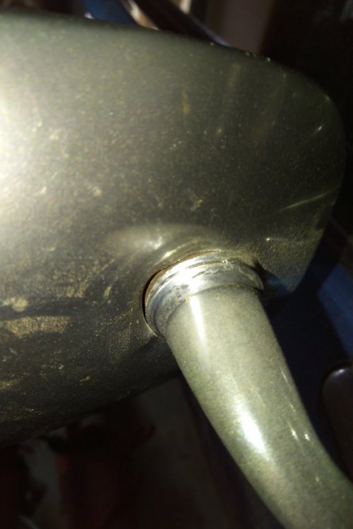

    An plan B if unobtainium would be to find someone who can repair. What has happened is the join between the ball (that links to stem) on the mirror and the body of the mirror has split. Quite thin metal so beyond my ability to repair. Thoughts?

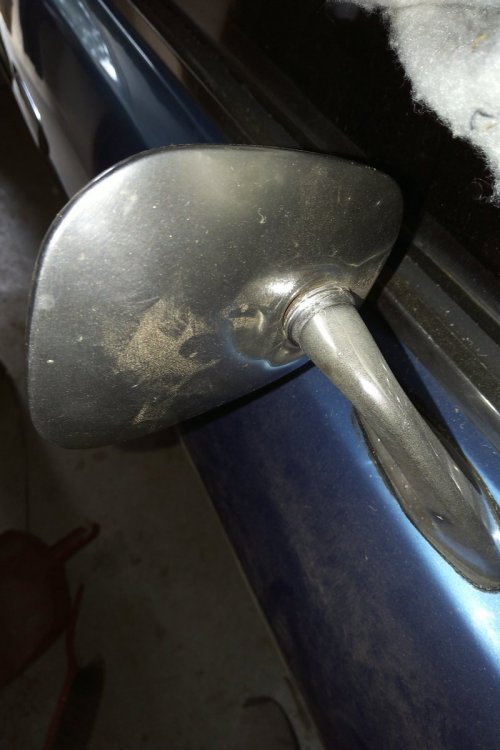

    Hi all Finally got round to digging zed (71 240 Z ) out of shed and trying to give it some attention. Noticed that someone had clean hit my driver side mirror. Does anyone have the Nissan part number? (Or microfiche so I can look it up) I suspect Nissan don’t have and I will need to source from Japan but thought it worth a try.... Huw Watkins

  25. Hi all Working through some old bits and decided to fix up my 71 radio and install the original antenna. The only issue is that the little plastic coil on inside of aerial is broken. Does anyone have a source for these? There was a part kit but discontinued by the look of things (27350-e4125). Also, will be asking some plastic welding question for radio faceplate because one of the corners is going. Interesting piece of trivia, my radio unit wad marked in white chalk with オースト, which would seem to be factory abbreviation for オーストラリア (Australia). Surprised the markings survived. Huw
