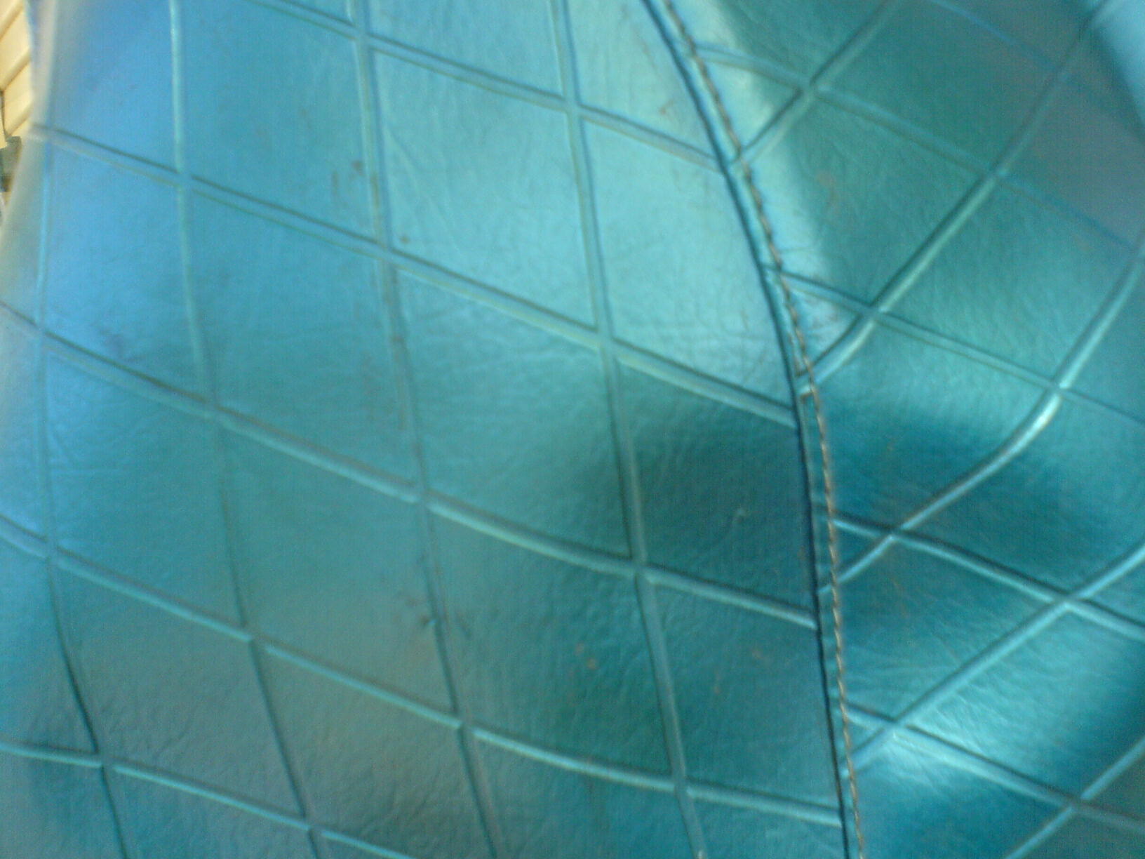

    some pics, couldn't be bothered with a new thread and couldn't get into upload into my gallery (gav help! computer illiterate here) taken with my phone, so forgive the quality, will have better ones soon. huw
  23. dunno if this is what you were asking for jp, but here's a quick shot... was gettting all my parts out for assembly (yay!) don't have any shots of the interior in a car, but i think one of either zcar.com or classiczcars had one about 6 months back (so impossible to find now without trawling through it all). Huw
