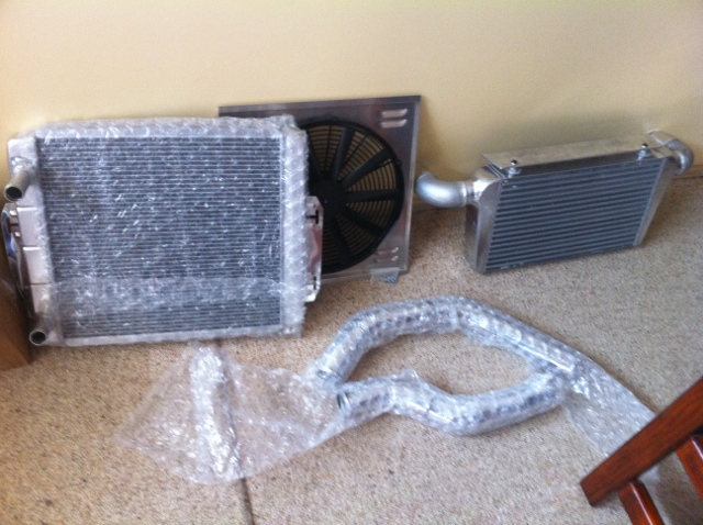

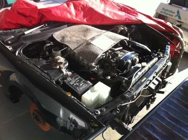

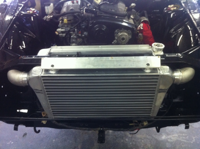

I also bought the Rb engine and mount set from Mckinney Motorsports, along with race 4 core radiator + fan + shroud, large intercooler, exhaust components, rb to r200 tailshaft. It was all pretty good stuff and arrived quickly. Was lucky to get a 200zr rear sump which needed modifying as it sat so low. We then started stripping out the old L series and prepped the engine bay for new paint and the install...

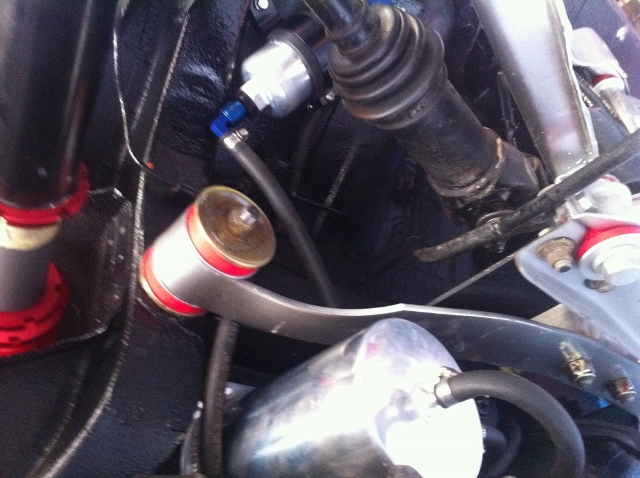

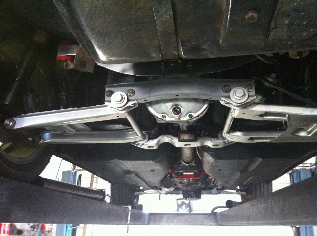

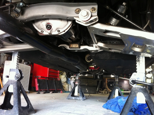

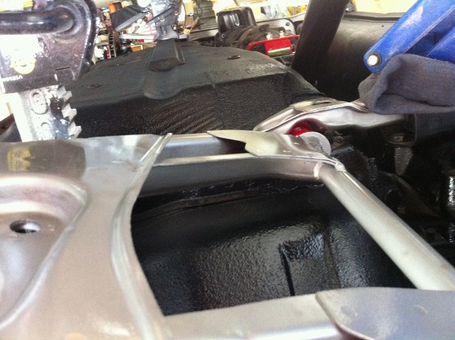

Along with buying endless parts for the swap, I picked up poly bush kit (complete), r200 3.9 diff, r200 moustace bar + traverse link. We scrapped the diff strap and went for a solid race mount from SW Motorsport. It was then off with some front end panels, and all drivetrain gear to prep engine bay/underside of panels and floor for bitumen spray and rest prevention. Luckily to my relief there was no rust anywhere in the car. No battery, floor, engine bay. There werent even any major dings or dents underneath or in the engine bay, suggesting the car has never been involved in a crash or prang. Everything was perfectly straight and solid. In hindsight stripping the car totally and working up would have been smarter, but my gamble paid off...

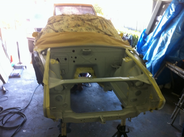

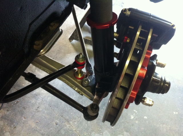

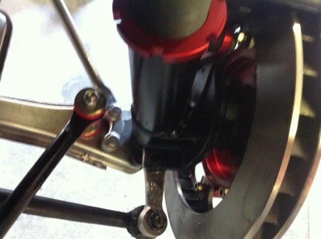

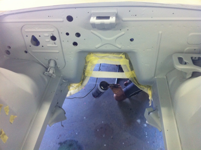

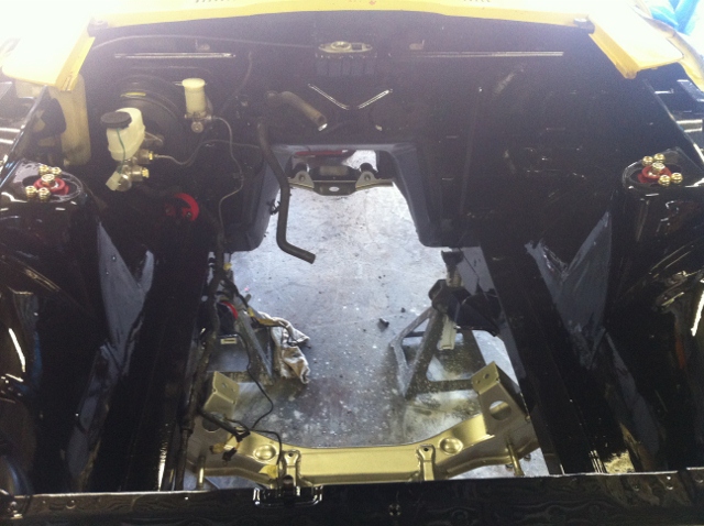

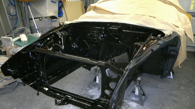

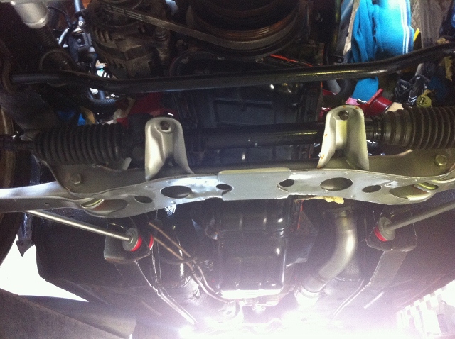

We replaced all bushes (which were red in colour), sprayed components such as cross member, control arms, diff, moustache bar silver and it was all coming along nicely and looking good. The engine bay and underside came out pretty neat so I was happy. I think from start of stripping car to this stage was about three weeks of after hours work.

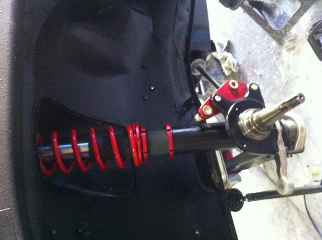

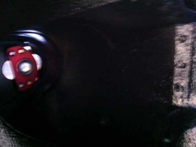

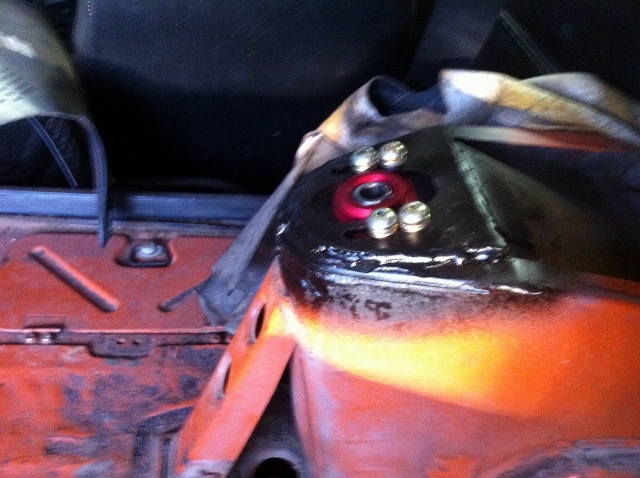

The above shot also shows camber plates cut and welded in before spraying. They almost look factory, and have good functionality. The suspesion is three way adjustmentable; camber, stiffness, height (has a large range aswell). Theyre designed basically for track and race along with the brakes, but I believe if your going to mod a car and especially increase the HP, then this is the first and most important area to upgrade - brakes and suspension.

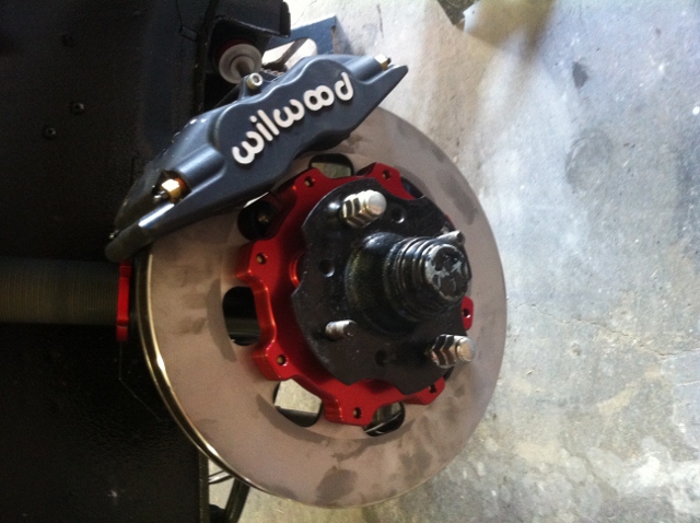

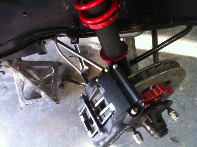

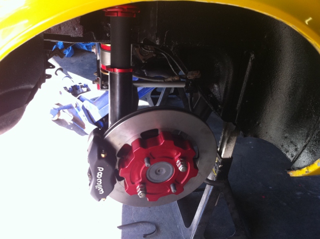

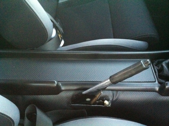

Finished in black and clear. Underneath is a matt style finsih thats had a protective layer to prevent rust and makes it easy to clean also. Brakes also went in no probs. Rears had to use Woz spot caliper kit for the handbrake, so massive thanks to him.  Before installing the driveline all new fluids were added, a timing belt, water pump, leads and a full service was done.
The brakes again from AZC are overkill but work so well and im my opinion worth the money. I just wanted a brand new "bolt on set" rather than using old nissan or toyota caliper and rotors etc. The downfall is lack of handbrake, but Woz's kit was adequate to satisfy my engineer and ACT registration inspectors at the pits. The larger MC and booster are required for this to work properly as well as install a proportioning valve to help decrease rear lockups as they bite hard with no weight in the rear end. After adjustment they dont lock up at all..

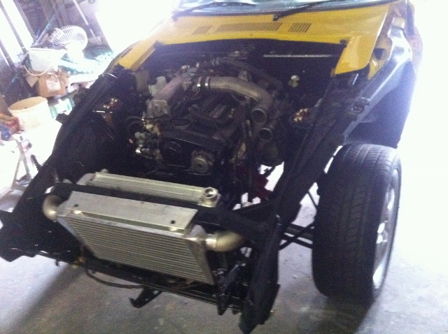

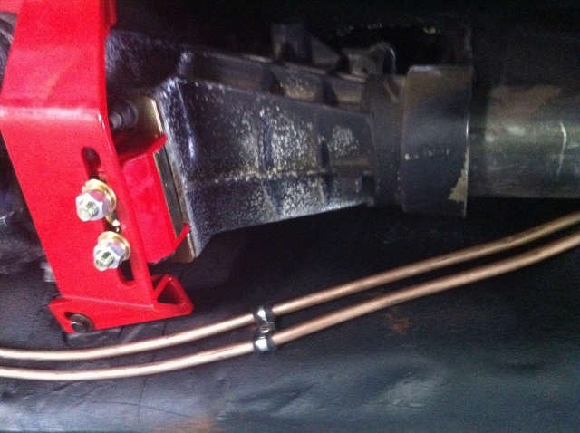

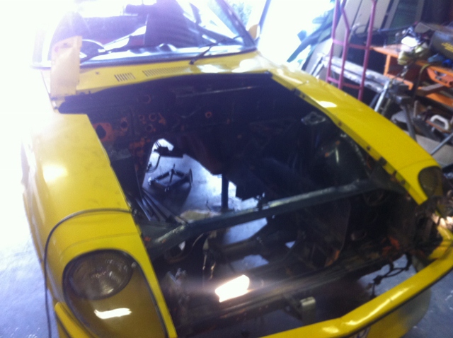

Next went in the engine and box, diff and tailshaft. As the r200 diff has a bulge on one side compared to the r180, we shortened a stub axle on the drivers side to give it a little more room to move, otherwise it was almost fully compressed and susceptable to breaking and without shortening will pull to the right under hard acceleration. Ive also got a CV uprade kit ready to go when needed. The build was coming along really well, with no hiccups or dramas halting progress. I thank the info on this site again for making it so smooth. And as they saying goes "if you fail to prepare, you prepare to fail" This is especially important when your paying someone to build the car for you. The easier to follow and more info you can throw their way when doing work like converisons etc will save you heaps in labour...
The Mckinney mount kit sat the engine about 4 cm off the firewall and low enough to give plenty of room between the bonnet and top of RB. The 200zr sump needed to be cut down and revolumed so about 5 cm was trimmed from the bowl and added to make it wider. The only bummer was the trans mount which allowed the rb25 box to sit in almost the position as the L series box was too close to the trans tunnel, making getting a speedo drive cable in next to impossible. A GPS speedo was aquired instead running straight off the autometre tacho + digital speedo. Other than that everything lined up nicely, the R33 pedal and cable from the half cut were used. The car had already been taken to the exhaust shop for a 3" mandle bent (with legal muffler for rego/engineering) to be fitted and have its cooler piping completed....  The cooler and radiator were also installed, once again the bolt on stuff designed for this swap making life easier from the start..

For the fuel system, all lines were replaced and upgraded. 3/8 lines were installed from engine to tank and back aswell as surge tank (1.5L) and electric lifter pump and bosch 044. Theyre mounted up behind diff near wheel arch. I orginally went a mechanical carter black lifter pump, but it was just too loud. The car fired up first time, and we took it for a spin around the block. It ran pretty well, I was stoked after about 5 months of building and waiting...ten years of ownership of the vehicle and almost 20 years of dreaming of doing this to a z.

So basically was now running RB25DET engine/box. R200 diff,new custom tailshaft, AZC coilovers + wilwood discs/calipers all round, front mount, new radiator, bushes. Essentially it felt like a new car. The suspension was harsh, but with adjustment softened it up to a comfortable yet firm level. It handles like a go kart when stiff though. The brakes were crazily good. And the best part was I doubled my HP while also bettering my fuel consumption. Went from 150HP to almost 300HP (with exh+fmc) and from 200miles per tank to now almost 300miles. The weight has gone from 1040kg to 1120kg (but that included bitumed inside, underneath and 2 packs of dynamat sound deading throughtout) - will post more about this later.

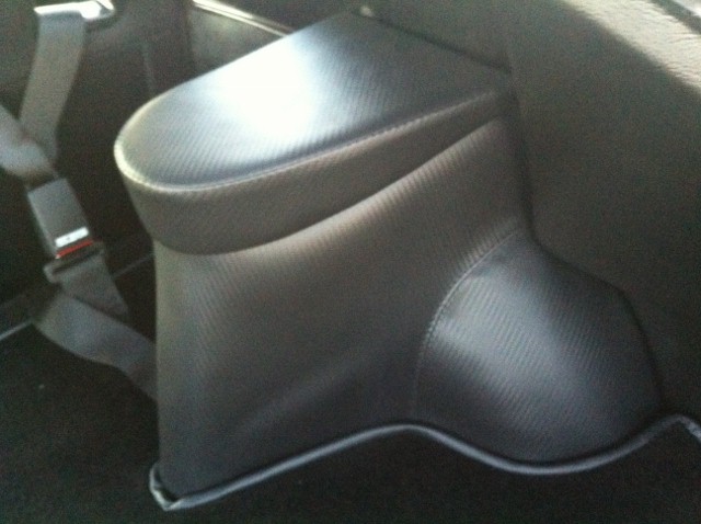

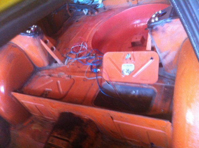

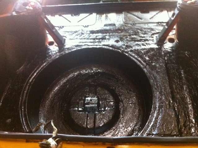

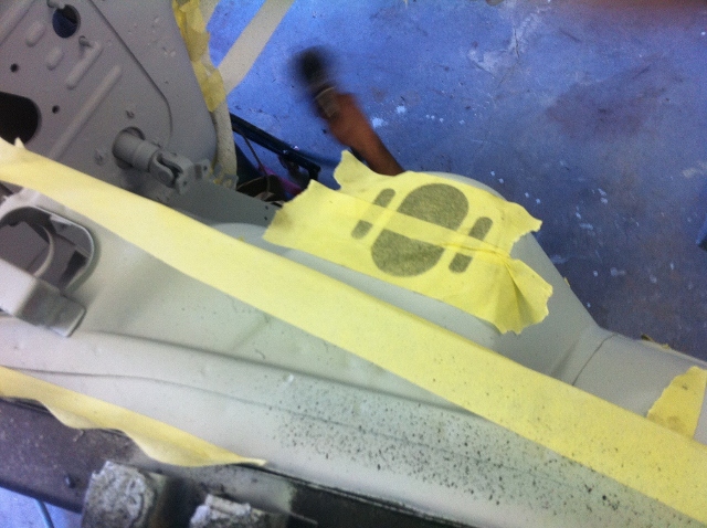

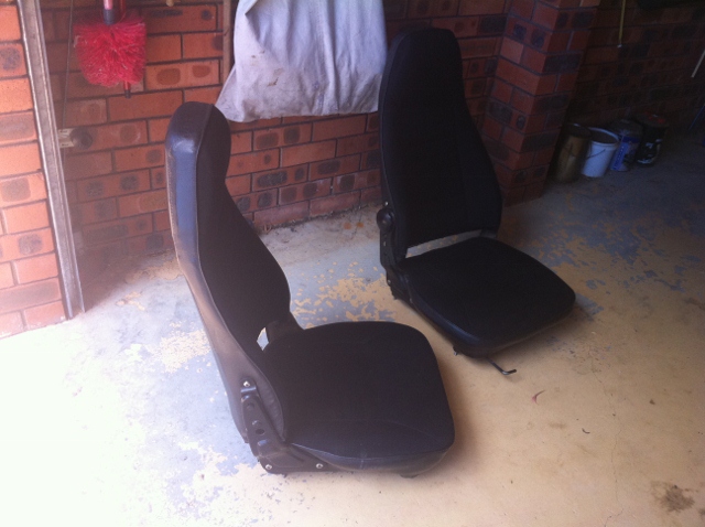

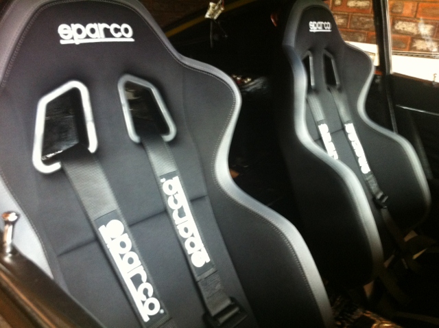

So Mechanically the car was sound, it was time to do something about the interior. Everything was stripped, including the dodgey old sound deadening. The hope was to continue the street/track theme with a set of Sparcos, 3 point harnesses, Sparco detachable wheel, new black carpets, carbon vinyl tunnel trim and rear wheen housing, plus respray all interor panels black and do the roof lining. I prepped the inside of the cabin with 4L of brush on bitumen (the spray can gives a neater yet much thinner finish,  and since it was being covered in dynamat + carpet, wanted the most effective sound deadening). Then picked up 2, 36sq metre packs of dynamat online (much cheaper)  and covered everything I could. Firewall, floors, rear end, wheel well, roof - everything inside except for doors. It came up well and definatley decreased road noise.
I ended up buying a stack of parts off Ebay USA for the styling and interior. NEW OEM stuff like dome lights, map light surround, new console face panel/ knobs/ heater core etc all were sourced from there. Highly reccomended. An order through MSA of a push botton start and weatherstrip kit was also place along with some carbon bits for the exterior.
Great work.  ;)  With the weld-in camber plates, how much harsher to drive on the street or do you think it's more spring rate/shock setting?
As the rear strut towers provide access to the camber plates and adjustment I didnt want to fully seal this off incase I neeed  to change settings. We instead made a cover to sit over the tower and look flush. When required it pops off and alterations can be made. Once all carpet was laid, it really really quietened things down inside.
Thanks Roberto. It was harsh with the hardest spring setting. Great cornering and response but bumps etc were not great on the road. Tolerable, but not enjoyable. We softened up to about "halfway" in settings and its significantly more comfortable. Dave at AZC sells 3 types of spring rates to go, I got the softest at 220lb, which is avised. I also run 17x7.5 245's so the ride loses a little comfort with that also.
