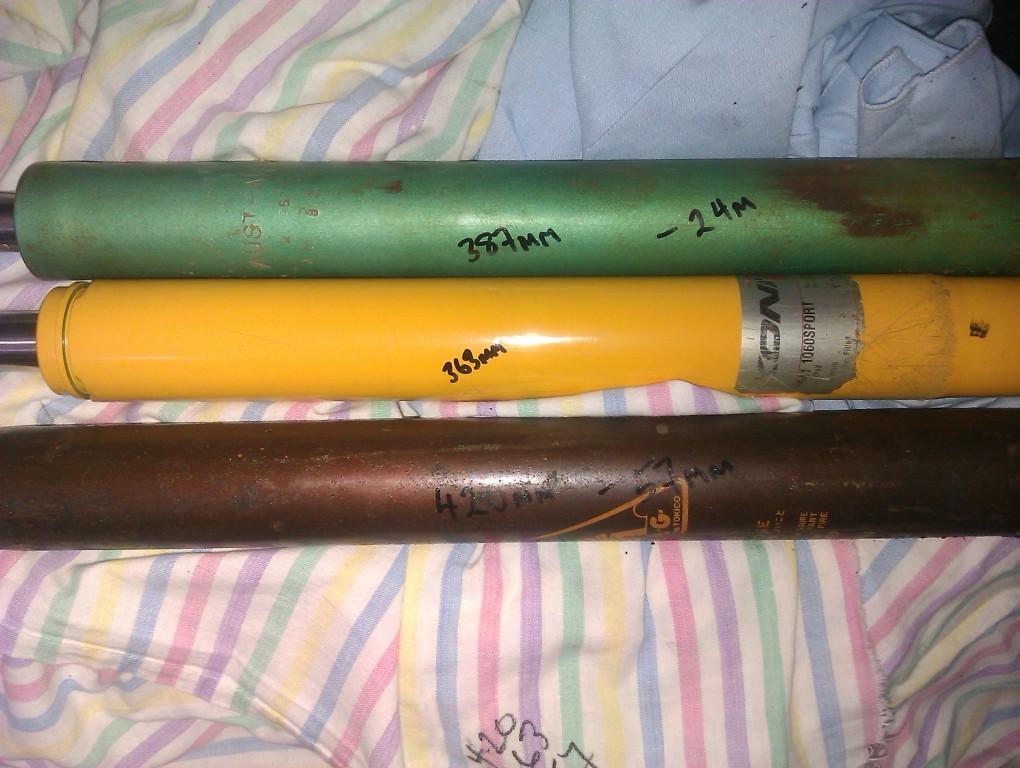

MaygZ Posted November 13, 2012 Posted November 13, 2012 Before I start cutting struts; the bodies of the Z31 inserts are 363mm; the old fronts are 387mm and the old rears are 420mm. My maths says fronts are 24mm longer and the rears are 57mm longer. My question - does that directly translate as sectioning 24mm out of the front struts and 57mm out of the rears? Will this make the rears too short? I don't have a weighted car (ie a full car) to lower onto them to measure. I was looking at putting the sleeves on 100mm from the ORIGINAL height top of the struts. Is this what has worked with others? Thanks guys Quote
C.A.R. Posted November 14, 2012 Posted November 14, 2012 Before I start cutting struts; the bodies of the Z31 inserts are 363mm; the old fronts are 387mm and the old rears are 420mm. My maths says fronts are 24mm longer and the rears are 57mm longer. My question - does that directly translate as sectioning 24mm out of the front struts and 57mm out of the rears? Will this make the rears too short? I don't have a weighted car (ie a full car) to lower onto them to measure. Take 24mm out of the fronts & 24mm out of the rears. If you take 57mm out of the rears, you'll end up with the arse of your Zed dragging on the ground - i.e. the ratio is not equal front to back. Don't forget to take into account the thickness of your cuts in the overall measurements. You'll need to pack the bottom of the rear inserts up inside the tube as well, (use an appropriate length packer) to make the insert sit hard against the gland nut. I was looking at putting the sleeves on 100mm from the ORIGINAL height top of the struts. Is this what has worked with others? Thanks guys 75mm for the front - 50mm to 75mm for the rear. 4 welds equally spaced apart top & bottom, 10-15mm long each. DON'T fully weld them on... Quote

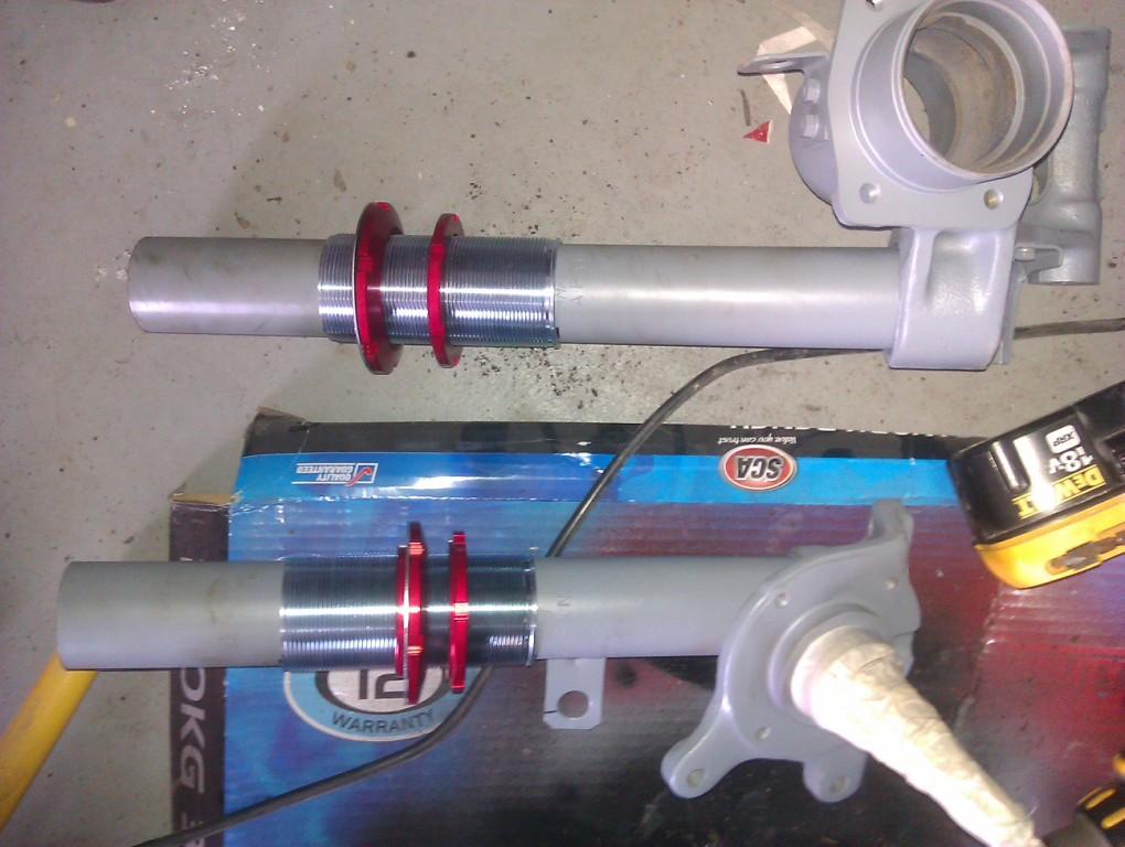

MaygZ Posted November 14, 2012 Author Posted November 14, 2012 75mm for the front - 50mm to 75mm for the rear. 4 welds equally spaced apart top & bottom, 10-15mm long each. DON'T fully weld them on... Thanks Lurchos. I'm thinking of coming for a drive for the sleeve welds - you've seen my welding and it aint getting much better :'( I've sectioined the fronts and I'm a little surprised at how easy they were - when you take your time. Quote
nat0_240_chevZ Posted November 16, 2012 Posted November 16, 2012 leave them full height, and dont worry about that loss in bump height, as if you are running much stiffer springs i doubt youll need the bump stob at all. use thos shock spacer rings ive shown in another thread, these pack up the cland nuts and also centr the strut cartride at the bottom if using 260z struts. Only reason sectioning has come about is because not many people can have the gland nut thread machined easilly into the top of the strut housing/tube, so cutting and welding appears to be the easiest option? apearantly.... I did not section, cut or weld a thing, and im using the same inserts, gland nuts & strut tubes/housings, only some carefully measured packers/spacers which make this whole assy so, so easy. You WILL get a few die hard peeps that say you need every once or inch of suspension travel, but this is crap, what your allowing your car to do is actually bottom out the tyre on something it was not designed to touch, ie inner guard, outer guard or other, the small (Very small) loss in travel does not effect handling, and unless your hitting spoon drains and speed humps at a million miles an hour, or plan to drive your Z off of platforms and gutters 1 foot high, DO NOT WORRY ABOUT IT. My expert opinion, others feel happy to flame, but lets just say, I think my designs and mods through completely before watching/following the americans, redneck version... not meaning to be sinicle, but its the only way sometimes. What you dont want to do is pack the insert/shock up, just pack above it so the gland nut holds it down, as you are trying to retain the same amount of 'drop/droop/max extension' without compromising where the stoke of the shock is attained, ie not at the bottom or top of the shockes range. any q's please search for an old thread of mine....... nat0 Quote
