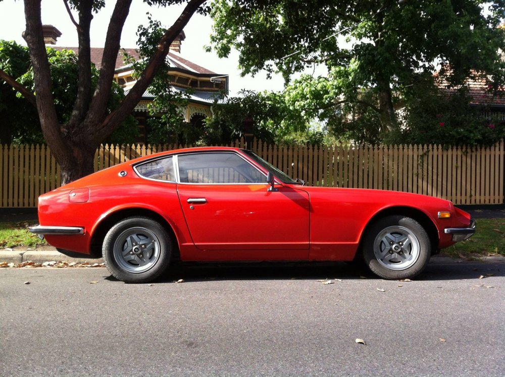

Herbonius Posted November 12, 2012 Author Posted November 12, 2012 My new car arrived last night! I couldn't be more happy with it! The body and interior are perfect and it handles like a go kart but with a ridiculous, monstrous, snarling engine under the hood. It's so silly and so awesome. Getting the RWC done today. Quote
luvemfast Posted November 12, 2012 Posted November 12, 2012 First things on the list should be get rid of those mirrors, change the mags and lower it and inch or two Awesome ride mate Quote
benny Posted November 12, 2012 Posted November 12, 2012 lower it and inch or four looks great man!! Quote

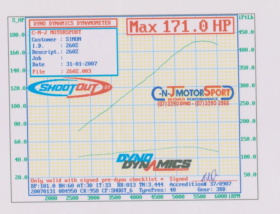

Herbonius Posted November 13, 2012 Author Posted November 13, 2012 Dyno results from after the rebuild and while the carbs were still good. Not bad for an L28. Quote

Gordo Posted November 13, 2012 Posted November 13, 2012 Looks like the dyno was done in third gear. That is not the norm, Quote
Herbonius Posted November 13, 2012 Author Posted November 13, 2012 Looks like the dyno was done in third gear. That is not the norm, Well, shows how much I know. Even for an auto? Quote

PZG302 Posted November 13, 2012 Posted November 13, 2012 Fo r an Auto of that age 3rd would be the norm as that is D for drive Quote
