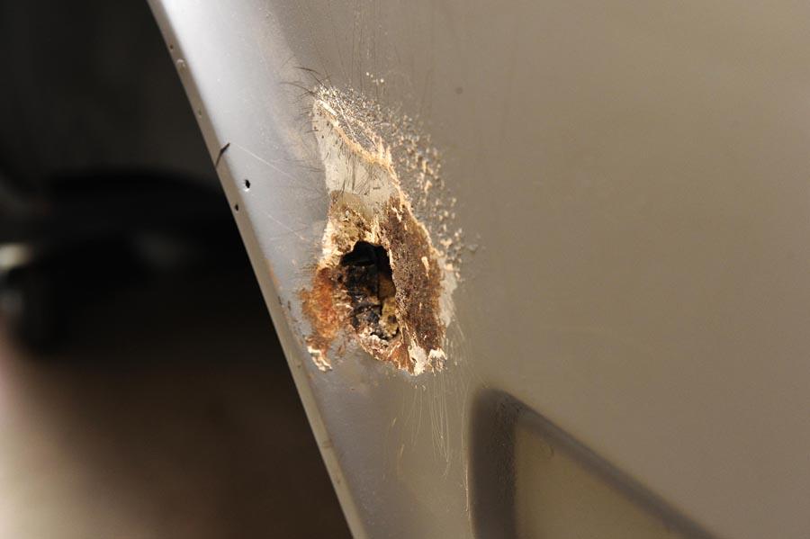

1. Rust, will need some advice on who can help me in Canberra. Want to get started ASAP.

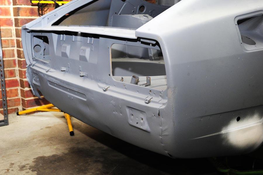

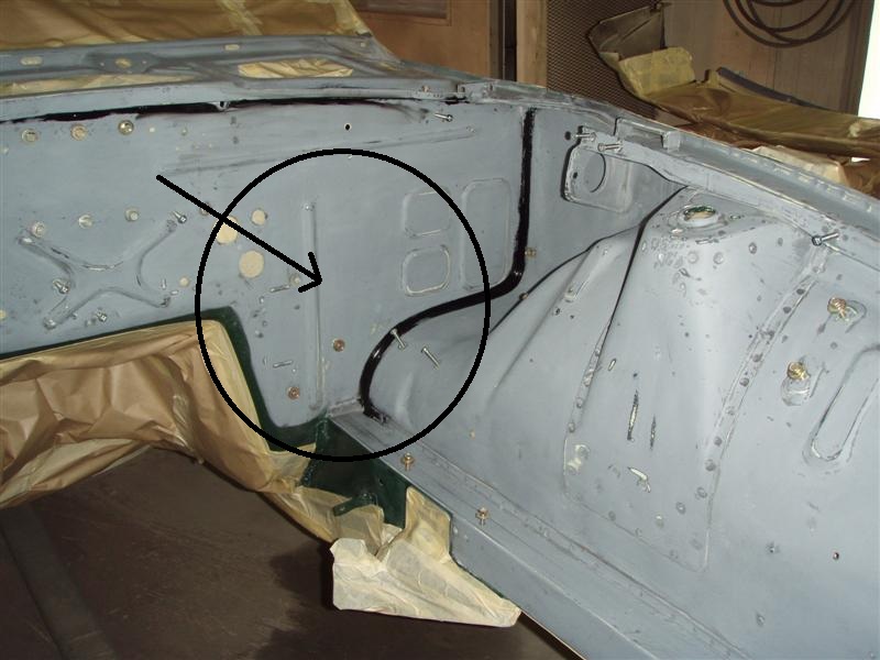

Hows the LHF rail, looks like its had a hit from the way the firewall and apron are creased?
Yep, had hit from the front. Those doglegs could come in handy, depends what the panel beater needs.

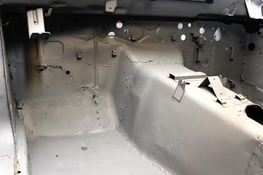

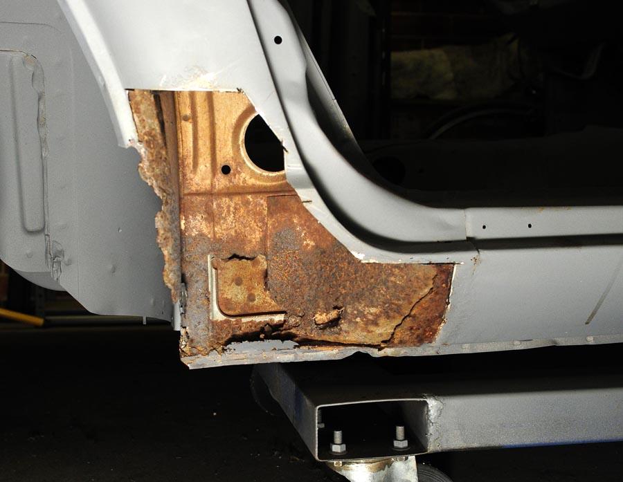

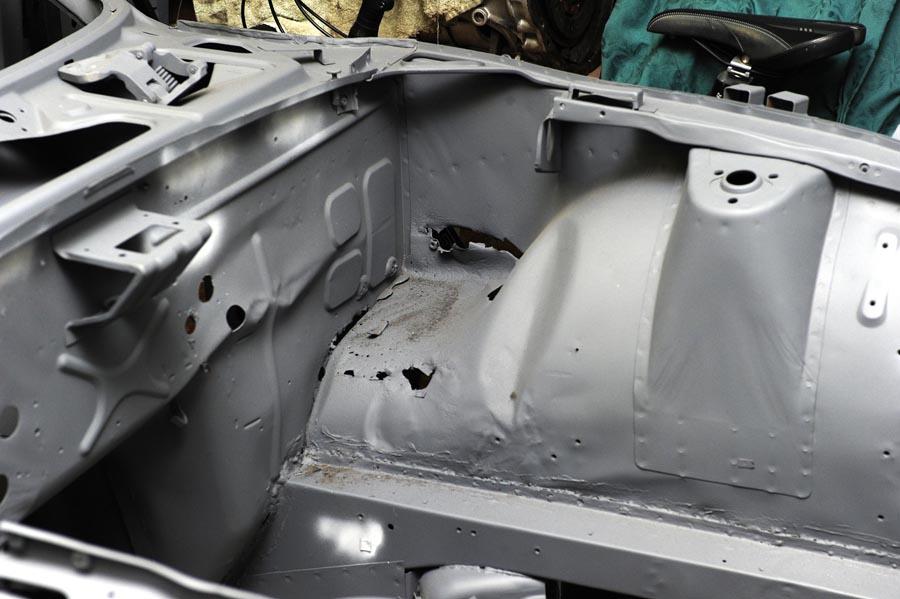

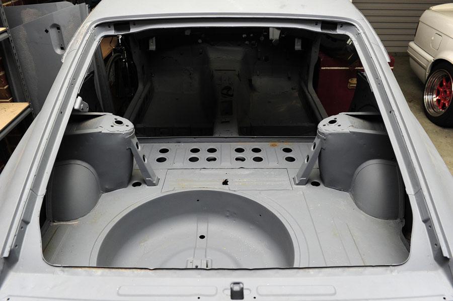

Mate, before doing any more purcahses on motor parts etc id bring that thing back to bear metal and really see what your delaing with. Its worrying the decay in the body is all over, not restricted to one area/region of the car.  Hopefully its just messy, but be careful not to invest too hard until you know your bodies going to be ok...
good luck with the build!!! add more pics as u go
Thanks mate, it has been taken back to bare metal. Just before I got it. Will look in to the build number.
Not sure if youve realised but there is a comprehensive build thread that the previous owner started on this zed. Im pretty sure it came from Ballarat and that there was a bit of discussion about how the front half differs in appearance from the rear( in years.) .Also It wasnt a lowish build number when I looked at it from memory.
like you said has some good bad and the ugly. But all fixable.

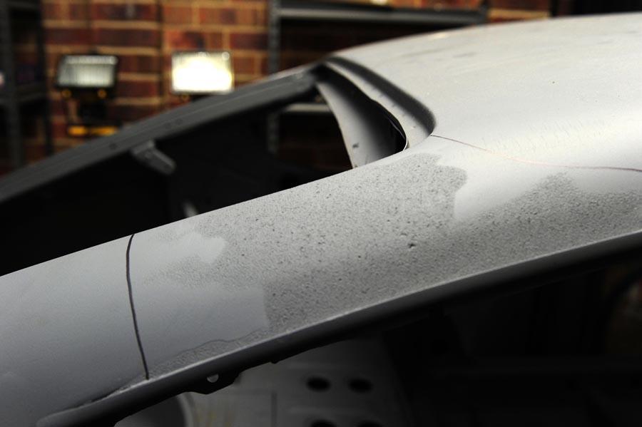

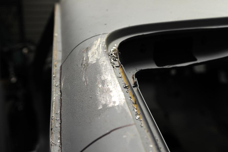

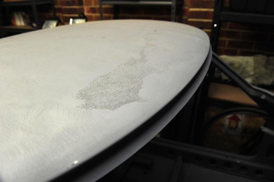

the area where roof and 1/4 panel meet where you have outlined. Its just lead fill done by the factory where two panels join so it nice and seamless.
also same thing is done around the the front at the top corners of the windscreen area where "A" pillar meets the roof skin.
If there is no signs of corrosion underneath or loose lead I wouldn't be concerned digging it out.
good luck with it and don't rush.

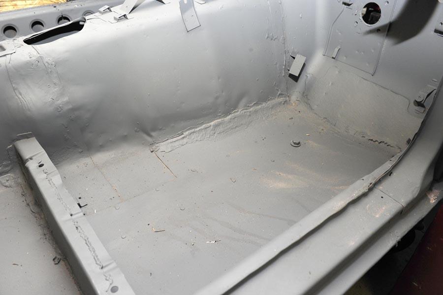

Looks like you have some work to do.
I would definitely recommend getting the crash shop to
put it on a rack and check the measurements.
That pic you have of the LH inner guard and battery box
area looks bad. The firewall behind that rail should be flat
not all folded under like it is.
Its no big deal and fixable but its easy to do it now.
Hate you to spend thousands on body etc to find
out it cant be wheel aligned cause it isn't square.

Here is a pic of another members car around the area behind the battery
box. You can see that is is straight compared to yours.
If your panel beater hasn't got the measurements for a Z
they are available on the net just do a search, Think they are on
a project on here as well .
Paul
