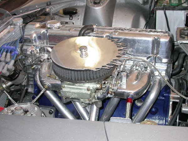

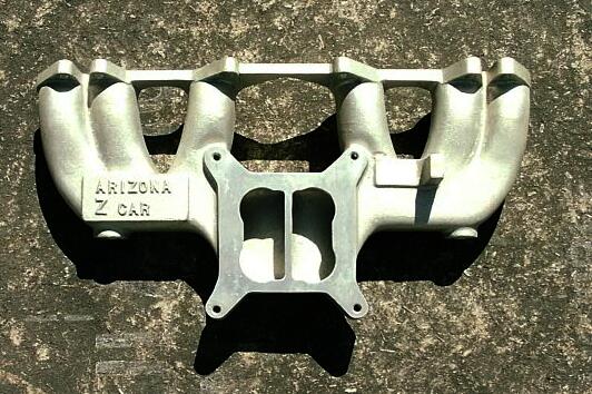

Enzo Posted June 15, 2007 Posted June 15, 2007 Hi Guys, hese Holley manifolds are available from Arizonazcars.com . These are a four barrel manifold using a 390 Holley. Small primaries for economy with larger secondaries for the extra get up and go. Quote
