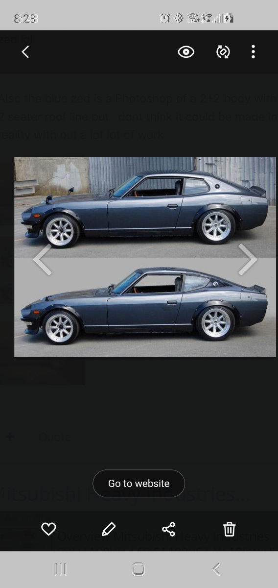

Nicopedia Posted January 7, 2023 Posted January 7, 2023 (edited) Hey mate the car looks great would changing the rear quarter windows add much more complexity? To look more like this I have sent you a message asking a few questions also Cheers Edited January 7, 2023 by Nicopedia To add a photo Quote
Zedback Posted January 9, 2023 Posted January 9, 2023 On 1/7/2023 at 9:24 PM, Nicopedia said: Hey mate the car looks great would changing the rear quarter windows add much more complexity? To look more like this I have sent you a message asking a few questions also Cheers Changing the rear quarter windows in any way becomes a much bigger job. You start messing with roof rails and reshaping the rear quarter inner and outer panels. all I’ve done is messed with the rear hatch hinge panel roof skin and the side frames of the hatch opening. I’m not after making it look like a 2 seater, just giving it a more sleek fastback appeal. Quote
