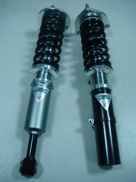

Agno Posted December 23, 2011 Posted December 23, 2011 A friend of mine has a Taiwanese company making some weld on coilovers for R31 skylines which are almost identical to the Ground Control front coilovers and could make for an easier conversion: I have a set in my car and they are pretty good and at $1300 it's not too expensive either. They have the same abilities to adjust camber, height and damper stiffness without removing them from the car like most conventional coilovers and you get to choose your spring rates. Considering S13 has the same front top hat PCD as R31 and R31s have 3 bolt rear top hats as well it might make for an easy swap if everything lines up (I don't know how similar S130 front suspension is to Z31 but I know that Z31 has the same top hat as R31) Quote

Agno Posted December 23, 2011 Posted December 23, 2011 Close but no. These coilovers you cut your original strut down and leave about an inch of tube, slide the new damper tube over the top and weld it to the base foot. Rather than grind brackets off an s13 coilover and machining the knuckle to fit the larger diameter tube. This means less machining needs to be done plus you aren't welding an oil/gas filled tube Edit: Scratch that had another look at the S13 coils. The option I suggested above just has the brackets already removed. If you are going new then I would say it's worth it but otherwise backyarding ftw Quote
