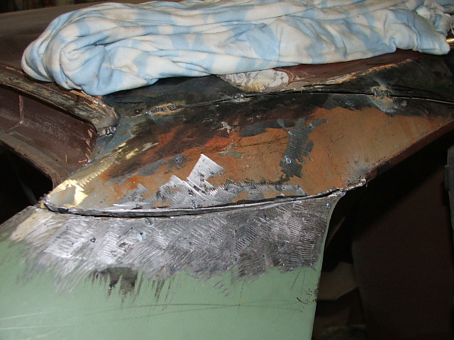

Linton Posted June 14, 2011 Posted June 14, 2011 ok Ihave had to cut some rust out of the roof right through the solder joint, what is the best way to put it back together dont think my solder iron is the answer :-\ Quote

Linton Posted June 14, 2011 Author Posted June 14, 2011 just checked the piece I took out it was welded and the joint then covered with lead, Should I weld a piece in behind the lead? not just fill in the gap worried it might crack if its not welded Quote
PeterAllen Posted June 15, 2011 Posted June 15, 2011 Absolutely weld it. I was just suggesting the lead to fill any large depressions. Quote

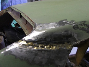

Linton Posted June 15, 2011 Author Posted June 15, 2011 thanks fellas I really appreciate the help, First I tried to solder it GRRRR it is lead solder wont stick, Stripped the lead out of the donor car formed it into a rod why didnt I think of that before.. S##t no luck all on the ground GRRRRR#### cleaned out all the lead back to bare metal, used the oxy and a bronze rod to join it back up. thanks for the great advice boy I was thinking this was going to be easy ;D Oh peter you were right butt joint not all that pretty but it is solid. Linton Quote

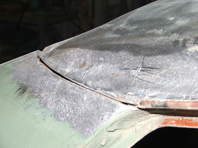

Linton Posted July 8, 2011 Author Posted July 8, 2011 thanks candy for that info, i will file it away for future reference. it all got too much I bronzed it up nice and solid. just need to prep the doors and finish off bonnet and guards which is mostly just a bit of bog here and there and I might be able to get a base coat of primer on and see how it looks, annnd just found some more rust damn.. when is it ever gonna end to bloody wet and cold to do anything out in the shed of late. Quote
