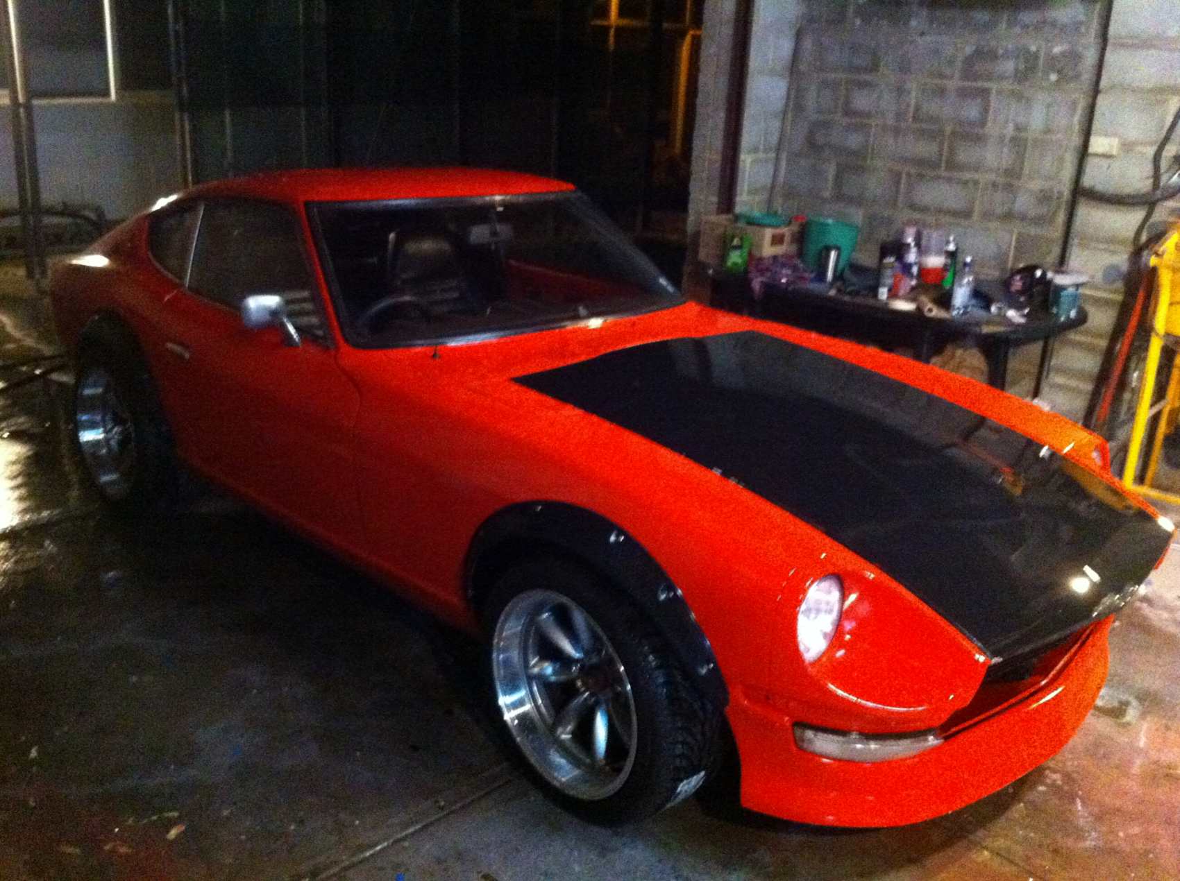

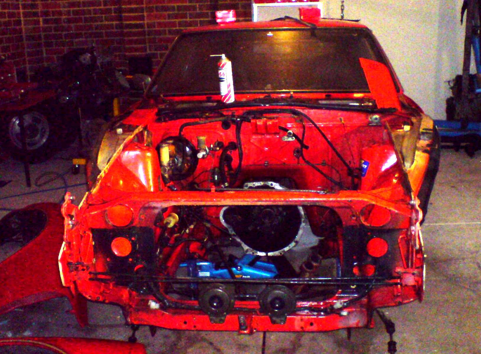

DeWit Posted May 9, 2011 Posted May 9, 2011 Hi All, I had spent about an hour writing an introduction, When my computer crashed and i lost my words for this thread. So now it will be the nutshell version. The current build time is 4.5 years and it has not been driven in this time. I decided to go the complete re build before i even began to modify it. The original engine was dead so i opted for a series 2 RB25det as a replacement. Fun idea at the time. With little knowledge on Zeds and Rb engines it was always going to be a challenge. And i was rite. They say good things come to those who wait, Wait i have, worked i have, Spent !! I've done lots of that. Everything on the car has been either re built, replaced or modified. Suspension is new, replaced with pedders shocks and swaybars to complement the king springs. Brakes have been done with the favoured hilux set up with rear disk brake conversion. All rubbers, bushes, ball joints, rack ends and everthing in the middle has been replaced. Way to much to write, but being a bit of a fabricator myself and my best friend the Auto elec we set to the task of putting in the RB25det. And all else that goes along with that, being Upgraded fuel system, Much easier to re fabricate the tank to take in internal pump then stuff around with surge tanks and the like. R200 viscous Diff, Custom tail shaft and CV shafts. And a few other bits and pieces, It is almost done. Will be going on the the engineer again in the next week or so once i get the car completely back together from the repaint. I look forward to meeting some fellow ZED owners at an event sometime soon.[/img] Quote
zzzzed Posted May 9, 2011 Posted May 9, 2011 very nice..How wide are your front rims? They look like 9.5" ?? Quote
handsandwhich Posted May 9, 2011 Posted May 9, 2011 Nice mate, it never ceases to amaze me the freakin size of the engine bays of the zeds. The bare engine looks tiny sitting in there. Quote
DeWit Posted May 9, 2011 Author Posted May 9, 2011 very nice..How wide are your front rims? They look like 9.5" ?? There 9" on the front and 9.5" on the rear. Have to put some stock wheels and tyres for engineering but. Pain in the a@&%. It is a massive engine bay, Intercooling pipework eats a bit of it up though. Quote

luvemfast Posted May 9, 2011 Posted May 9, 2011 Looks great. But think you need to invest in a better camera to do it justice. Why does the first have a red engine bay, then later pics have a silver one? Are you repainting it silver? or having a different coloured bay? Quote
DeWit Posted May 10, 2011 Author Posted May 10, 2011 Iphone cameras only produce a certain quality, thats for sure. When i get it out on the road ill be sure to take some better pics with the DSLR. The engine bay has been done silver to frame the engine a bit better. Make it pop, so to speak. its a bit of a shock to people that dont know what is under there when they see it. It will be worth all the effort in the long run, Then begins the real modification process. starting with coil overs and adjustable lower control arms, camber plate too most likely. For the moment i just want to enjoy in a bit though. It was last registered on the 4.6.01 so will be 10 years to the day for its first legal drive. ;D Quote
